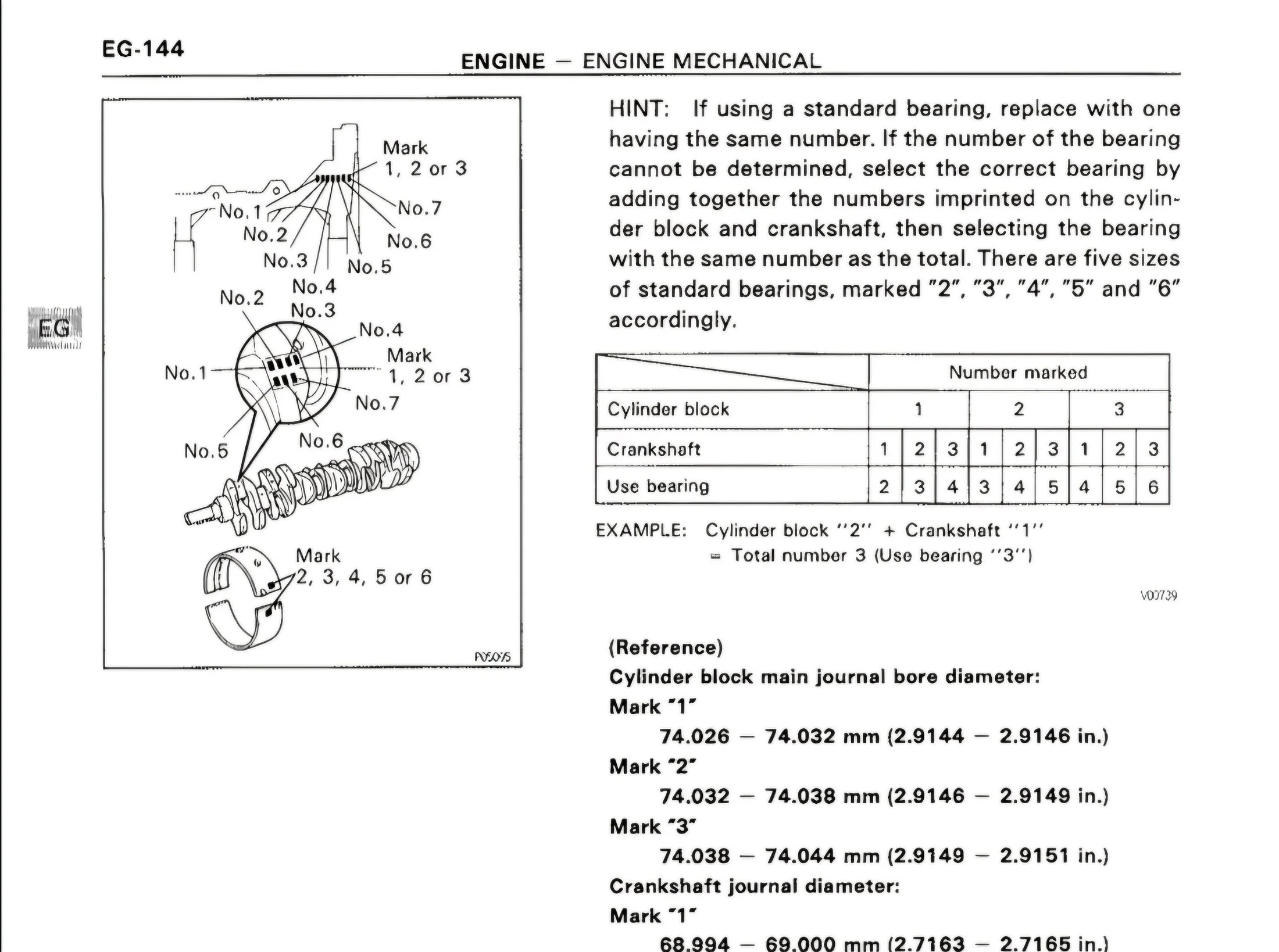

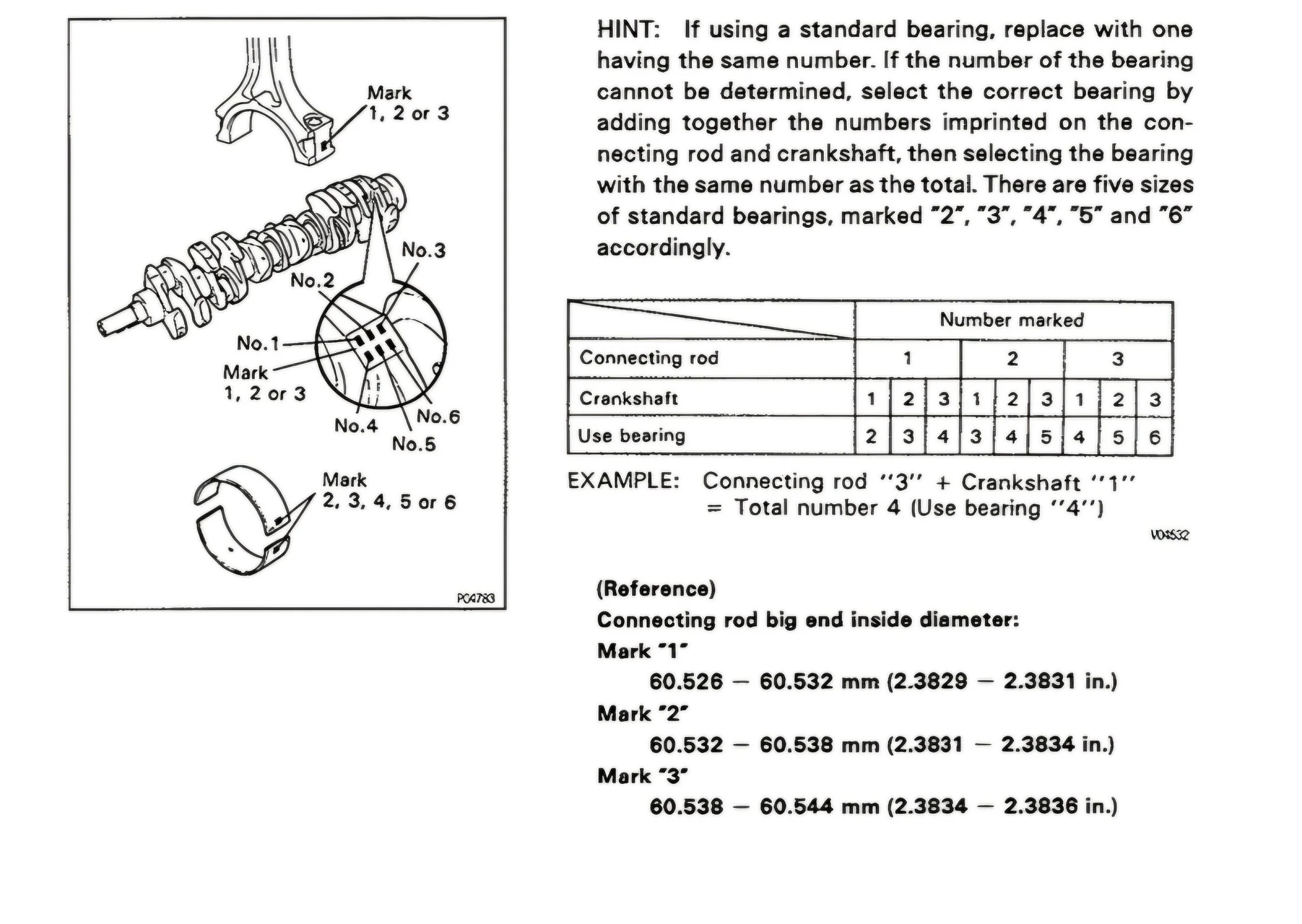

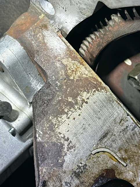

You need the numbers stamped on the crank and block as well.
The FSM has a little table. You combine the number on the crank, and the number on the rod, to see what size bearing is needed for each rod.
Same for main bearings. There's numbers stamped on the block, and on the crank.
I'n not sure you can rely on the numbers on the bearings themselves. I never found any info that clearly identified the bearing size by the numbers on any of mine
Crank has two lots of numbers stamped on it.
Rod journal size is in the rear of the crank.
Main bearing journal size is on the front end
Diagram also shows where main journal size is stamped on the bottom of the block. You may need to do some cleaning to find these.
Look at the crank real carefully and see if you have any punch stamped numbers like .010 or .020 on the crank beside the Toyota Numbers.
this will indicate it has been turned. If the crank has been turned, you will need the bearing to match that. Which Toyota does sell bearings to match a turned crank. If you want good aftermarket bearings, then you can not go wrong with Taiho bearings. Made in Japan great quailty. Just remeber to get the thrust bearing as well.

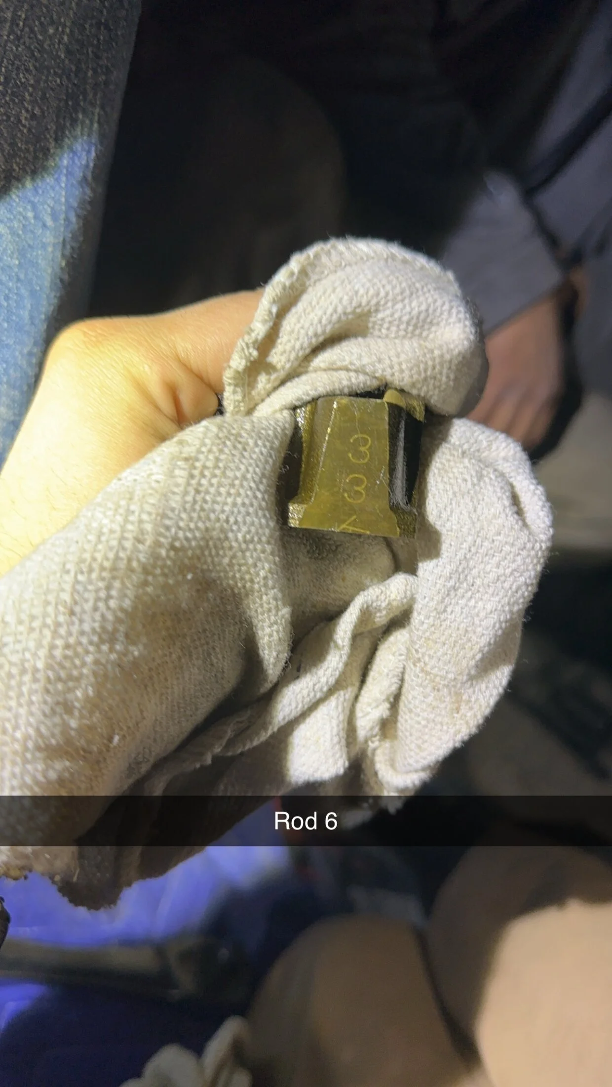

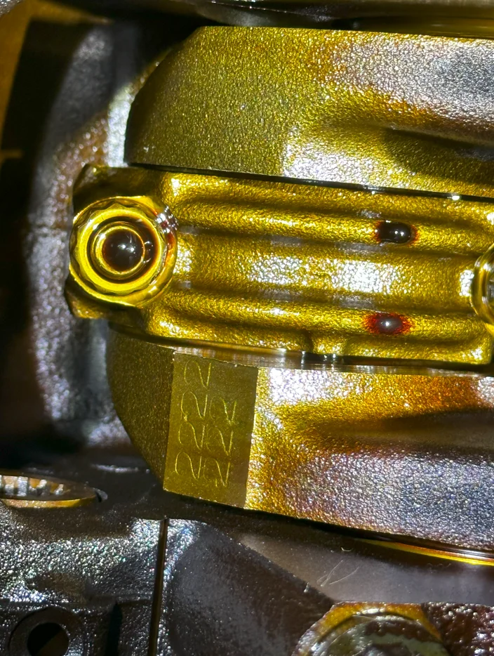

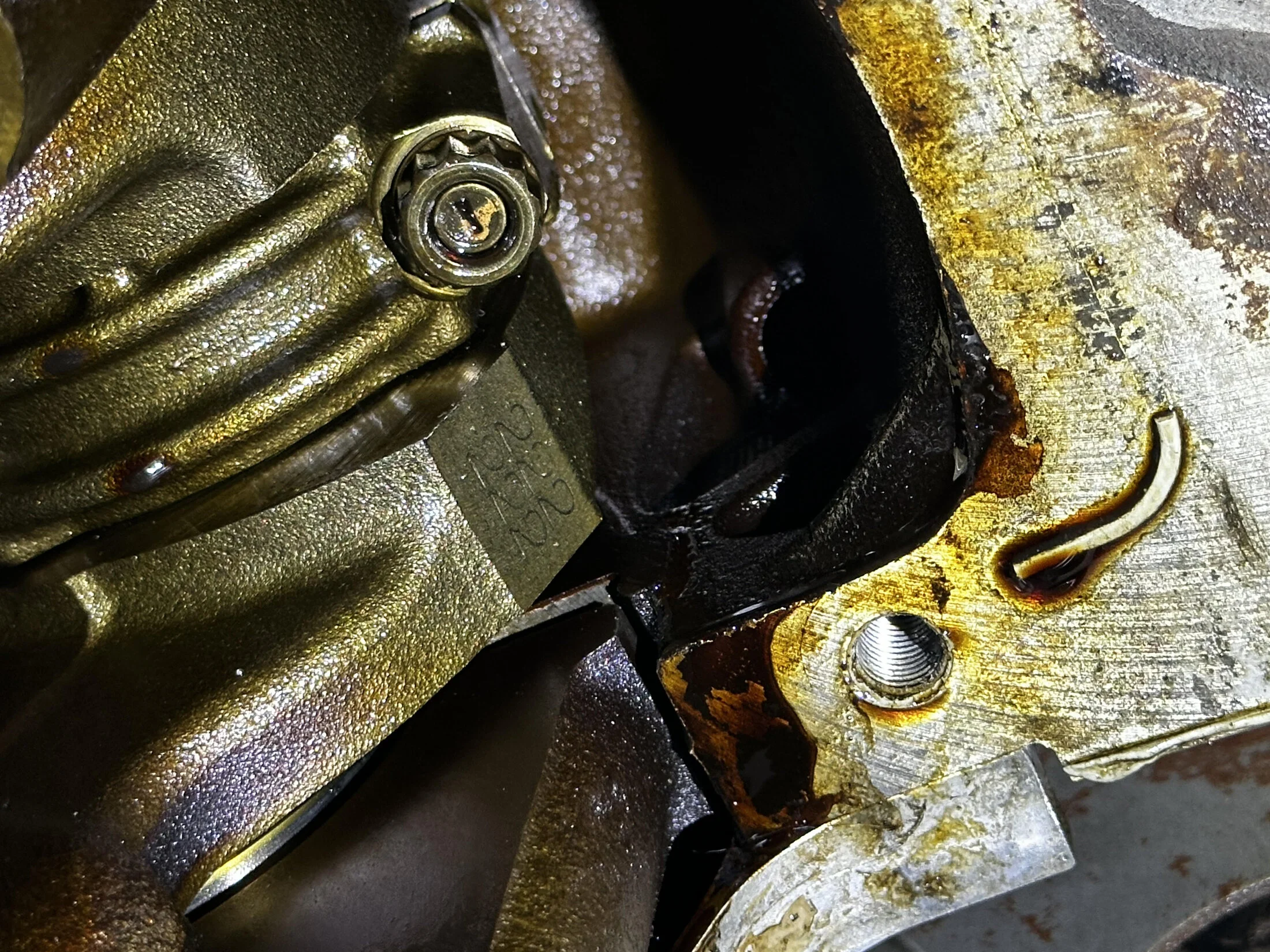

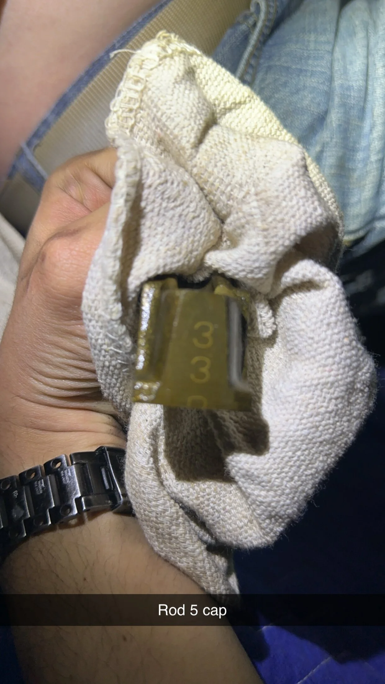

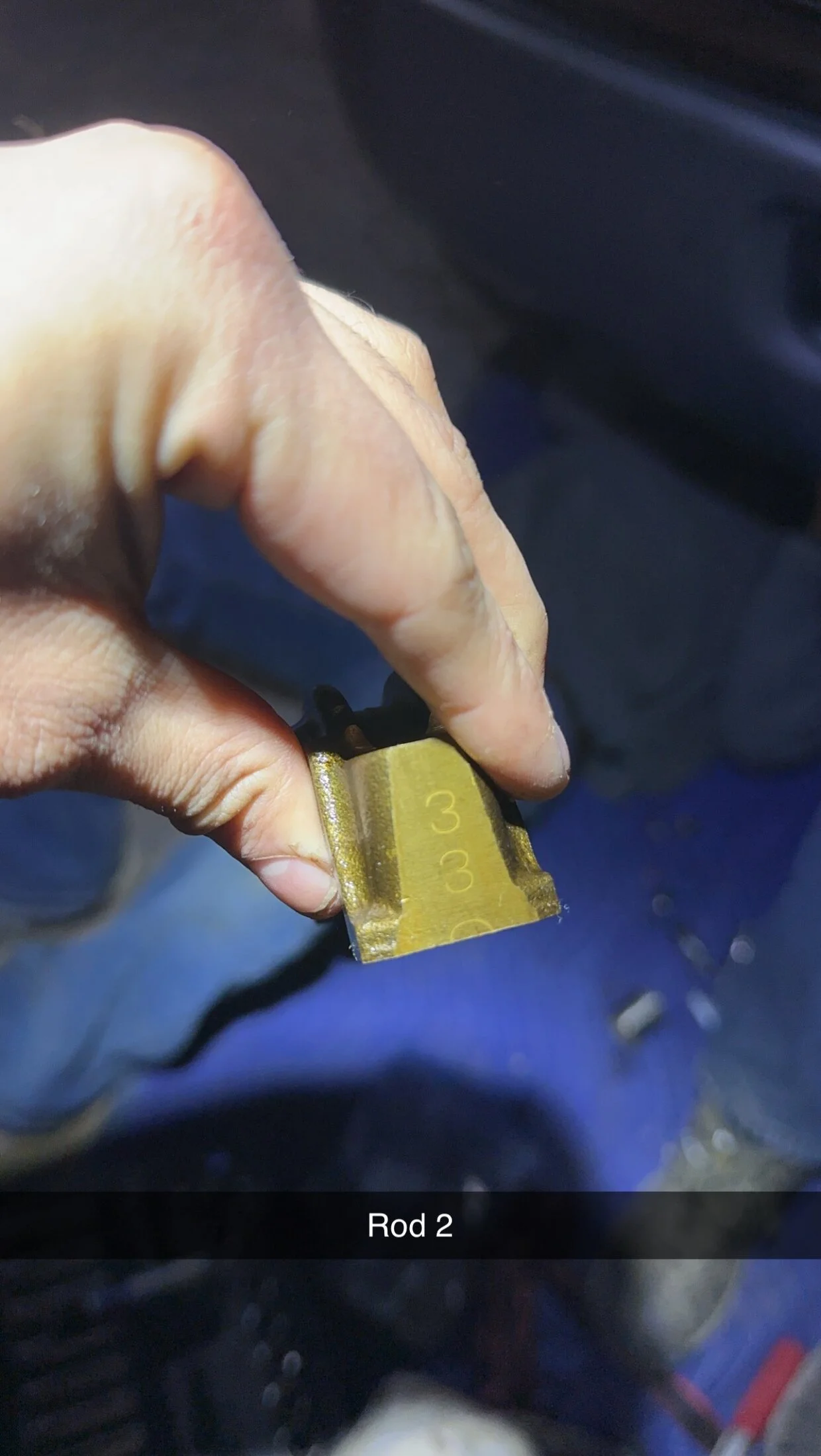

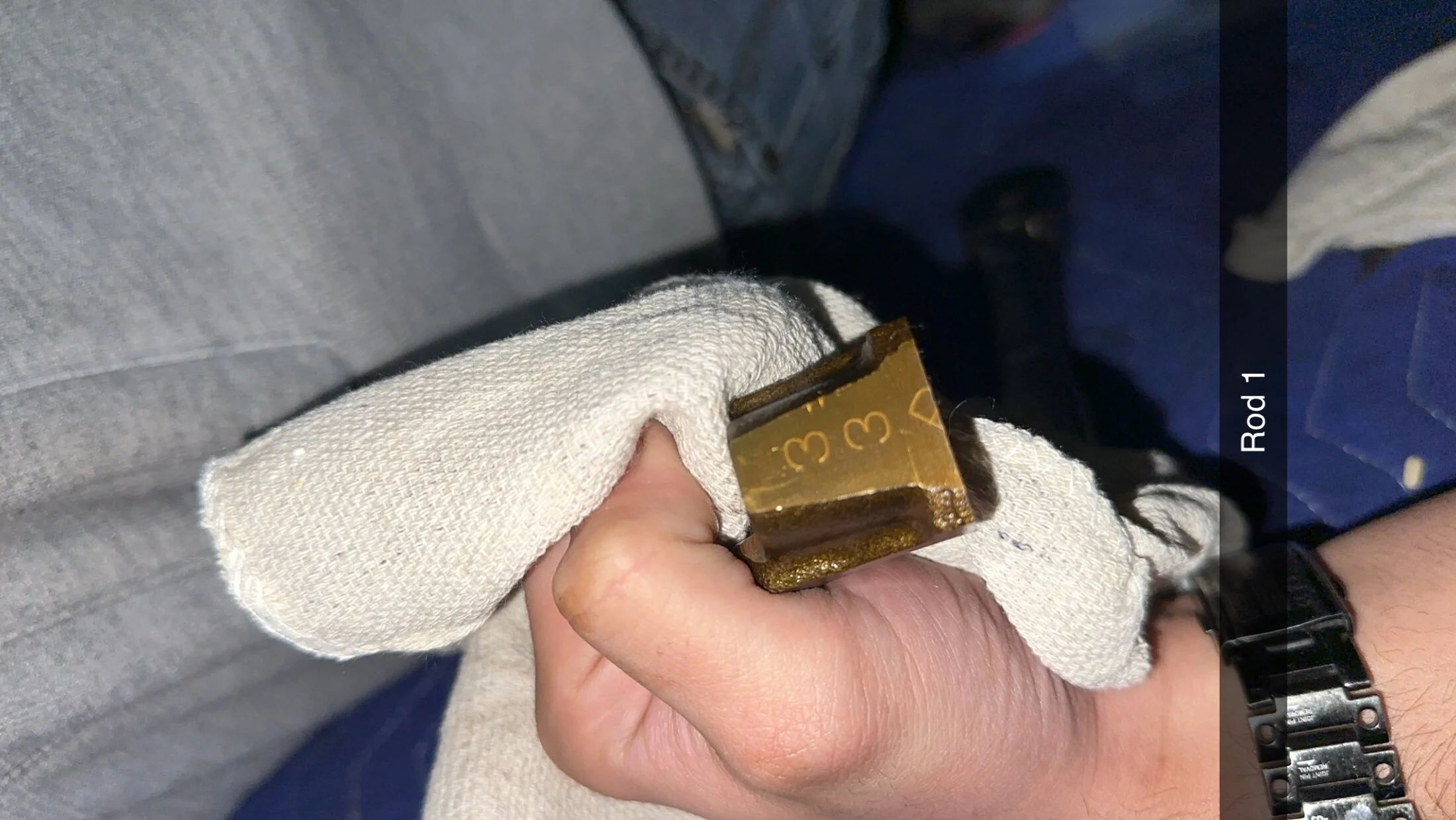

Alirght. I think that makes sense. For example, rod 2 would be bearing 5? Actually all the rods at the side of the cap, they say 3. So all of them would be bearing 5? Crankshaft say 2, and block say to so i should be good ordering #4 mains right?
