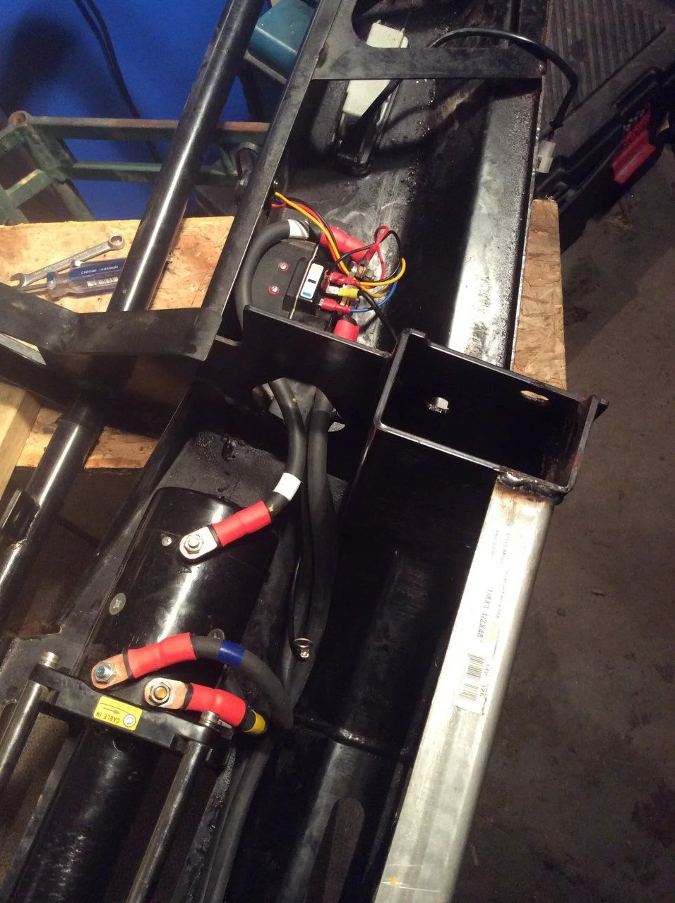

Don't know what your control box looks like, but I mounted mine inside the bumper. I just tacked in a small "L" shaped brkt that I bent in my vise.

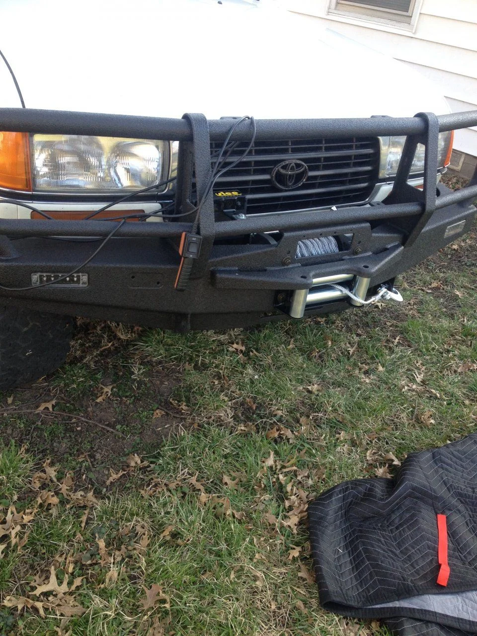

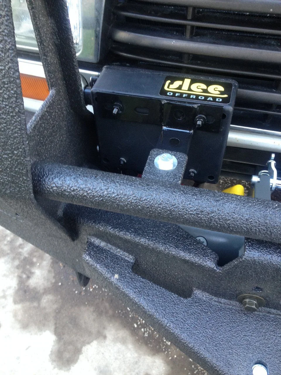

This works well for my ARB. Keeps everything low and out of the way but also allows you easy access to the pendant connection for the controller. I looked at mounting inside the bumper but didn't want to have to get down on the ground every time I was ready to hook it up. This will also allow you to add lights to the middle bar since the mount goes underneath the tab.
half k - is that bracket something you fabricated? i really like the location as being easy to get to, but i'm afraid the zeon control box will be a fair amount bigger. hopefully it will get here in a few days so i can see what i'm working with.
