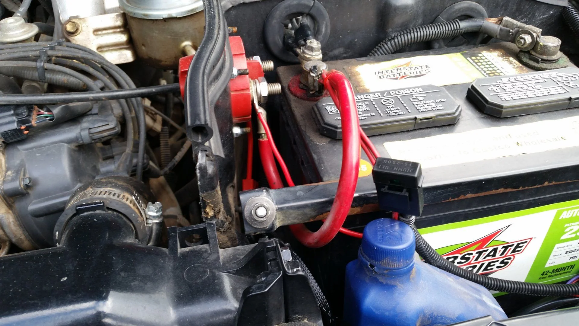

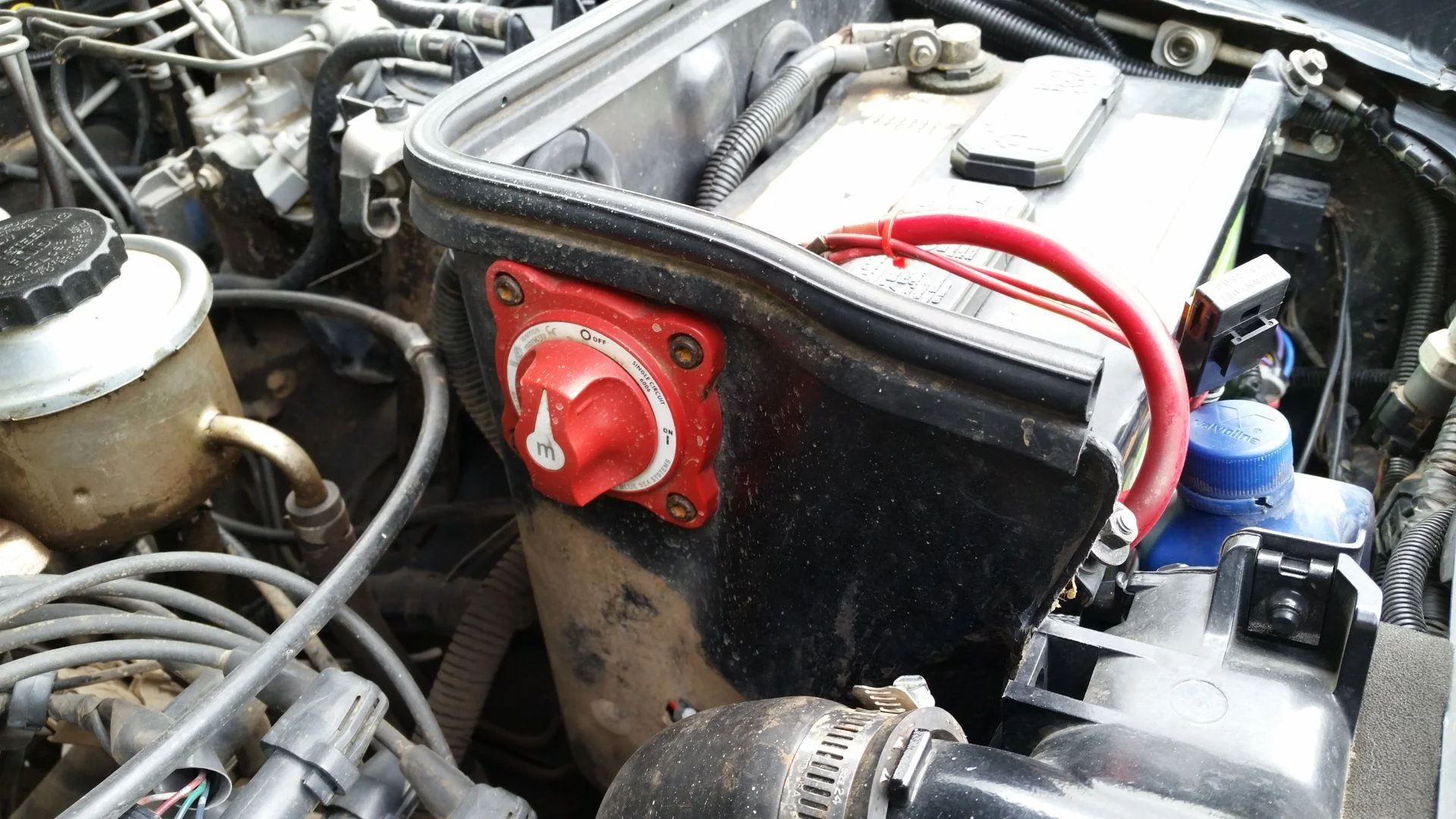

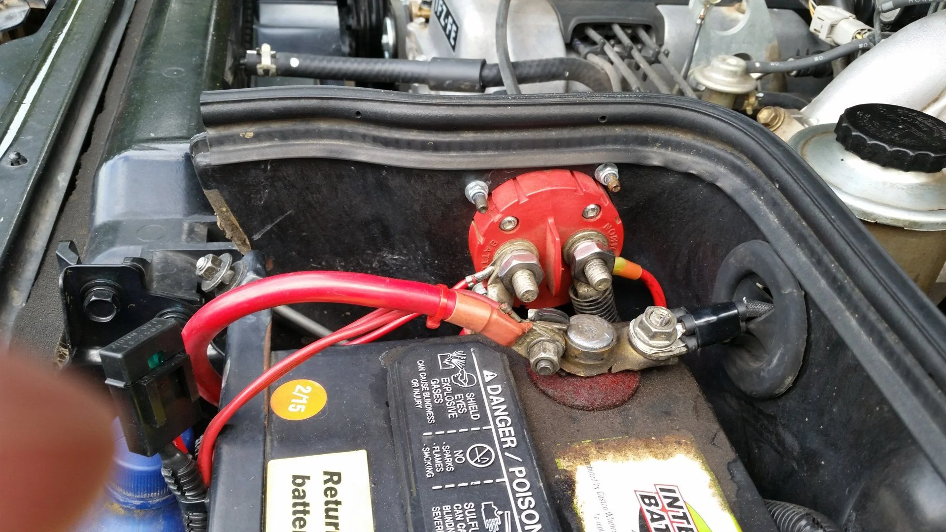

Pics show where I mounted a Blue Sea 6006 single-circuit disconnect for my winch and OBA clutch. Did this 7 years ago...have had no regrets about the switch location, or function (smooth, flawless). Not sure if the 6006 is dimensionally similar to the 9001 switch, but there's plenty of wall space on the battery box.
Thanks that's exactly what I had in mind.

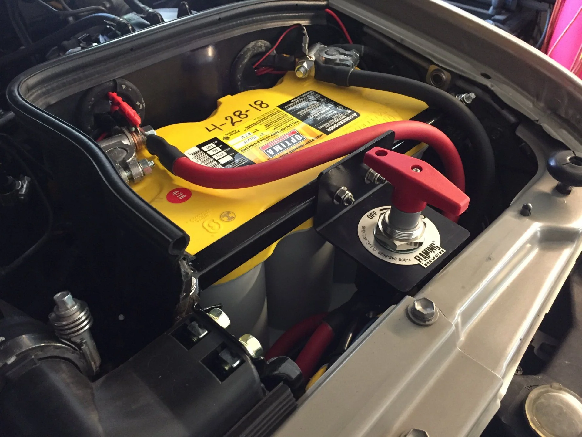

I went this route...flaming river 500amp
