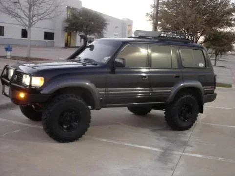

I can't remember who's truck this is, but it gives me an idea of what mine would look like.
Nice job!
I am going to do this soon too. I am also debating between matt black and this color. My rig is black and will put new 33's on. I think black will be looks good with 35's since I remember people said it will make your tires look smaller.
Interesting, I guess I haven't seen a lot of blacked out rims to notice if it makes the tires look smaller. I thought it might make them look a bit bigger since the rim/tire boundaries are less pronounced with black wheels.
