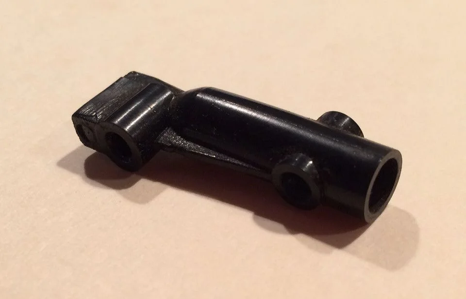

So I was planning on replacing the passenger door speaker because I thought it was blown due to serious vibration when the bass plays. So I open it up and the speaker was fine it was something else buzzing when the bass played. I pulled down the plastic and found the sound coming from up near the door lock and door handle. I couldn't find any loose parts and all the bolts were tight. I did find this part stuck between the lock motor and the lock housing. It wasn't attached to anything, just wedged between two housings. Its soft rubber almost 1.5" long.
So what does it go to? Could it have fallen off something that is now the source of the bass vibration?

It's part of the door lock actuator assembly. I'd be surprised if it is at all related to the woofer rattling.
What function does it serve in the actuator assembly? Do you have any pictures of where it goes so I can reinstall it if it needs to be there. I have the service manual but it doesn't show this part in the lock assembly.
The woofer isn't rattling, something in the door handle or lock assembly is vibrating when the low notes are thumping (sounds like a blown speaker but its definitely coming from the lock or handle). I'm hoping that this part is supposed to be on whatever it is that's vibrating and that it won't vibrate once I get this part back where its supposed to be.
Here is a stock photo of one (with a blue dot on the part). It just plugs into the side of the assembly, and is easily dislodged. I really don't know what purpose it serves. I've left them out of a few actuator repairs I've done, with no new rattles resulting.

Awesome. Thanks for the pic. I know where it goes. When I get back in there I'll put it back on. Any ideas on what I could look for as another source of the vibration?
