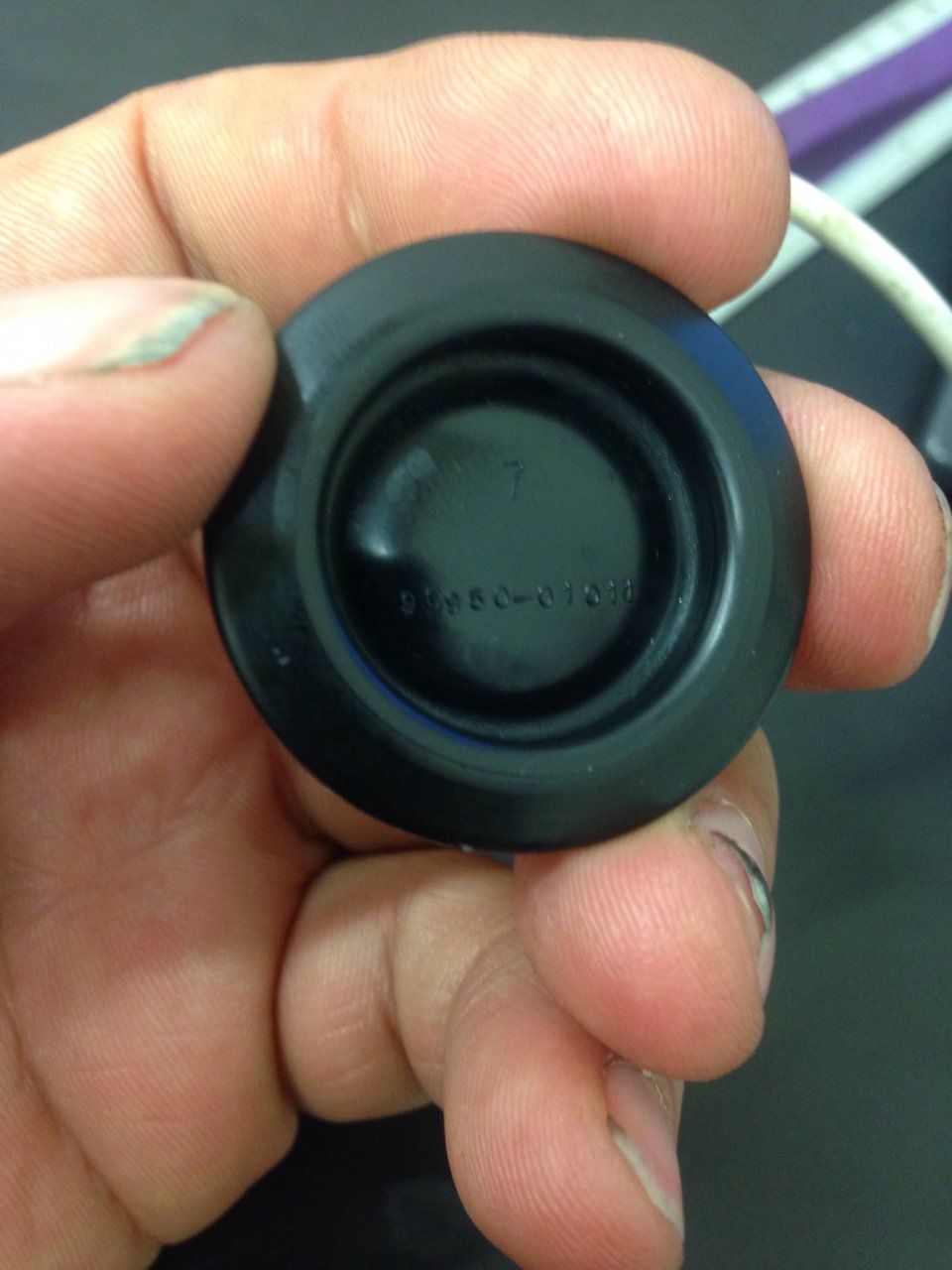

These are the correct sized plugs if you delete the rear heater from under your passenger front seat.
They fit from inside the can as well as from below. About 25.5mm in diameter.

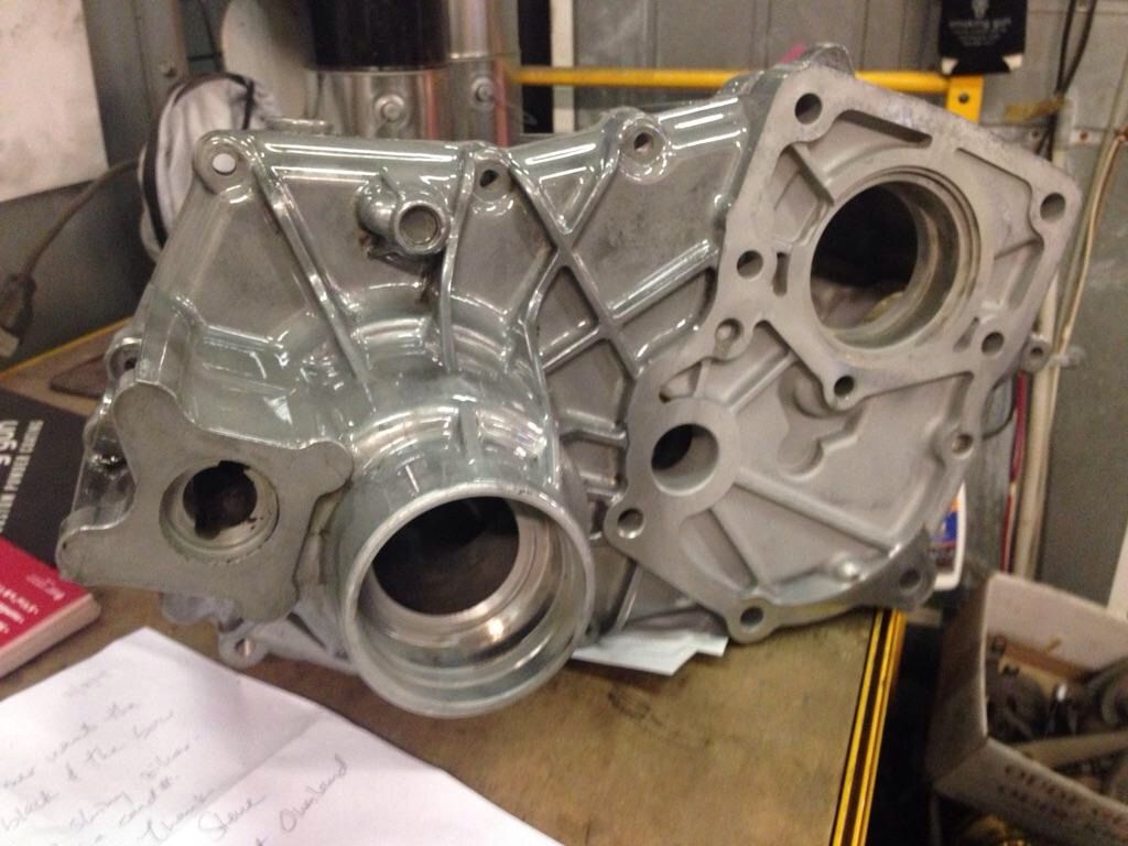

Also got a few pics of a newly powdercoatrd and drying split case from Smoking Gun powder coating in Decatur.
Looking awesome.
Bearing from Georg arrived as did the new idler shaft and some other knick knacks for the split case.
Plan is to assemble into the H55F on Friday.
:cheers:
Why the PC on the T-case? Is it just clear?
Looks like it to me!
Looks great with the clear PC!!! You'll really, really like how well it cleans up as it gets dirty in the future.
