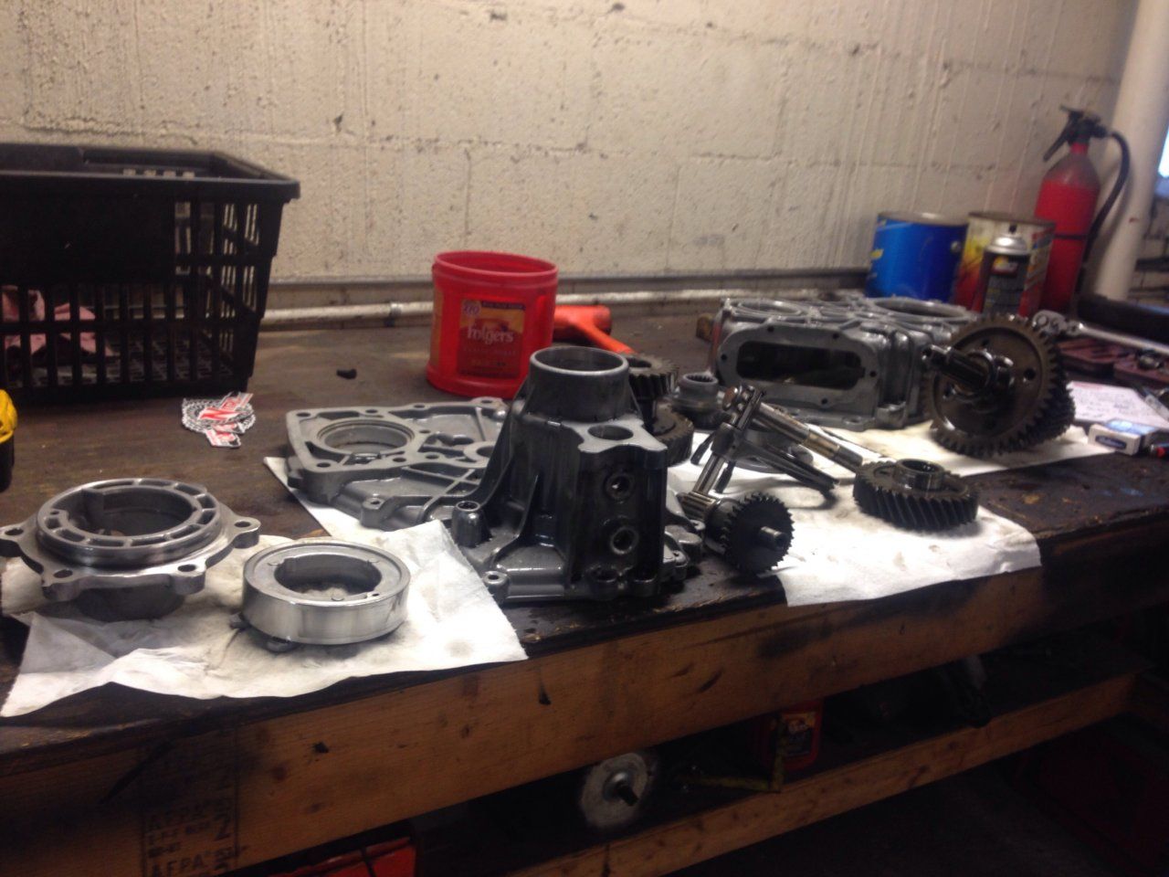

ACC was nice enough to let me use a bit of their shop space and Michael showed me the ins and outs of the split case.
Disassembly and cleaning occurred today. I am waiting on bearings from Georg. Also idler shaft showed wear so I decided on a new one.
Everything else looked really good for a 300k miles unit.

All torn down.
All cleaned and sand blasted.
The whole thing in pieces.....
