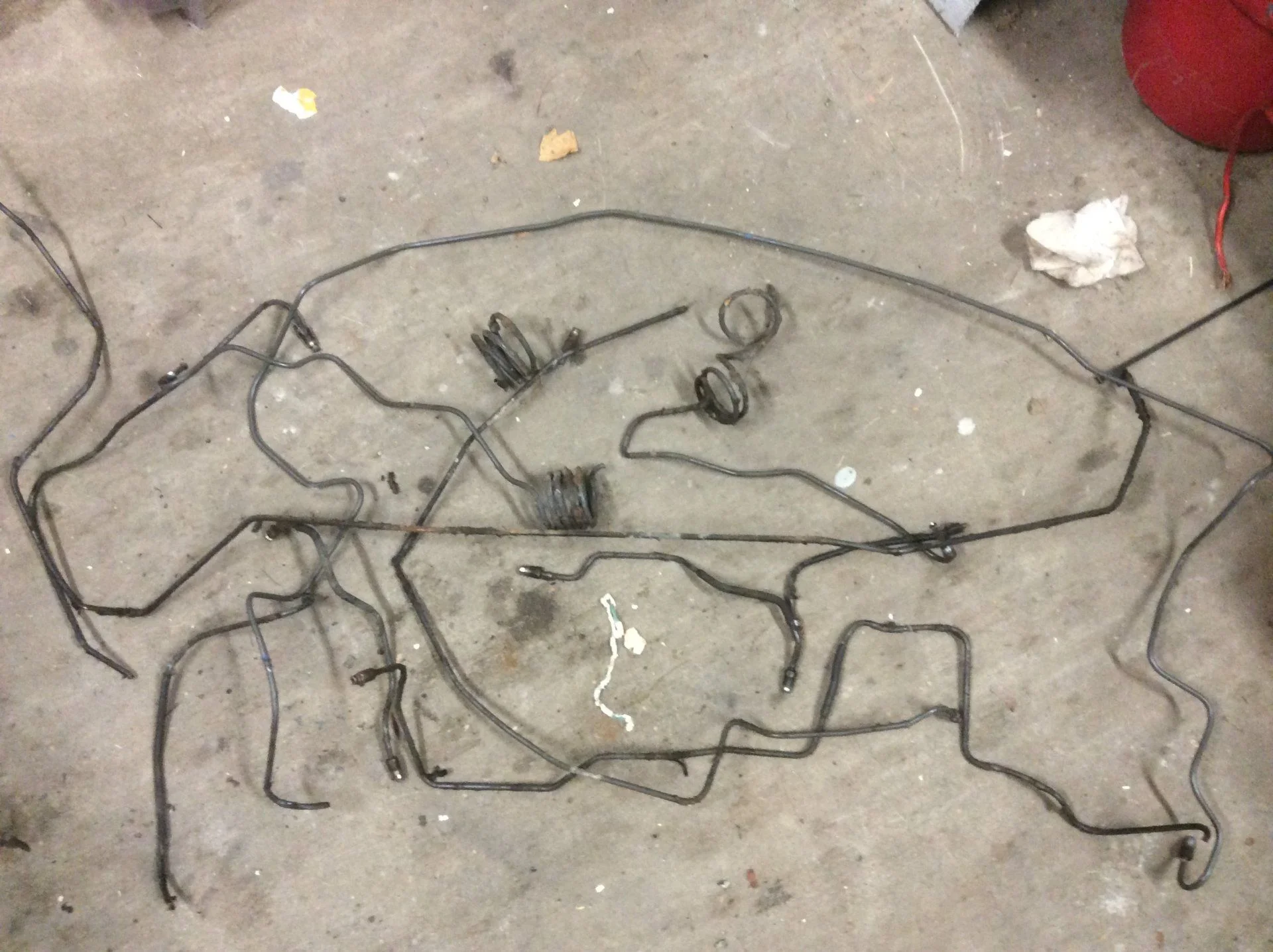

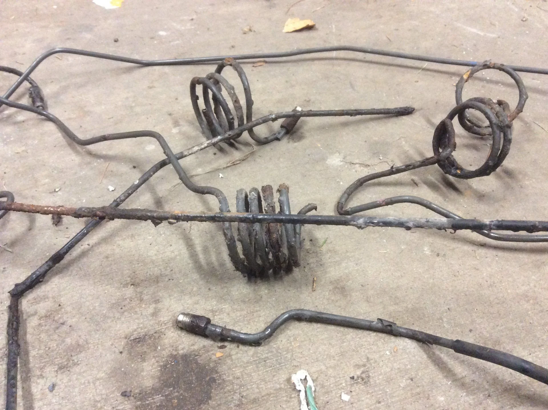

Drove it to town and ran a lot of errands today, no issues. Ran another scan with laptop, no trouble codes at all. I’m gonna say it’s good to go. Now let’s see if I can attach some pics of the brake line pile. I can’t get a good shot of the actual blowout, since that line tore out when I removed it, as well as many others, and I’m not sure which is which.
Drove it to town and ran a lot of errands today, no issues. Ran another scan with laptop, no trouble codes at all. I’m gonna say it’s good to go. Now let’s see if I can attach some pics of the brake line pile. I can’t get a good shot of the actual blowout, since that line tore out when I removed it, as well as many others, and I’m not sure which is which.View attachment 2161704View attachment 2161707View attachment 2161708View attachment 2161709
Wow...those actually look worse than mine that all just got replaced. One of mine started leaking when I gently removed the frame mount clip...so I can imagine you were in pretty bad shape.
The lines on my ‘92 miata were way worse, basically no paint on them and just entirely rust. But they never leaked, for some reason. I only got a good look at them when I cut the car up for parts, as the frame rails and rockers on unibody were completely rusted through. Ohio is fun!
