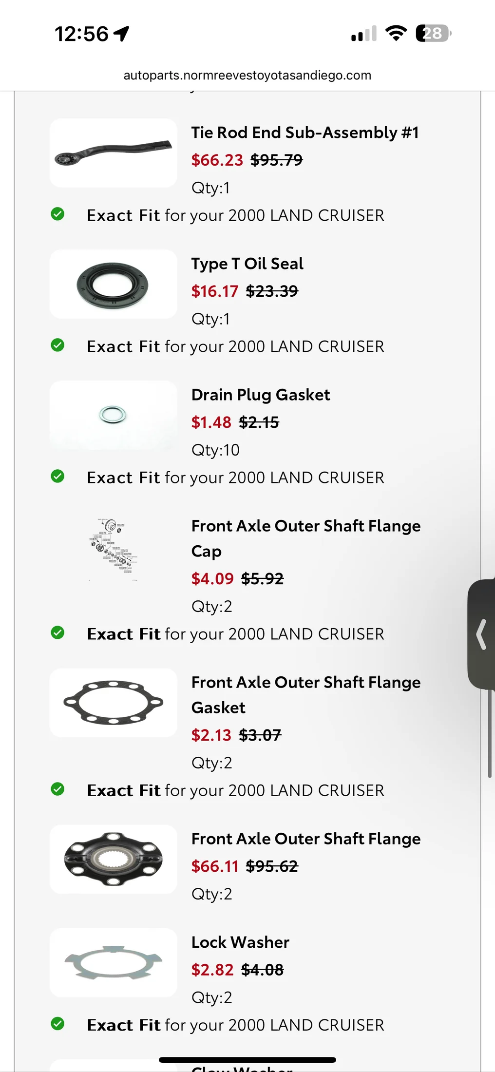

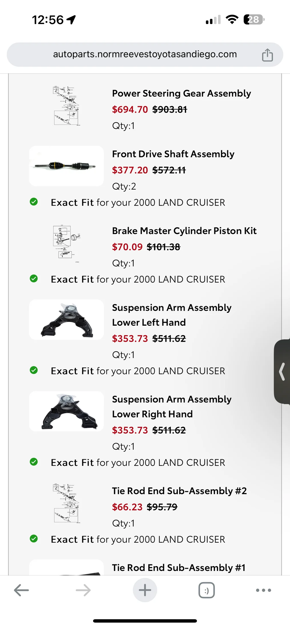

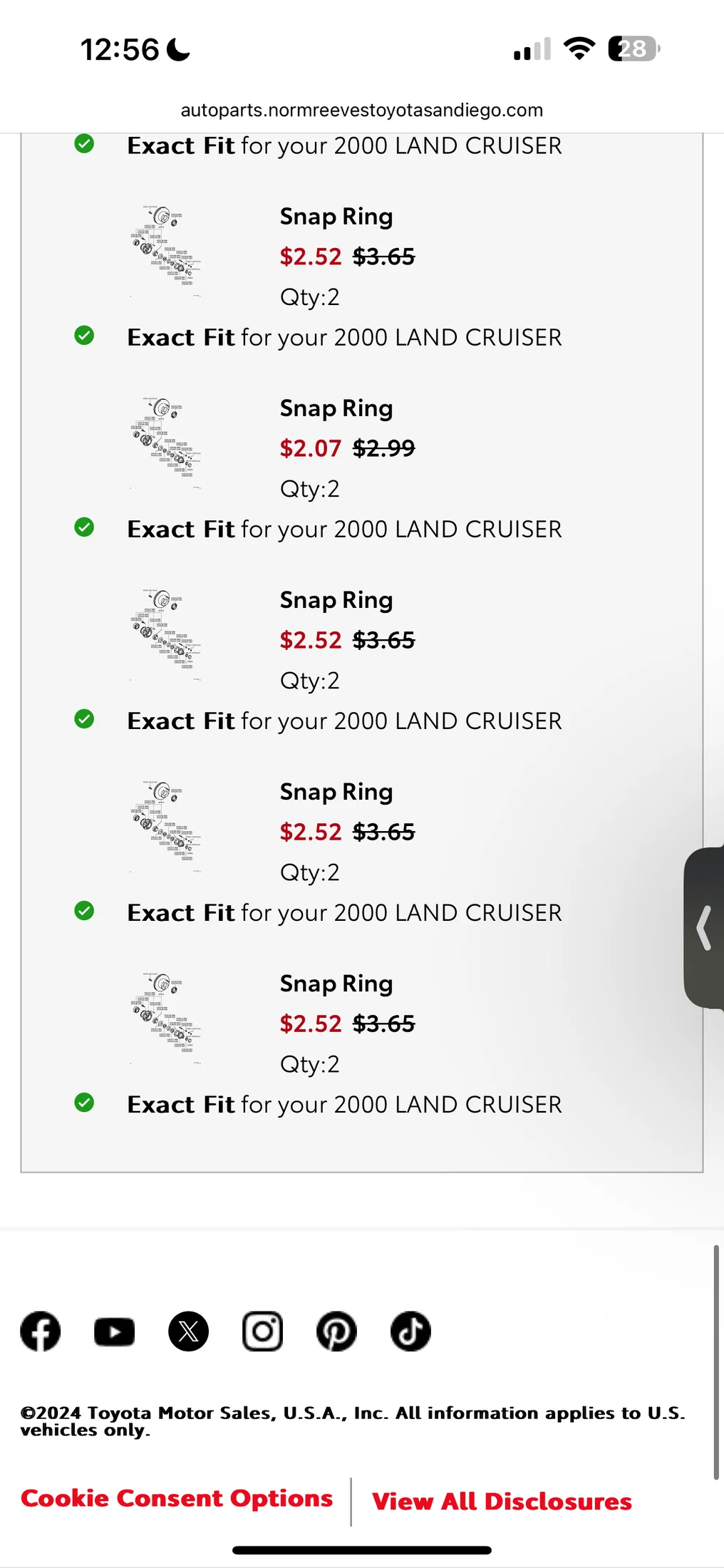

Saw some Toyota dealers have 25% off on their parts at the moment. Took the jump and bought essentially a brand new front end lol, following a comment here I also got everything up to the flanges. The secondary hardware PNs can be found in the link above, prices listed were similar with most parts being a touch more expensive. Costs in the attached pictures had an additional 25% off in the cart which was super
Rack and pinion 4425060050
Front LCA Left 4864060010
Front LCA Right 4862060010
Right Tie Rod (#1) 4504669195
Left Tie Rod (#2) 45047-69100
2x Front CV Axle 43430-60040
I will note that the part number for the RH Diff seal (9031147013) was able to be found on their store, but the left hand side (9031147027) could not be found. Funnily enough saw it on Amazon so instead of going with the alternative it recommended I bought that seal from amazon. Otherwise followed the related hardware PNs in the post I linked above to a T
