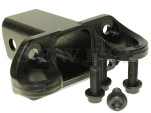

Is this what you're talking about?
http://lexus.sewellparts.com/accessories-catalog/Towing/LX470-2005/4436.html
I bought it and it works fine. You'll need a big Torx bit (a T55, I think, though it's been a while so double check) to get it tight.
Also know that with some receiver ball mounts, like mine, the forward end stuck into the receiver will hit the spare tire before the holes line up to let you put the hitch pin in. You have the choice of cutting off the front of the tube or drilling a hole in a further-forward position. I drilled the hole.
Nope, I already installed that. I need the draw bar, and would prefer something that I don't have to cut the end off or re-drill the pin hole. :)

Problem is, the bumper mounted (OEM) hidden hitch requires 1) the Receiver adapter shown above and 2) a special draw bar.......
