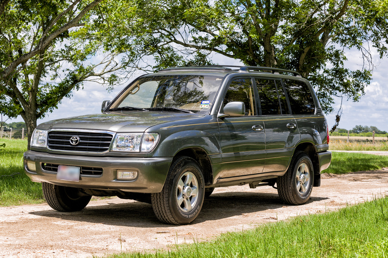

De-vagination step one is complete. I blanked out the plates because they are the original owners plates. Mine will be different. I'm almost thru the list. Waiting on parts
Before
After
Looks better already!
One thing to consider: you might remove the factory roof rack. Benefits are that you might like the look and it will make the roof rack replacement much less painful. It took the bulk of time adding a FR Slimline to mine. I realized after removing it that I liked the way it looked, too.
