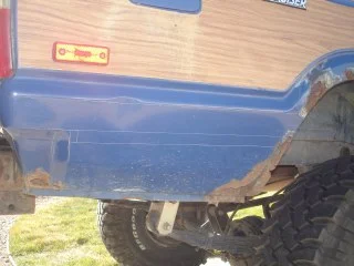

Im welding body panels right now with it, using flux core wire...:D
Before and after!
