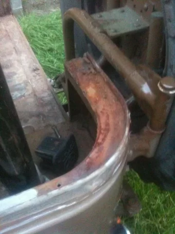

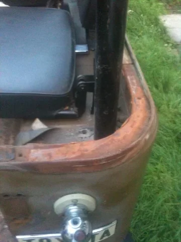

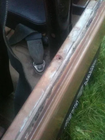

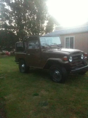

Finally got my top off!! I have had the truck for over a year and a half and just got to the point where I need to start moving on this thing. What's missing in the area where the top was? A gasket maybe? Any suggestions please!!

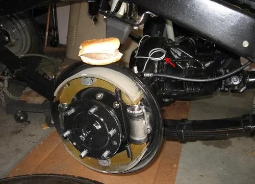

Sure is beautiful Cleg! :clap: But why have you coiled your brake line here:
Axles are subjected to "shock movements".
So in that position I'd expect that coil to contribute to metal-fatigue and consequent line damage (rather than protect against it as you probably intend).

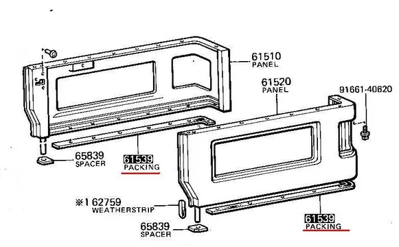

Packing .... Part number 61534-60011

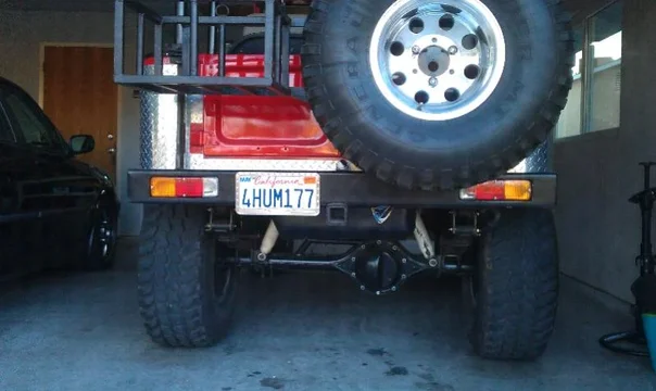

Over the past few days I picked the 40 up from Edwin's shop and fixed some fuel line and fuel tank issues. :o
The 40 purrs on the highway, but remains quite bouncey even with the 5125s (bling bling). :grinpimp: :grinpimp: :grinpimp:
Today, I took my little sister for a ride and stopped by Trudy's (by the UT campus). While we were grabbing dinner, someone hopped in, pulled it out of gear and pushed the 40 back a couple feet to fit into a parking spot. How do I know? They used the fender turn signal to push it; broke my driver turn signal. I had no idea this was happening. When we walked back out and I saw the damage I was f**king livid. Good thing neither they nor their vehicle were around when I got there. :mad: :mad: :mad:
Here is a picture before the idiots had their way with my junk.
That is really nice. The truck is also. ;)
When they bent your signal, did the fender metal cave in like mine?
I need to find out how to fix that because the support bracket is blocking access. I am tempted to put a scrwedriver in it and pry it out.
I am going to think about that for a while though.
That is a 4" and 5100s?
Thanks Rex. No caving, just a messed up mount. The turn signal now moves back and forth like a bobble head.
Yep; 4" + 5125s. Better than stock, but way more hoppy than my old YJ. :eek:
