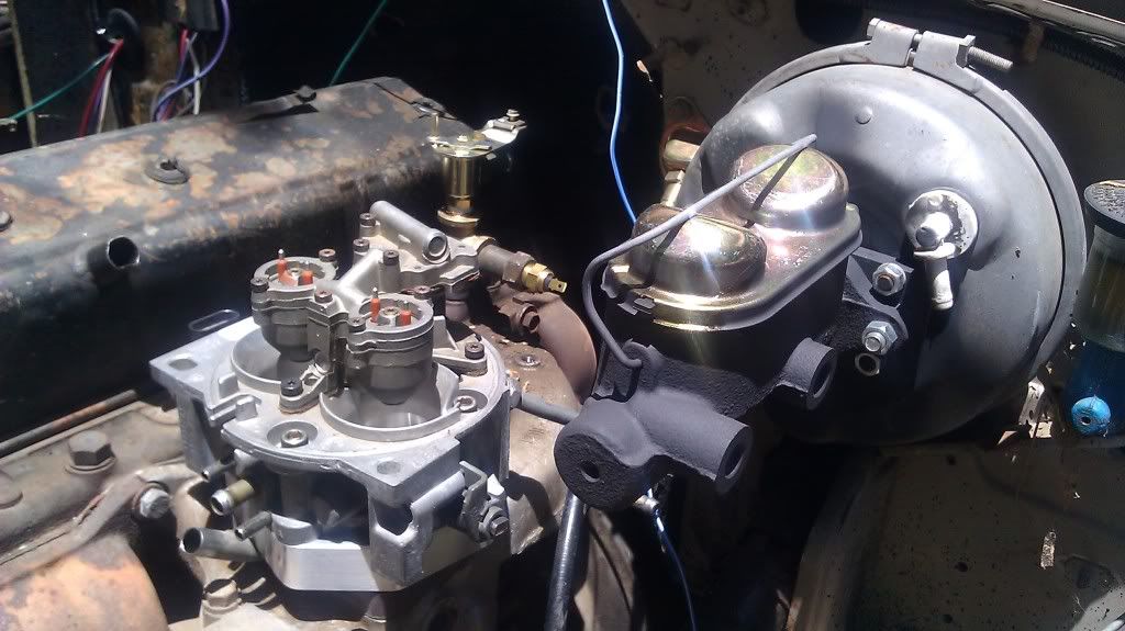

installed new master cylinder, bled brakes. drained rear end, replaced the couple of mangled studs on the bottom of the diff cover, reinstalled diff cover and filled.

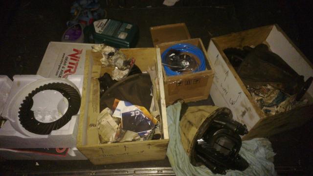

the week before last I got these in
4.56's, chinese air locker in the front:

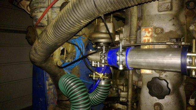

The last week this:
gt2052 turbo, denco manifold

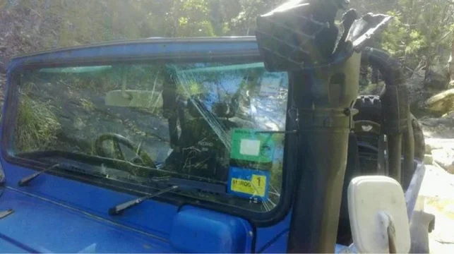

Went out yesterday and 5mins in did this:
so now have a fresh windscreen frame painted and waiting for glass to install.
