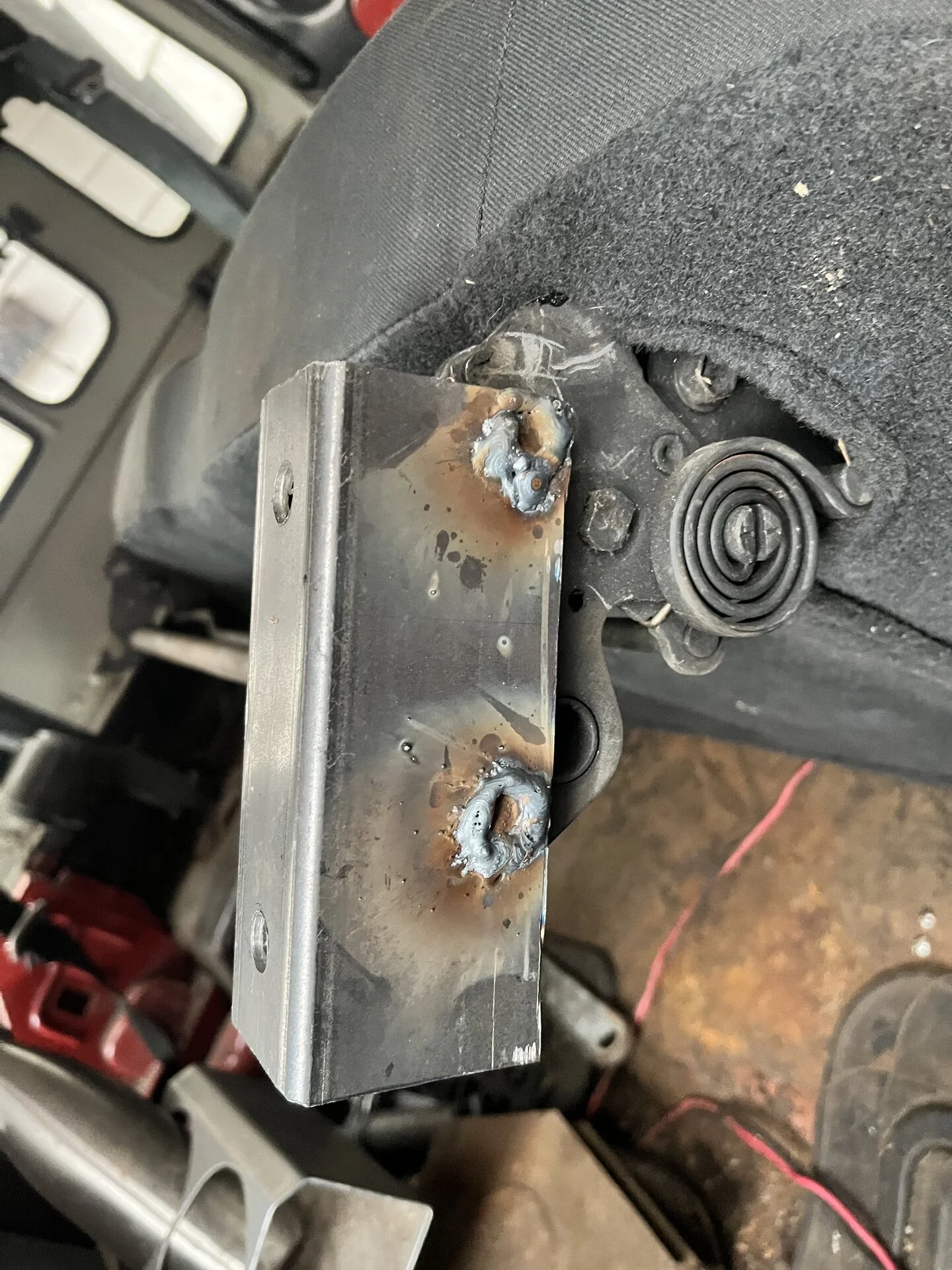

POROSITY!View attachment 3566461View attachment 3566462

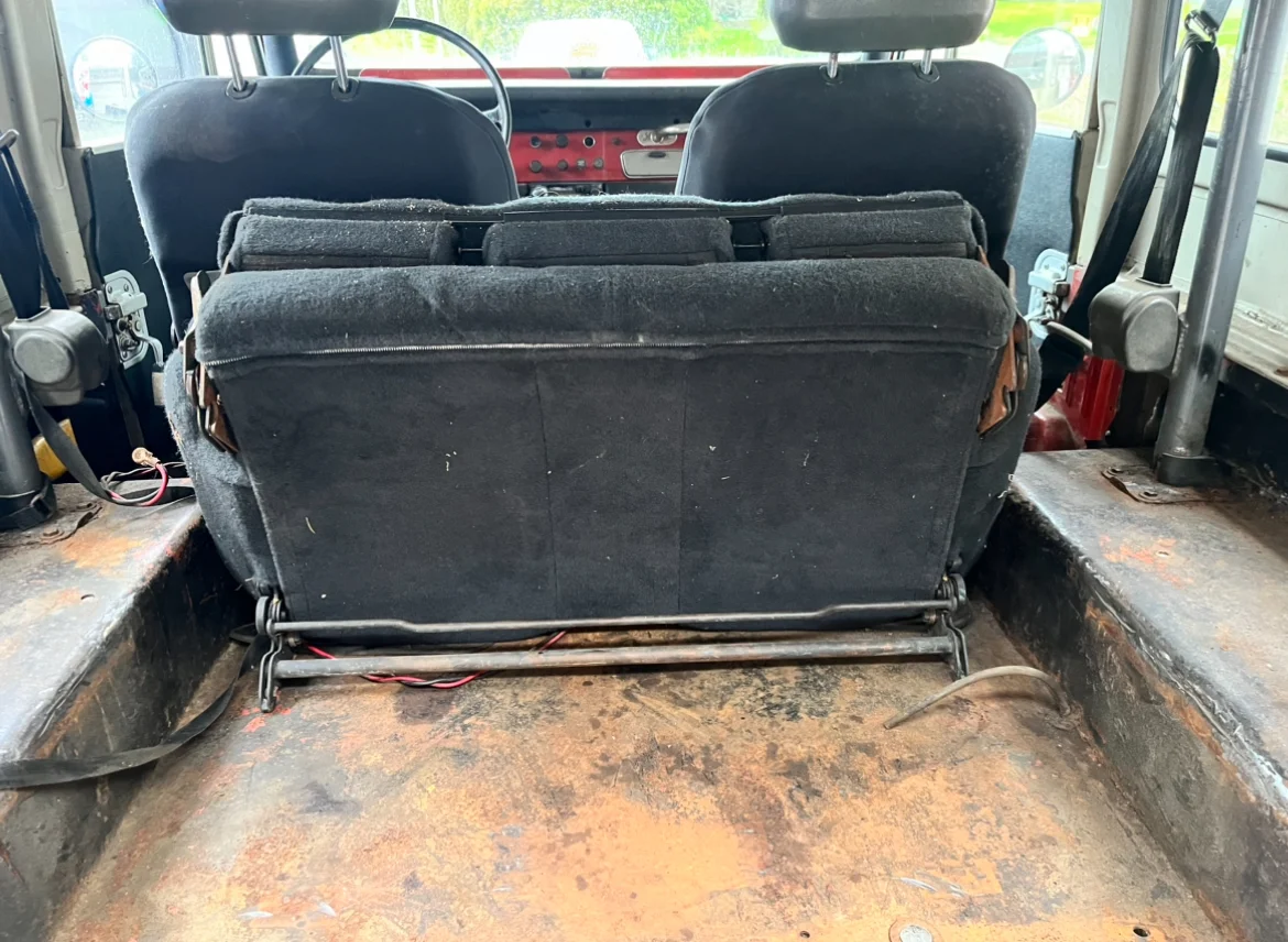

In progress picture but it shows the space well. Brackets weren’t installed yet.View attachment 3566463upholstery came off easily so I painted the raw metal.

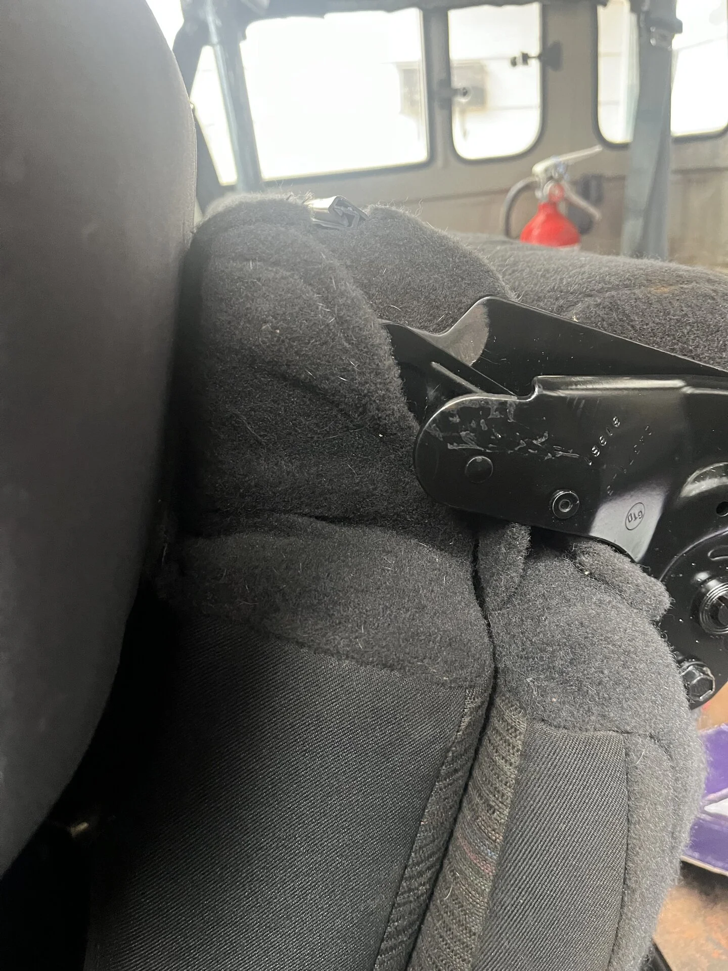

The seat is spring loaded so it should stay tipped forward.View attachment 3566469

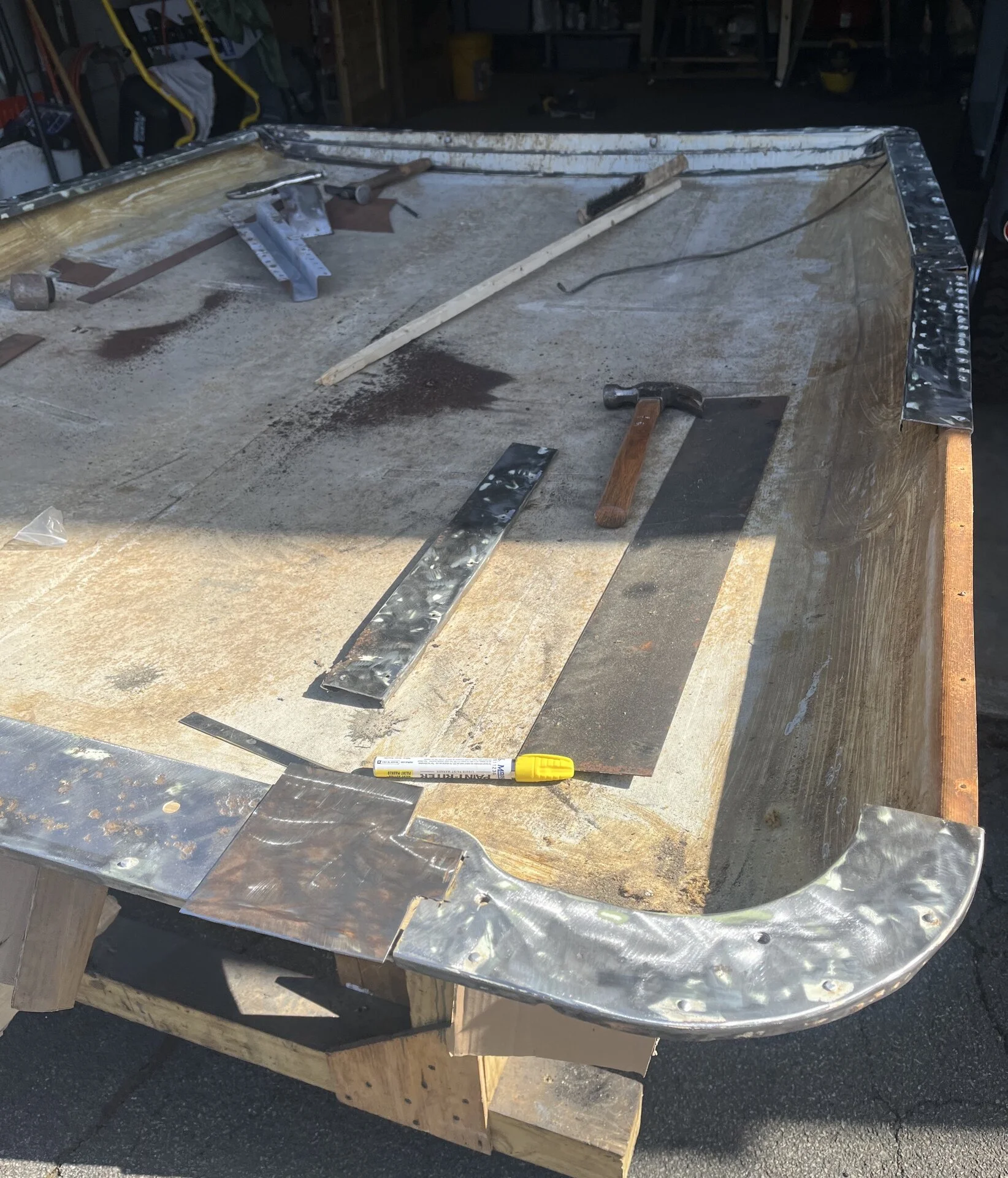

In progress while fabricating the brackets.

A bit… not enough to cause an issue. The solid rod goes all the way through and is welded on both sides. Since the metal was very clean I believe I wasn’t running quite enough shielding gas.POROSITY!
