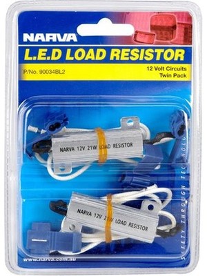

Were those the Narva led lights? I am getting ready to do this as well. Can you explain the resister? I didn't know I needed one. Thanks

Yes, I found a thread on the 40 forum. I went through eBay for both the lights and resistor.
Lights: Narva 9-33 Volt LED Rear Stop/Tail Direction Indicator And Reverse Lamp (94210) | eBay
Two pack resistors:
If you use this seller, make it clear you want both shipped together and only pay the shipping on the lights. He hosed me and charged me shipping for the small package of the resistors. They where included in the same box.
On the resistors, They are used on the indicator wire only (green on the Narva and green with yellow stripe on Toyota) Splice in one end of the resistor wire to said wire and and attach a lug terminal to the other end of the resistor wire and secure it to a good ground.

My reply was intended for the olive>red repaint above, but a previously unfinished reply to your resistor thread causes me to quote you. My un-sent reply to you intended to point you toward Coolerman for a blinker module that he sells which tolerates LEDs. It’s a plug and play replacement and will alleviate the need for future resistors when you add other LEDs and also eliminates the need for extra wire splices for the resistors which reduces failure points.
