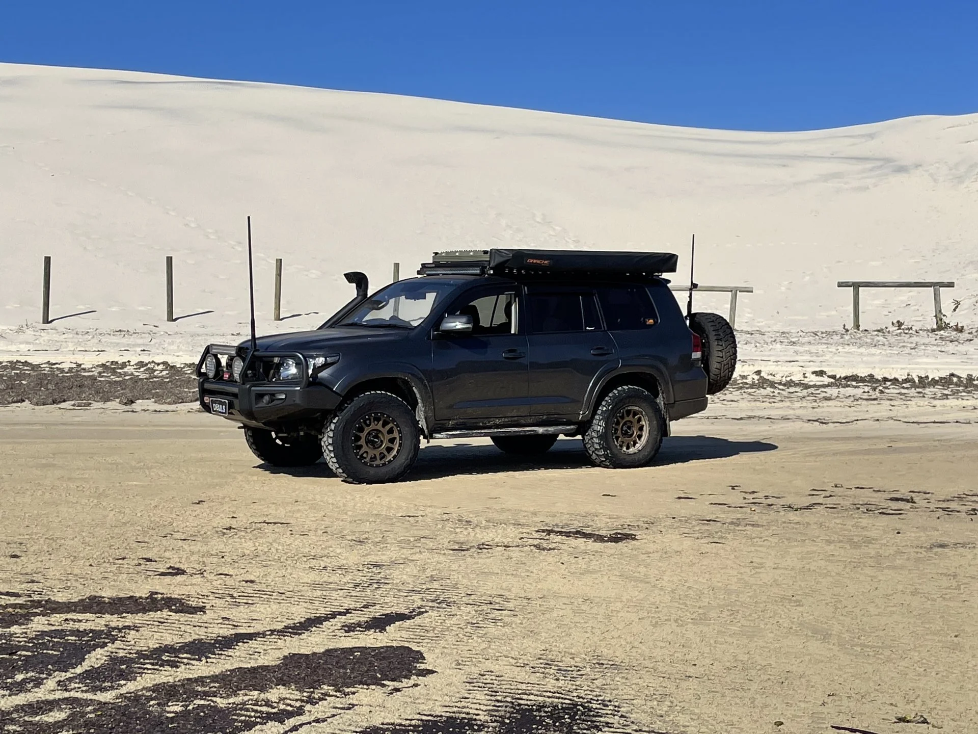

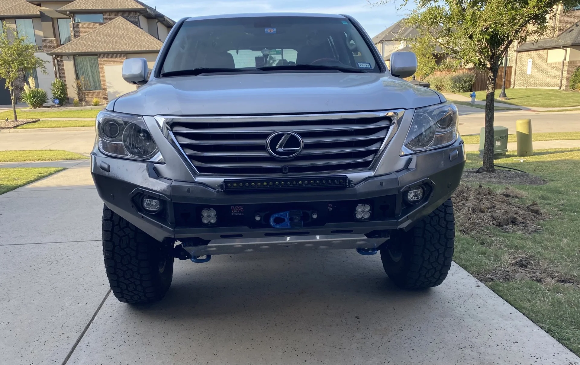

After many months got my Rhino bumper dialed with all lights and color matched sensors headlamp cleaners and color matched the plastic parts on the Rhino bumper! Love it

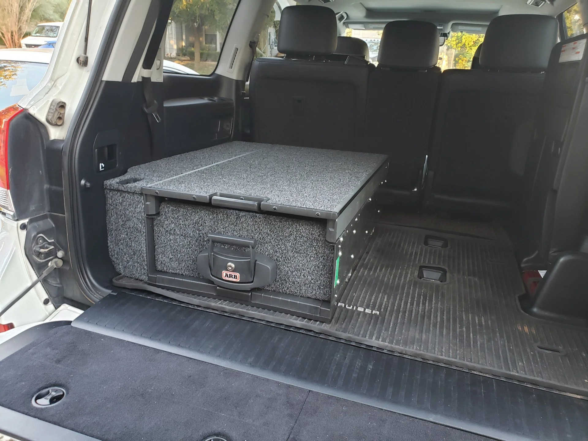

Installed single ARB drawer. Pleased with the drawer. Instructions weren't the best.
It came with enough spacers that I was able to stack an extra 5mm to each mounting point and keep the heavy duty mat in the back. Helps if you get a longer bolt for the front if keeping the mat in, but not required. Did have to trim the rubber mat's lip in two places where the drawer's rails hit it.

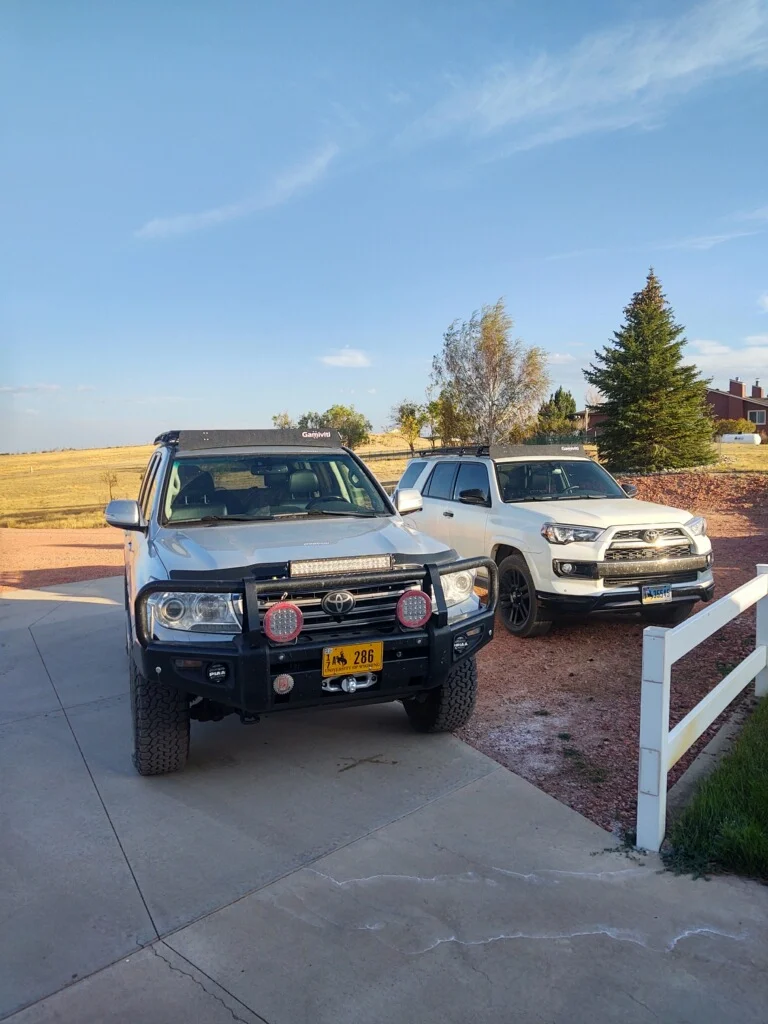

Just tooling around in the minivan. One week in and the wife is still happy with the purchase, so that's a rare treat :o

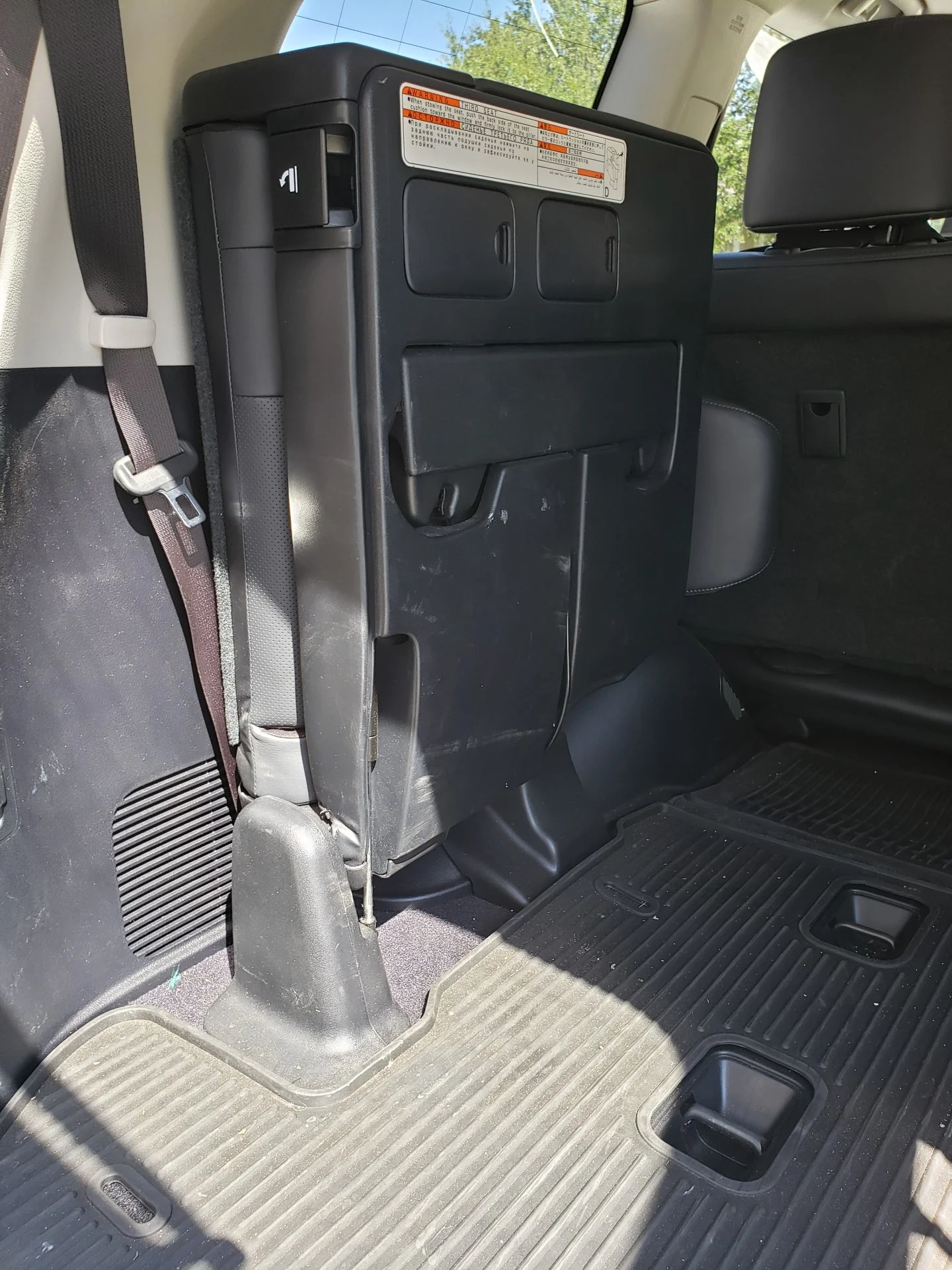

Looks great. So removing carpet is not required to install these huh? Sounds like it is for some of the others. I'd love to do something like this with a 4" drawer on the right side for fridge slide to sit on top of. Mine is an HE though, so no 3rd row mounts visible right now.
Thanks
That's right, you don't remove the carpet. You do have to trim a small notch out of the carpet near the seat's front floor mount. You also have to trim some plastic webbing in the same area below the carpet at that mount point.

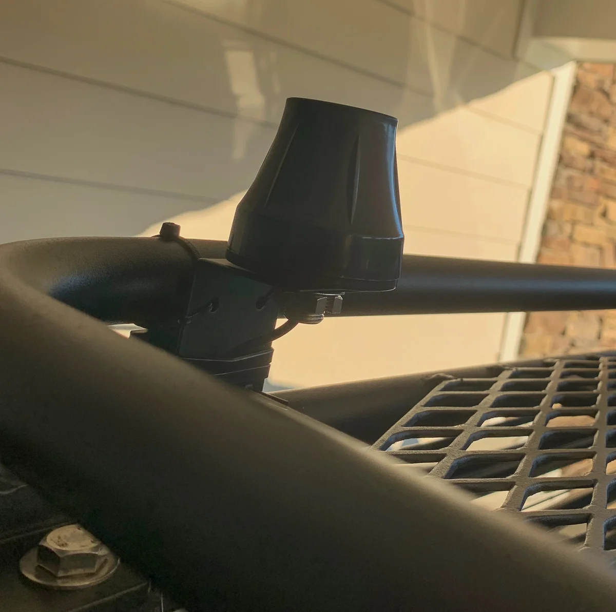

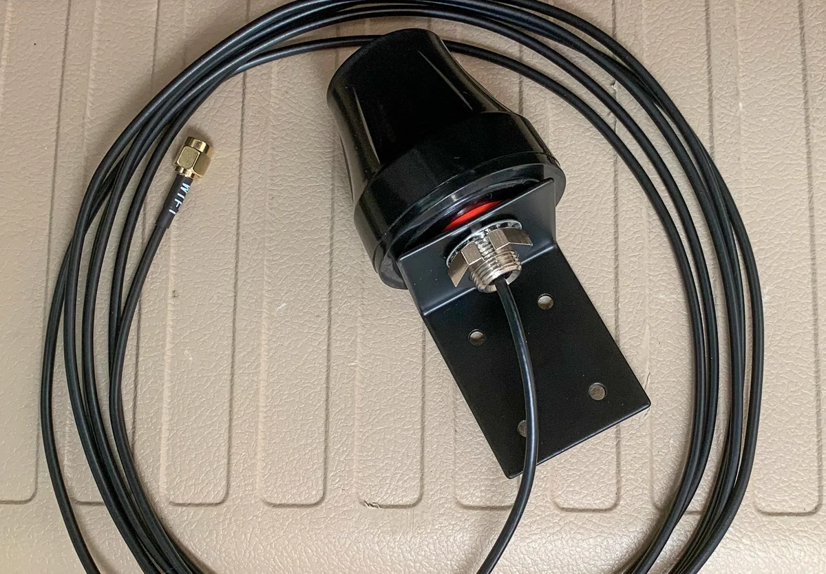

I had some wifi gear leftover from a project. It is starting to get cooler here in Florida and I need to bolt some more stuff to the TLC. I am waiting for some parts to arrive. First I am adding two external antennas to the rear corners of the roof rack and a station to connect the LAN to a nearby access point. I am also considering adding a YAGI antenna ( either fixed or deployable ) on another station to connect to distant public hot spots. Any comments or suggestions?
Curious as I’ve never done something like this, but where do you source WiFi? Is this something like a hotspot?
This would connect to a Wifi that someone provides, like a campground or restaurant. That connection will allow your devices that are connected to a local Wifi router in the vehicle to reach the internet. It can provide a better connection, and it is convenient when you may have several Wifi devices, so you don't have to reconnect each one when you change locations. There are devices sold for RVs that can do that and more, like the Winegard products.
