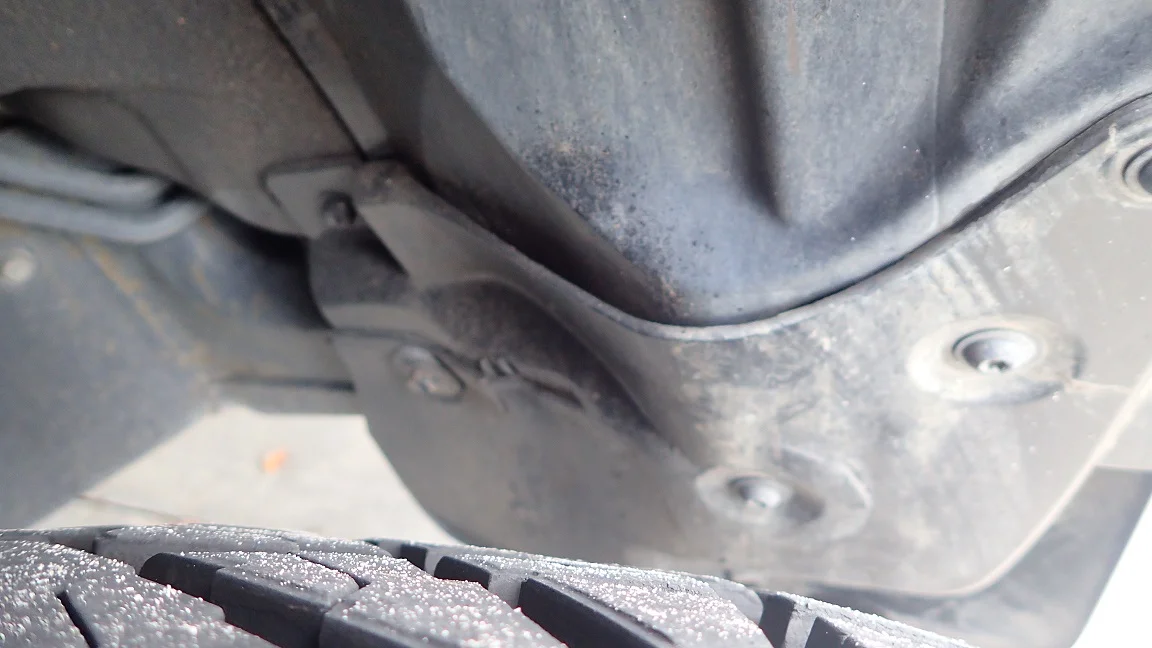

Nice work. Did you damage the stock mud guard? A lot of people running 33-34” mold the factory part with heat and a block of wood.
I am someone who has molded the front mudflaps with a heat gun and a block of wood. The problem is that the mudflaps are close enough to the hot engine and hot road, that the natural heat around the flaps eventually reforms them back into their original shape that rubs.
I think this happens to the flaps because they are a very soft plastic.

Just FYI you need to screw them down so they don't pop back out.
Like this ...
Nah they are not damaged but when I put on the 28mm steel plates on the tires I saw on the first meters of driving… yeah more i heard it…. that they rub. Then I was driving the last two days without the mudflaps.
Since a friend has this big plate of plastic laying around (he was making last year his mudflaps for his Hilux with this) I decided to make some from scratch. This is easier to bend with heat and stays in his position after cooled with water but I’ll see around new year if it’s stay in position when we drive to North Africa in higher temperatures.
But on the drivers side I have to do tomorrow some more work since the mounting points on this side are closer to the tire -> the car had ‘16 an bigger accident on the front left so some things are not 100% anymore in position😇
I'm a little surprised myself that I got it right the first time so well that everything fits well

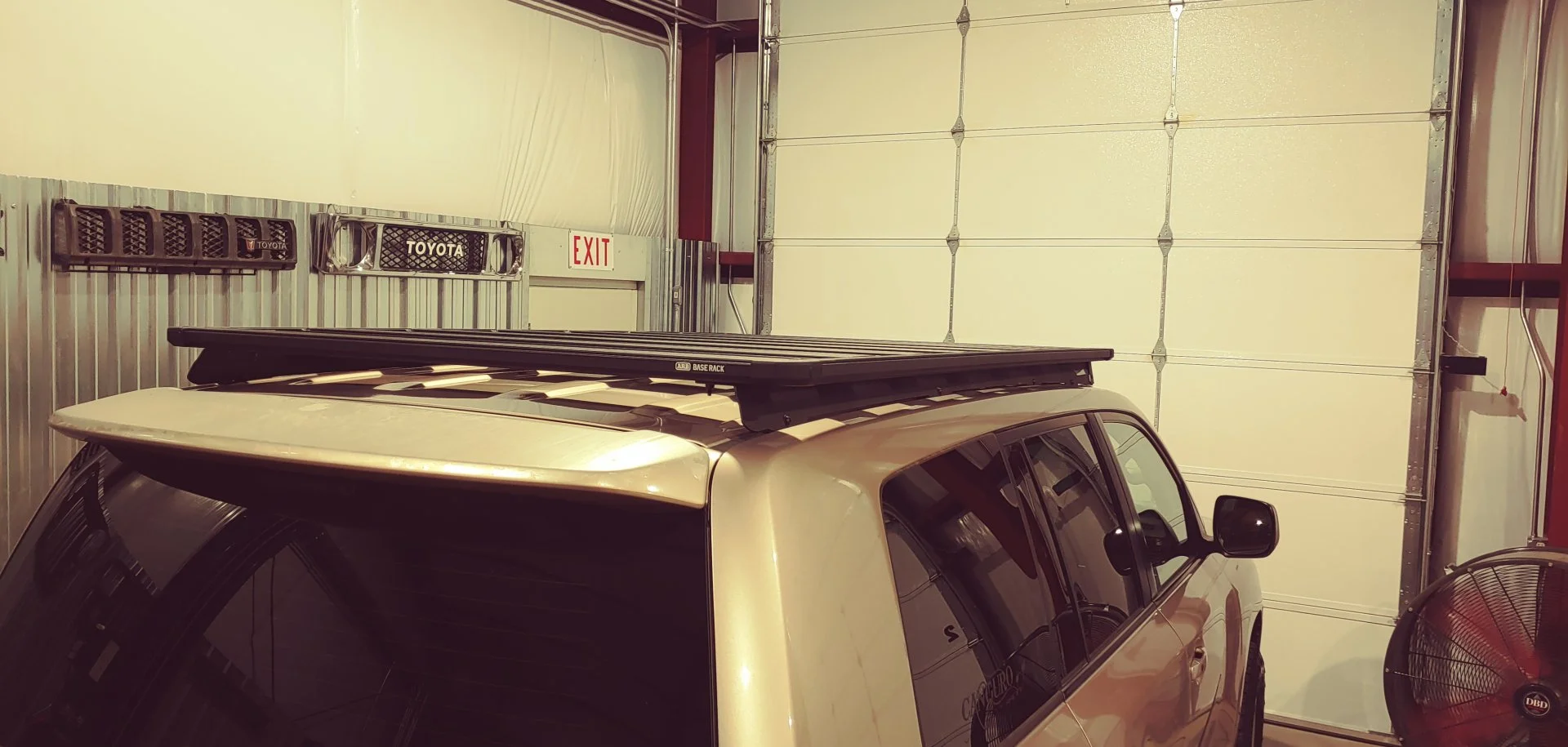

ARB Base Rack installed. Still working on mounts for the GFC Super Lite, but at least the rack is done. Then we took it out for a quick day trip to see the Kokanee run up the river, and enjoy a campfire dinner.
