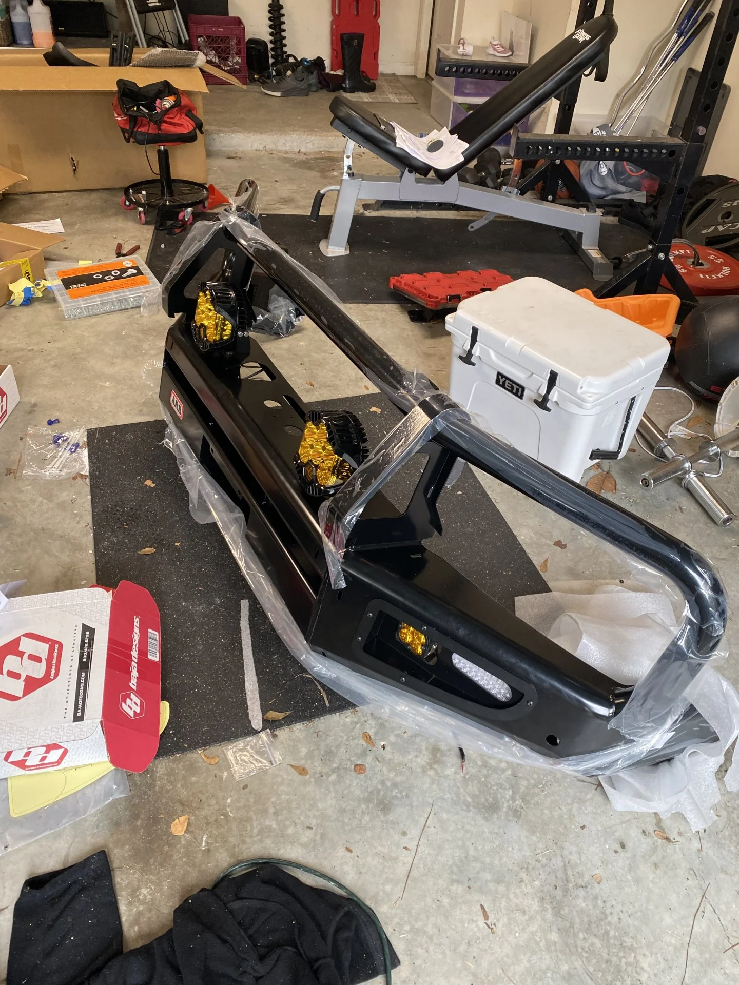

Got my Base Rack today 🙌
Now I only need to wait a few months for the mounting kit….
Mine is due to arrive tomorrow, how do you like it so far?
I am assuming you are responding to my post. So far so good other than a small area where the powder coat chipped off. I emailed them about any temp measure I can do to protect that area (no response). Only have had it on for 24 hours now but it is exactly as advertised. Assembly was easy. Only thing I didn't have was a torque wrench to tighten everything to instructions spec. With the difficulty I had with mounting the tire (holding the tire and adjusting bolts), the ability to take the tire swing off and on as needed is going to be a chore so mine will likely stay on at all times unless I go to a true rear bumper swing out. Not sure on your state laws, but the license plate can't be obstructed. I have mine zip-tied to my wheel until I order the license plate bracket. I think I am going to be buying locking lugs to be safe.
Yes, sorry, thought I had tagged you in the first reply. I'm looking forward to it, I did get the license plate bracket, just to be safe. I was thinking about the holding the tire/bolts and came to the same conclusion. We'll see what happens when it arrives.

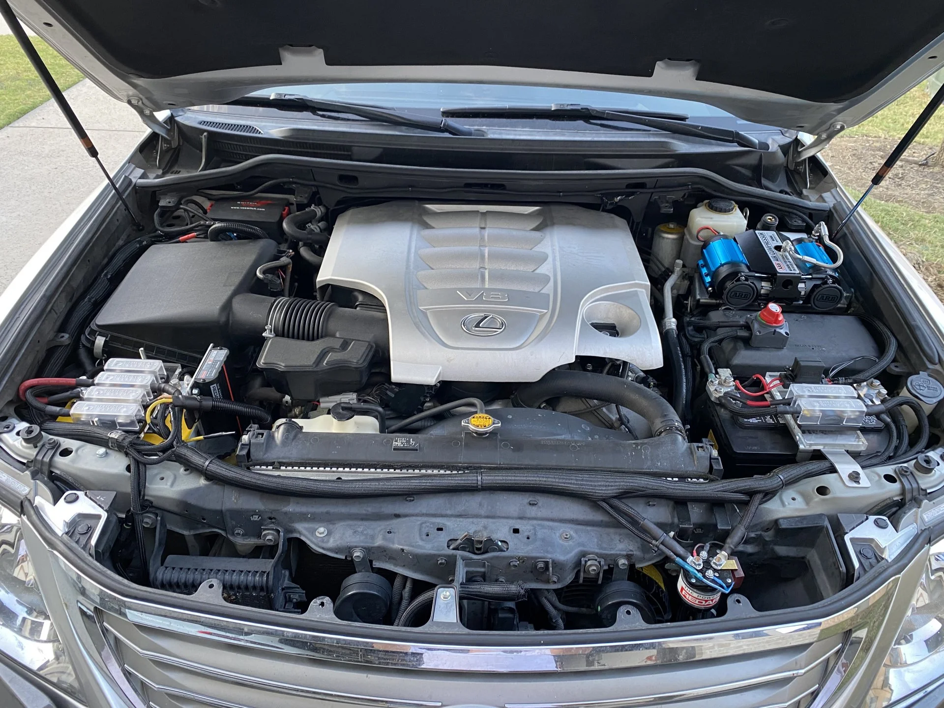

Got most of my electronics down!!! Fyi… was not just this week… and still tbd a few things. Winch solenoid under compressor.
What’s the RedArc device in the lower right?
You should consider reinstalling at least the front most cowling as it is responsible for directing airflow through the radiator - especially at low speeds.
Yes, thanks for the tip. I will get to it at some point once done with rear bumper.
It is a 200 amp dual battery isolator. It will cut off the power to the aux battery when main drops to a certain voltage, but it will allow the alternator to charge aux battery when on. It has a trigger to override if you need to jump main battery from secondary. I have the switch on the voswitch on upper left so I can do it from in the cabin.
Probably overkill but I am kinda down the rabbit hole.
what brand battery terminal is that on your main battery?
Yeah those terminals. I searched for a while. I didnt want to pay $100 plus for terminals but everything else I saw looked kinda cheap and not as functional.
These are from rugged rocks. Battery Terminal Distribution Blocks by Rugged Rocks - https://ruggedrocksoffroad.com/power-distribution-terminal-blocks-by-rugged-rocks.html
1 set is $45, and they are incredible. solid aluminum. 3 top screw in and one side one. I have them on both main and aux.
Wouldn't a modern DC-DC charger have been the better choice for the aux battery in view of other battery technologies such as LiPos which are also becoming more and more popular and cheaper? This way you are not bound to use the same battery type as the two originals.
Yes. It has a redarc 50 amp dc dc that can do all battery chemistries. It is mounted vertically next to aux battery.
I got the optum for now but honestly the best is to put a more advanced chemistry battery behind the drawers in the back.
