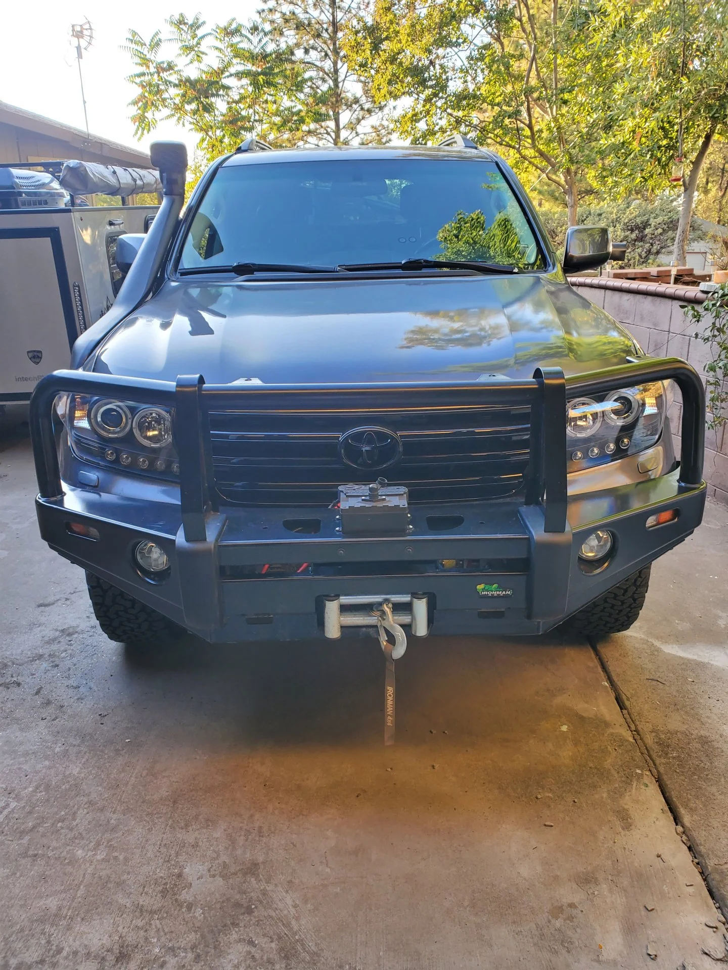

After buying the 200 at LCDC , Had the large dents at right rear panel and rear hatch repaired, detailed exterior and interior. Installed snorkel, New rotors, pads and ebrake shoes, new headlights, realigned
the ironman bumper, ordered RLC rear bumper, ironman rear drawers and sliders. Cancelled the build plans on the lx570 and keep it stock

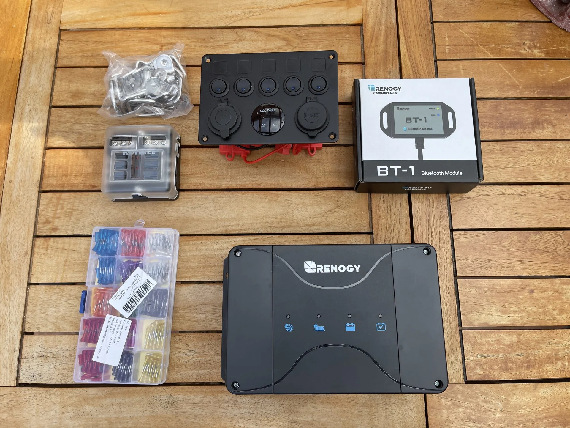

Today some of my parts for the camper box arrived.
I am only undecided which battery I will take. Possibly it will be an AGM battery from Hoppecke (good manufacturer who produce batteries mainly for grid and track applications such as telecommunications or power plants) because a friend who converts electric boats a few weeks ago has received a delivery. But 160Ah will probably be too much of a good thing for the Land Cruiser.
Let's see how the charger from Renogy does. As far as one of the few on the market that combine normal charging from the generator and solar panels in one device.

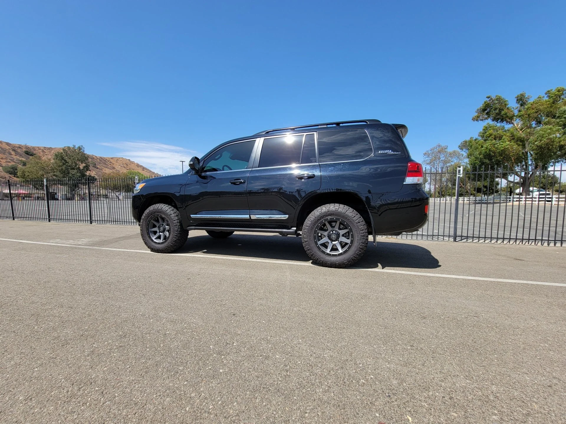

Got an alignment after fully done monkeying with the suspension and UCAs. Also added spidertrax wheel spacers. Dont care what anybody says negative about wheel spacers love the look! Still work in progress
Got an alignment after fully done monkeying with the suspension and UCAs. Also added spidertrax wheel spacers. Dont care what anybody says negative about wheel spacers love the look! Still work in progressView attachment 2783685

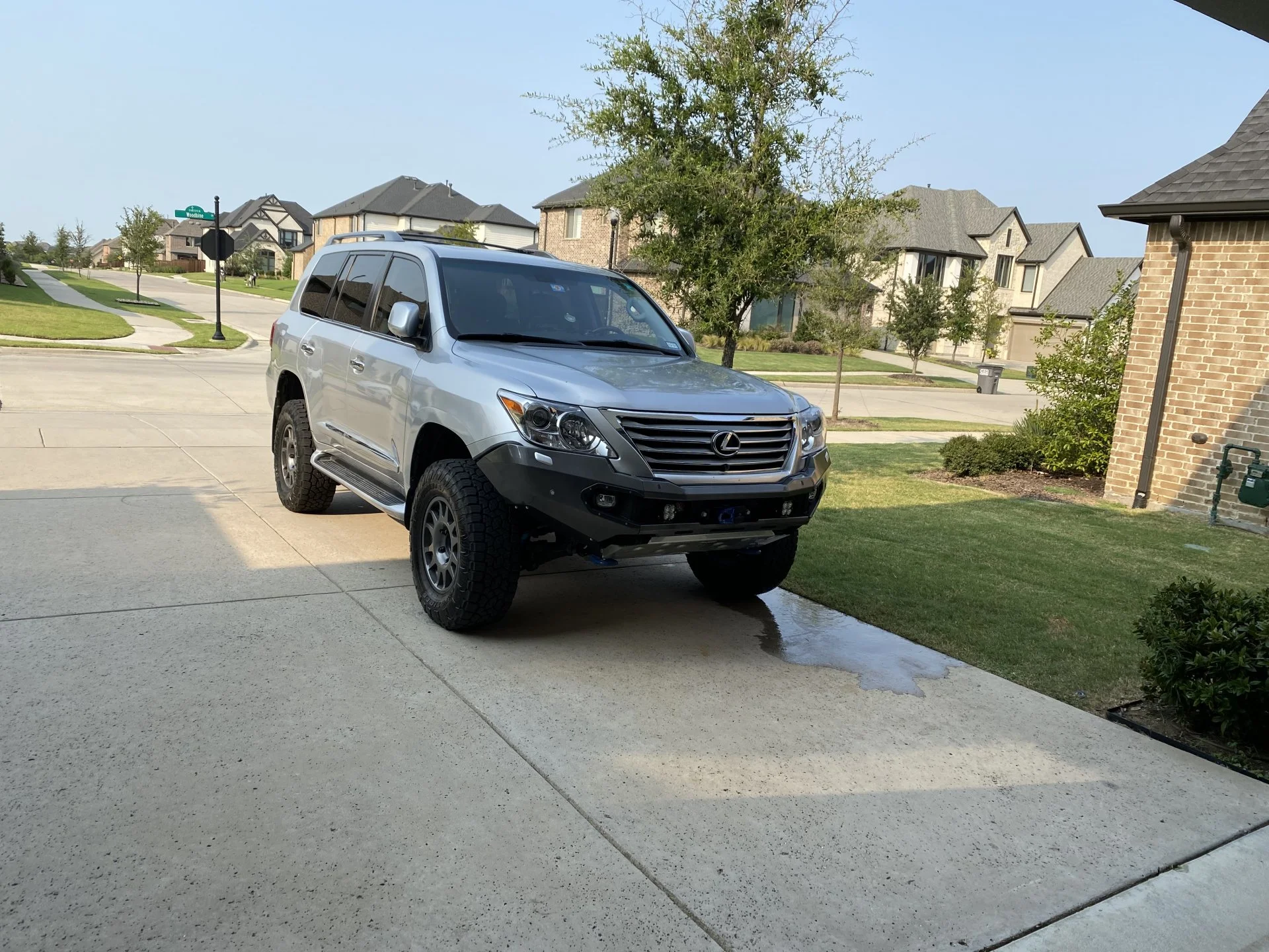

I think this is the best fitment I’ve seen of a Rhino bumper on an LX
Thanks! Still not 100% happy with it but work in progress. Have to color te little silver pieces.
