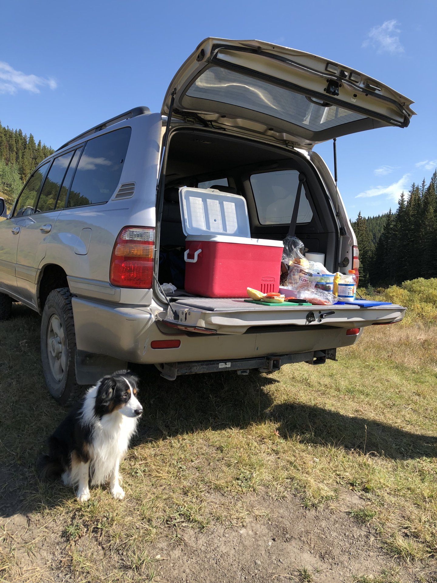

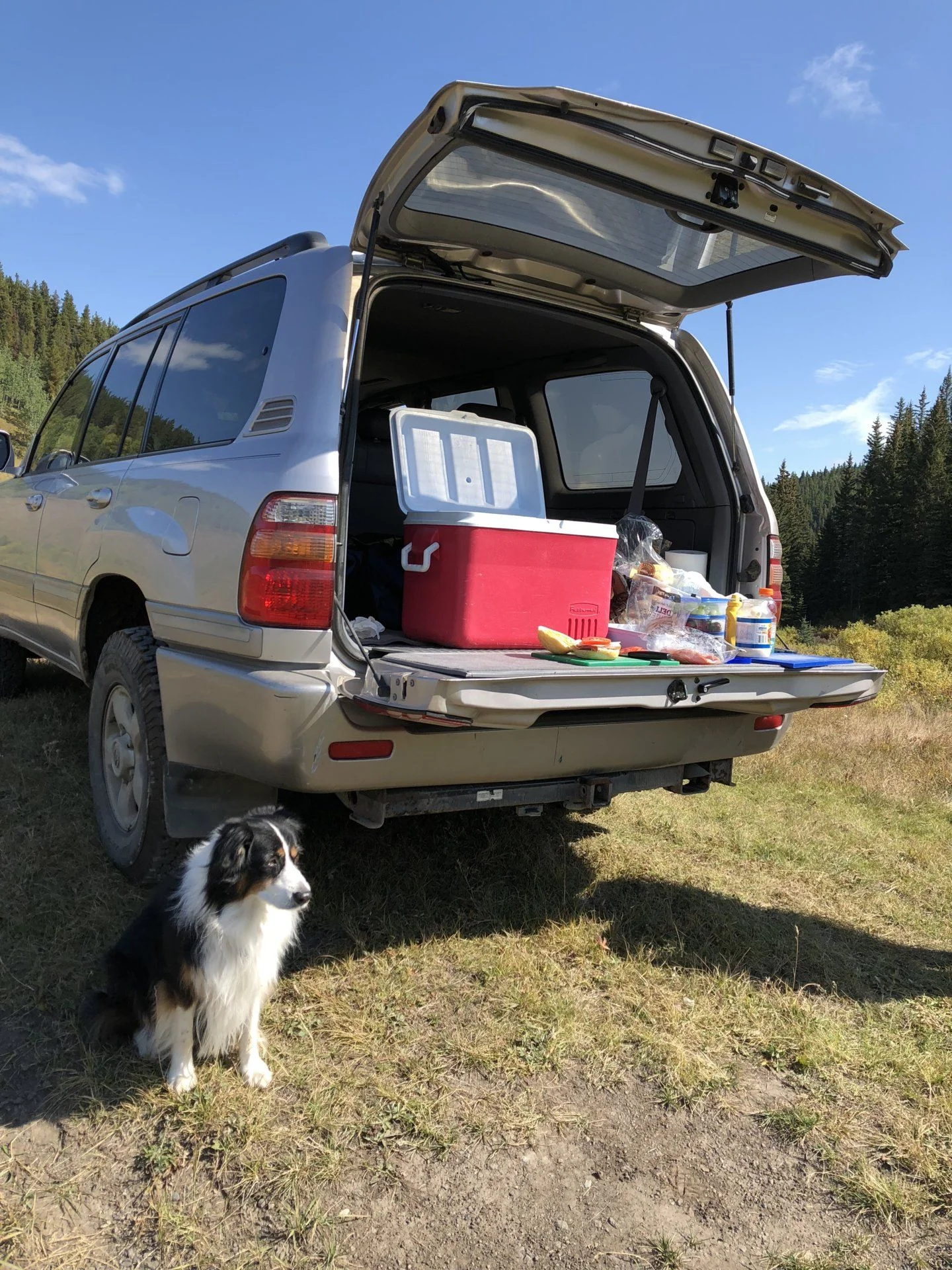

Took my 98 LC out to McLean Creek.
McLean Creek Off Highway Vehicle | AEP - Environment and Parks
Added some pin stripes and had a great buffet lunch.

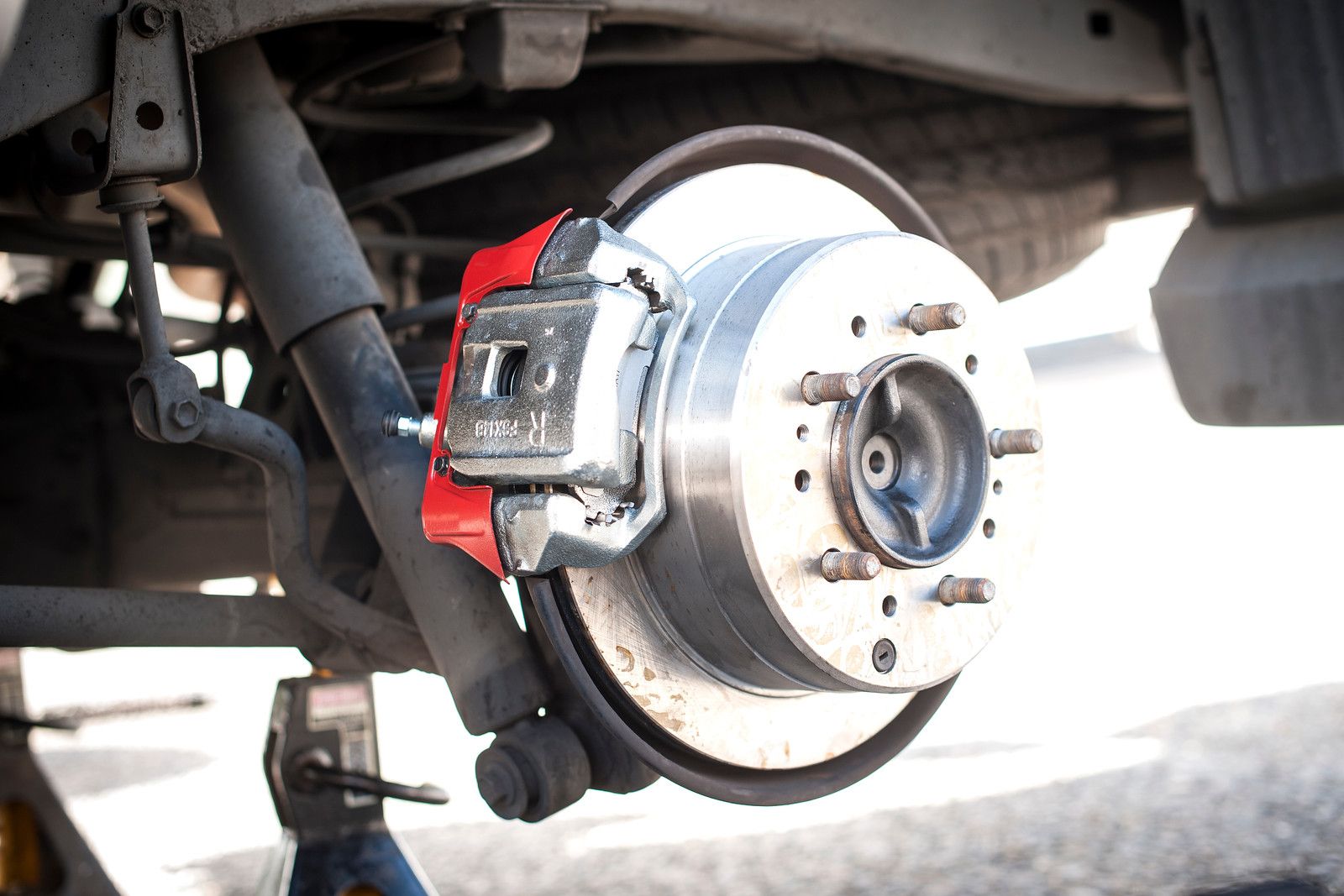

Mfr? Toyota?
I normally go with Toyota for the brakes but this rig is getting old and I wanted to get this done so I just grabbed the best stuff my local AutoZone had and slapped it on...

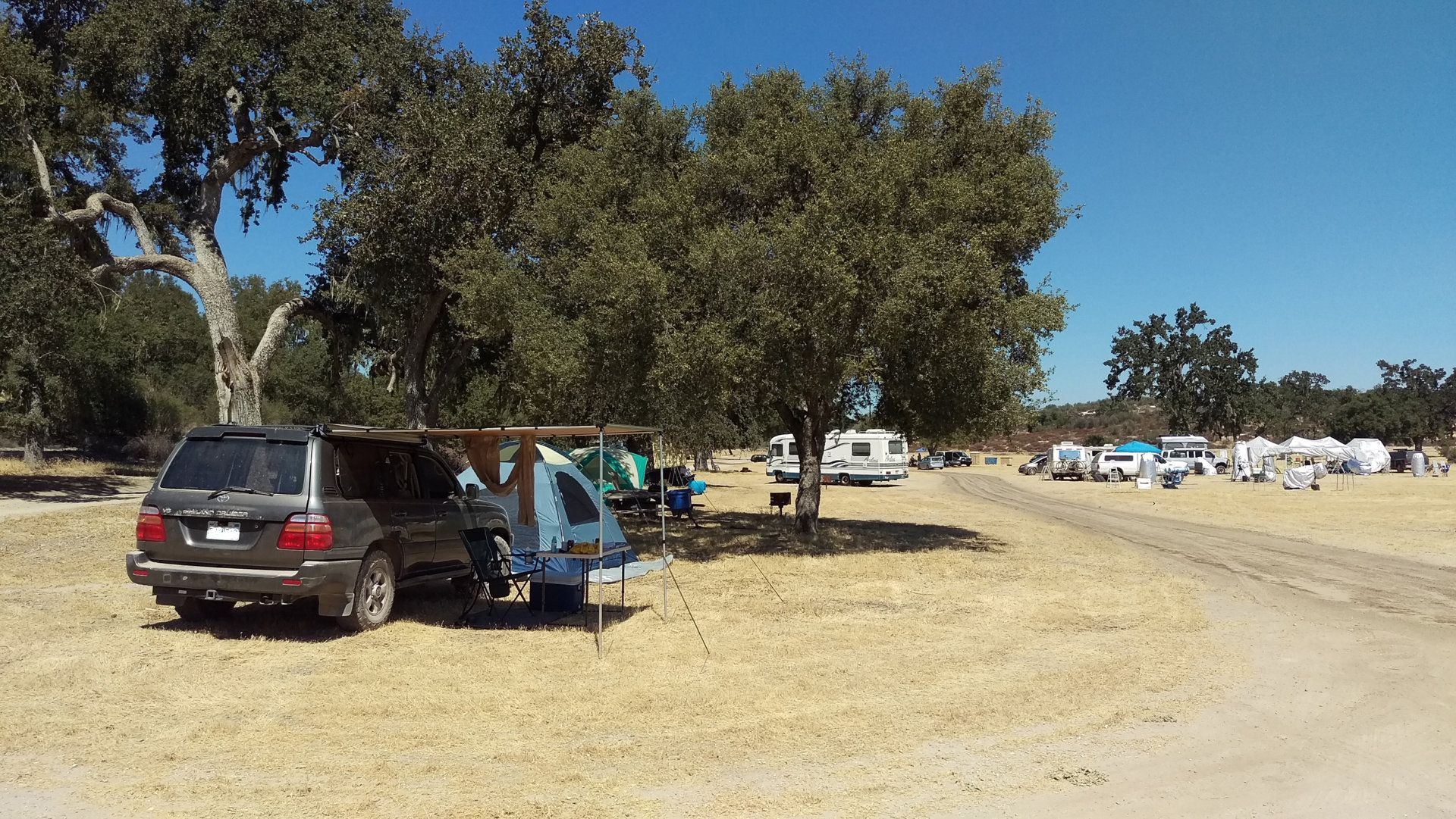

View attachment 1786301 Went to Lake San Antonio (California) to look at the stars. The awning helped me nap during the day after being up until 3 am. (picture of Andromeda was taken early Sunday morning). I like how the LC swallows up all my camping stuff as well as two bulky telescopes.View attachment 1786302

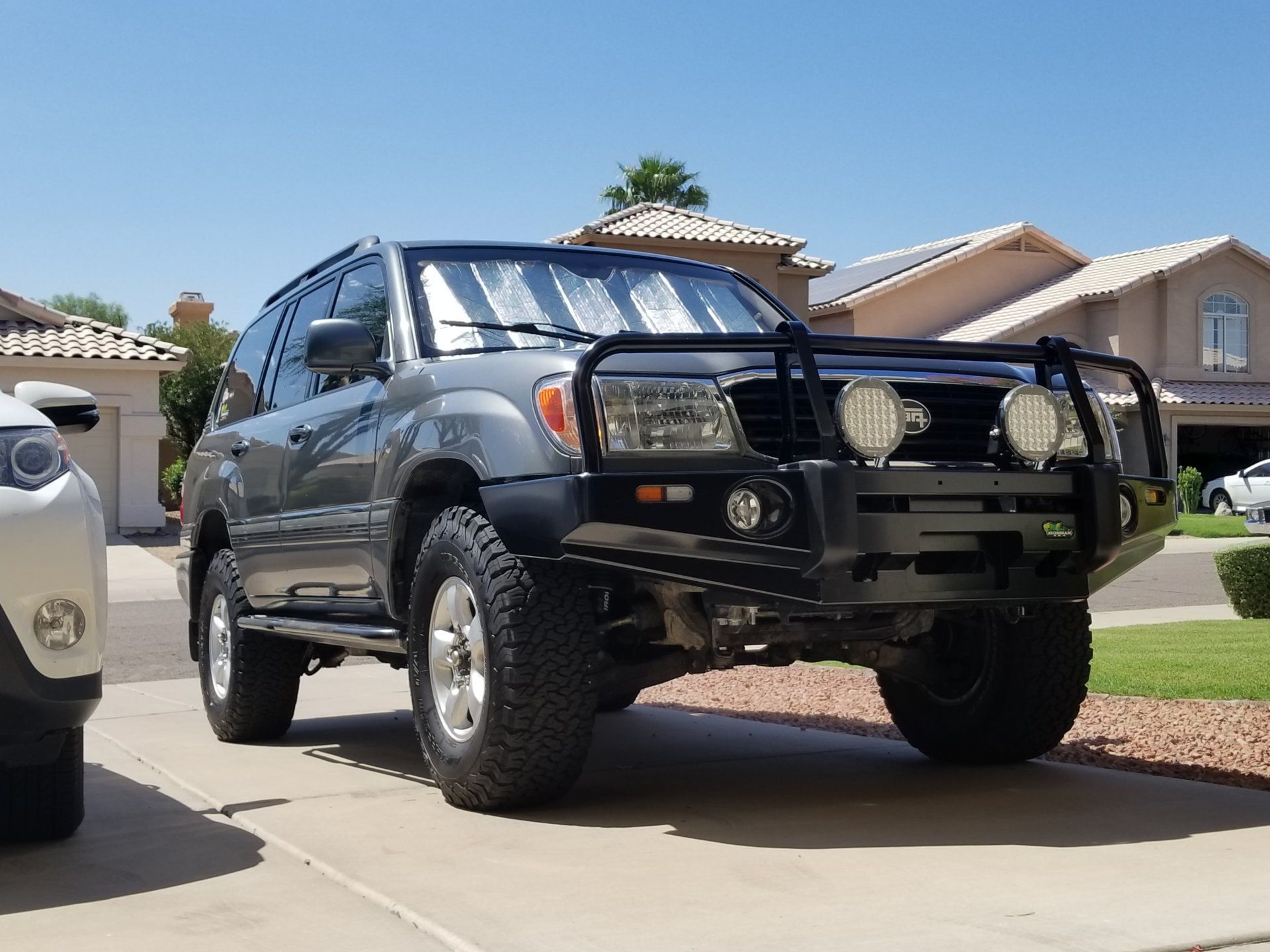

Got a shot of what the light output looks like? have been considering a BiXenon retrofit but maybe that would be a better route
A decent bi-xenon retrofit will outperform current LED headlight offerings. LED headlights are picking up popularity and reputable companies are making LED specific bulbs with a proper cutoff line so they don't blind oncoming drivers and drop into existing housings as well as LED projectors but the tech isn't quite there yet for them to outperform a decent Bi-Xenon kit. I did the Acura TSX projector retrofit into my truck which are just low beams and they are quite nice. Excellent range, intensity and width. I will be doing a bi-xenon retrofit in the future though. Most likely a 3" projector like the Mini D2S 4.0.
Thanks for the input. I will probably do the retrofit soon. My concern has been around what happens if I ever have a bulb go out... I won't be able to hop down to autozone and buy a new one. How often do the morimoto style projectors go out? From what I read, they are fairly reliable but I haven't seen any mud discussion on the retrofit threads (i may have just missed it when i was browsing)
That one way to get fluid bled from bottom of calipers @kreiten ..LOL. How's it working out!
Nice catch @LXFAM
Nice catch @LXFAM
Hah, I caught it before I slapped the wheels on and swapped them:) When I went to bleed the brakes I was like something is def wrong:doh:

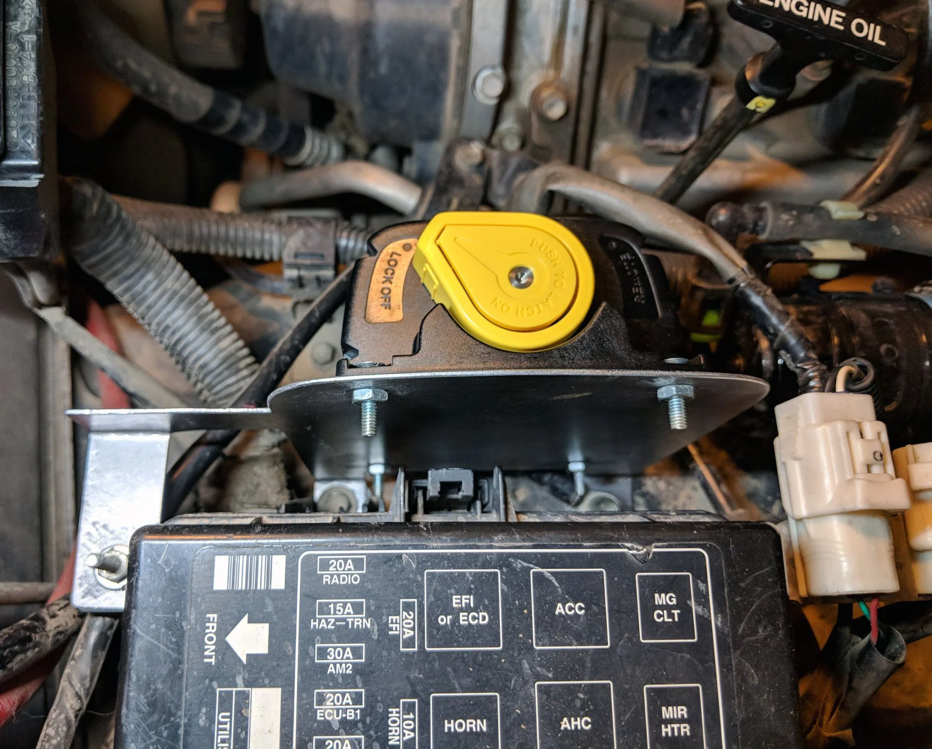

I made some more progress on my never ending battery management system project...
Today I was able to get my ACR bracket finished and test fitted. I have everything re-wired to my circuit breaker now, so the only things left to do are paint the ACR bracket, get some proper hardware and install it; then wire the ACR up between the two batteries. Hoping to have that finished in the next day or two so I can get out and use the compressor on Saturday!
