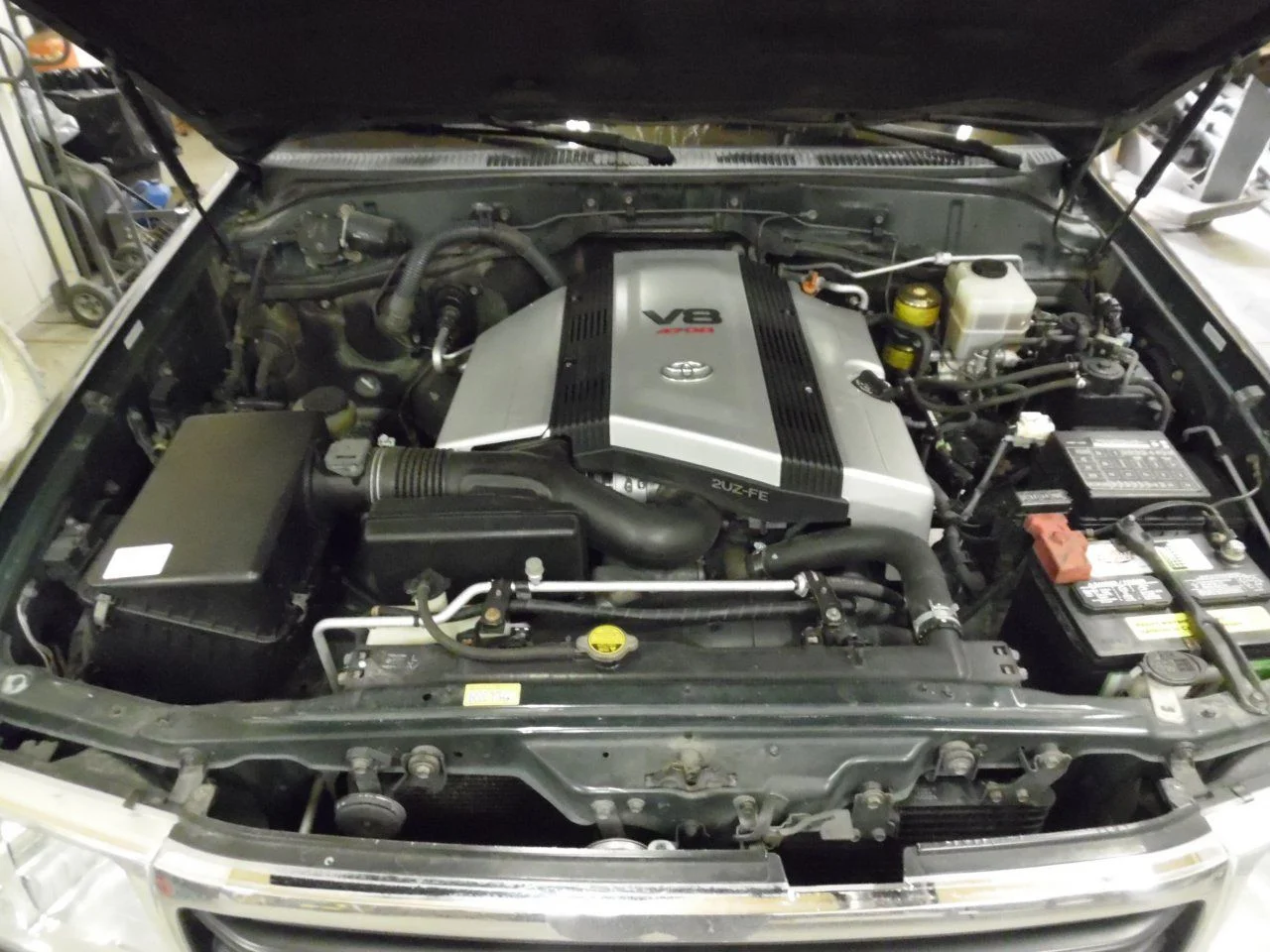

Removed the engine cover - mine (like many) has lost the anti-vibration foam underneath it over the years so in cooler death the cover often rattle at stoplights, etc. It's function is purely cosmetic, and now I never have to hear that stupid rattle again.
Agh... So that's the rattle!

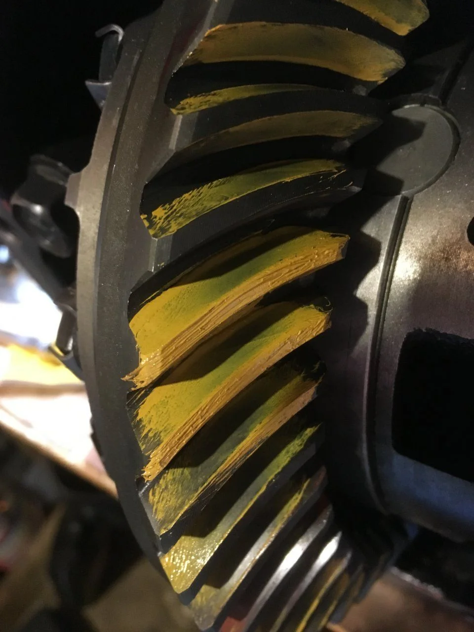

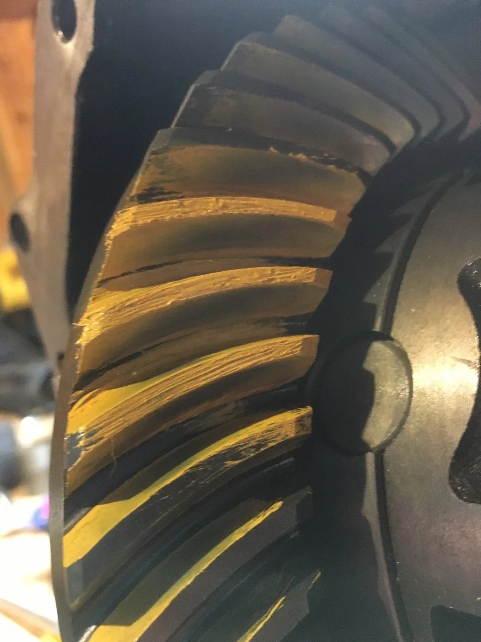

View attachment 1214704 View attachment 1214705 I was able to get my front end set up correctly once I had all the correct parts! I ordered a replacement 4.30:1 ring and pinion from Toyota since there are no others in the country currently, solid spacer, master rebuild kit and a OEM Toyota LSD carrier from @justdifferentials and a replacement 29 spline "companion" flange from Toyota also. Had to modify the pinion seal dust cover slightly to get depth set correctly. The staff at JT's was more than out going with a few of my dumb questions.
Looks like good mesh of gears. Nice job, you've got skills...
Thank you, I would probably attribute that more to luck, sourcing the service manual, and give or take putting it together and disassembling it more times than I care to share.
