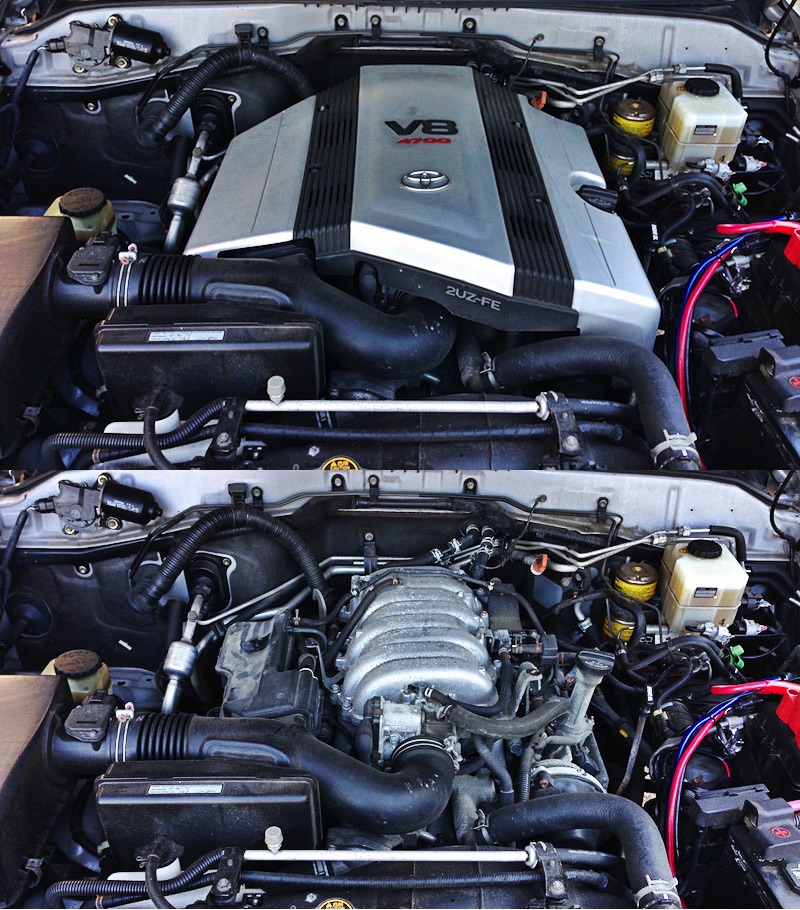

Did one of my favorite mods to date - before & after:
Timing Belt, Water Pump, Starter Contacts, Serpentine Belt, Heater Tees, And Valve Cover Gaskets. $$$...but it's running smooth and I think I'm in love with it again!

Removed the engine cover - mine (like many) has lost the anti-vibration foam underneath it over the years so in cooler weather the cover often rattle at stoplights, etc. It's function is purely cosmetic, and now I never have to hear that stupid rattle again.

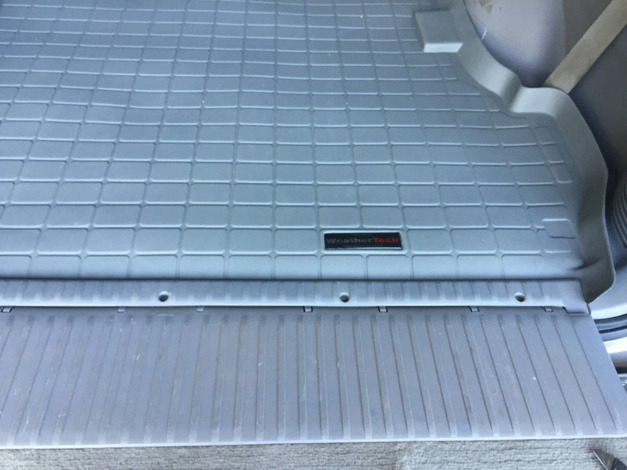

Cut and modified the WeatherTech rear mat. The dogs keep sliding it around so I bolted it under the tailgate cover trim.
Great idea! I was bothered by the flopping as well. Did this mod in 20 min. Much cleaner. Recommended.

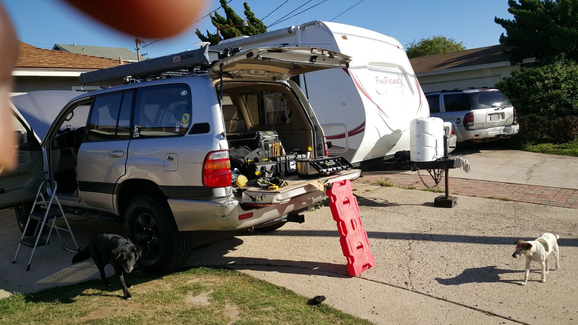

Set up ARB awning -- 2000 x 2500 -- Being that I had a half roof rack, I had to customize a bracket to make a third point for the awning to mount too. Originally, the roof rack was mounted using -- ARB Products 3713020 Flange Kit. I would have needed an extra base bracket but unfortunately ARB do not sell single pieces. I had to buy the whole kit again. I therefore will have 2 extra mounts -- Will only use two mounts, one on each side and mount a cross steel beam across them to have a place to mount spot lights and a solar panel. For the extra 2, am willing to sell them to anyone that could use them.
Programmed remote key -- I can now open and close the door remotely but the key can't start the car. Any takers on why that would be the case? @perrobravo
