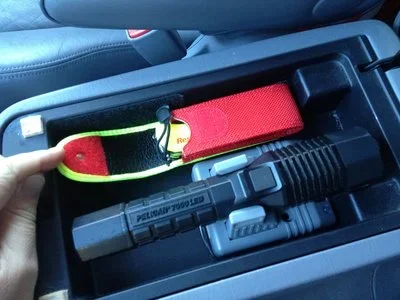

Sometimes it is the little things like some Velcro powered organization.
Don't forget about the bottom side of the console!
I can't, I have a cooler in there.
I'll join in.... See my build link for more. Pelican charger held by 3M double sticky tape.
Saw that this weekend and instantly added to a Amazon Wish List! :thumbsup:
I also keep my first aid kit (5.11 tear away) as well as a Maxpedition hook and loop holster that way. Lots of cool admin pouches put there as well for cords, tools, etc.

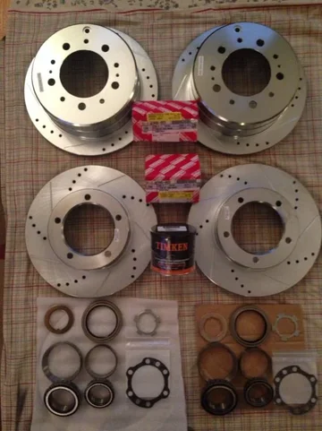

Four boxes of brake parts arrived just in time for me to be snowed in... Cruiser Outfitters wheel bearing kit is pictured along with a smoking deal I stumbled across for cross drilled slotted Power Stop rotors from Rock Auto ($240 for all four including shipping; one set was left last time I checked but price went up $100). I was originally not doing cross drilled slotted until I found this deal so we will see how they work out. I also got OEM Toyota pads from Beno after a little homework on mud from people complaining about the noisy Powerstop pads and also Slee apparently now includes Toyota pads in their brake kits. Ready for install as soon as I get a break in the weather here...
I don't run the Power Stop rotors. But OEM pads + drilled/slotted work fabulous.
I've used drilled rotors in the past on one of my fast cars. I liked them, but wasn't too impressed with the lifespan of the rotors. (I'm sure it couldn't have been my :steer:) I'd really be curious to know how well they work long-term on the LC.
