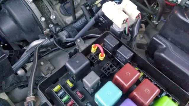

Wired my auxiliary 12v sockets to be always on. Has anyone ran a fridge from the rear socket with success?

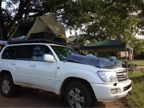

Finally mounted the EasyAwn RTT onto my new & improved Frontrunner RR, & took the family down to Great Zimbabwe for a long weekend before school starts. The kids slept through the night up top & we had a very comfortable sleep down below. Kids can access both through the sunroof, which is a problem when the front seats become the food storage, as the tend to step on everything, as well as up the half ladder...
The Castle on the hill can be seen to the right of the RTT in this next pic. Those ruins are incredible & like nothing else on the planet :) found a lot of pottery too
The suitcases we put onto the front of the roof rack & the RTT cover kept them dry, and there was only a very little rain enter into the back right hand side of the tent, most likely from rain bouncing off the Front Runner roof rack... Couldn't find any holes & the kids slept through a rainstorm... I got rained on through the mozzie net I hang over the back so looking forward to the GMC envoy SUV tent that is sitting in customs, hopefully that sorts the back out
How does one go about this? I've searched and cannot find, but want badly for at least one of the front aux 12v's to be hot all the time.

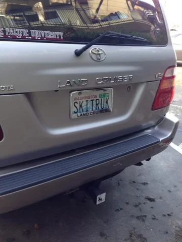

New plates! :) I had to and I know it's a waste but what ever...
Custom plate ☑️ = +5 hp
