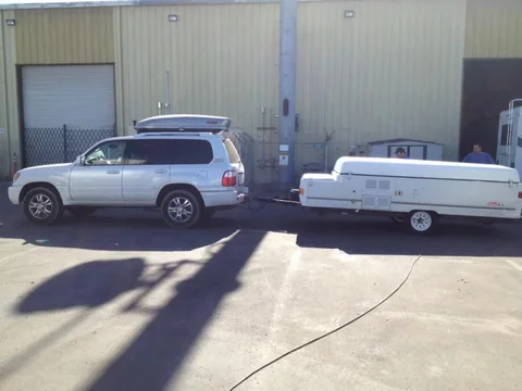

Taking my father in law, mother in law, wife, 2 kids, myself and all luggage that goes along with all those people on a road trip from Iowa to Arizona for a weeks vacation.

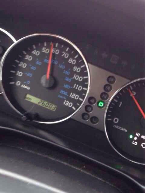

What were you running prior? I'm debating the jump from 275/70r18 to the 295's.... Wondering how much more it sucks wind when running them....
The biggest size I ran prior to this was 285/75-16. The set prior to the 35's was 255/70-18. Also ran the Tundra oem BFG rugged trail size. I think it was 270/65-18.
Essentially 32-33" tires.
Biggest issue is the trans ecu. Goes into OD at 1700 rpm in 3rd gear. I can still climb a steep long hill at 80 with a good start but I need a good start whereas before I could pull close to 90 up the same toll road hill.
I wanted a front locker anyway so might as well return the gearing to stock specs while doing it. 4.88's are perfect for 35's.

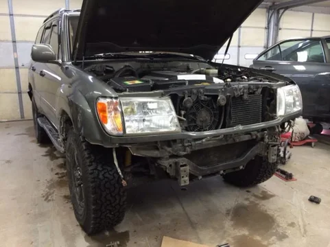

Installed my Sahara bar and hella 4000s yesterday. Didn't have time to wire up the fogs/driving lights and hellas.
Still need to decide on a winch, will take it apart to install the winch before our first spring trip, and also likely adjust the t-bars once I see how much the front drops with an additional 200-250# of weight. (bar, lights, winch, grp31 battery)

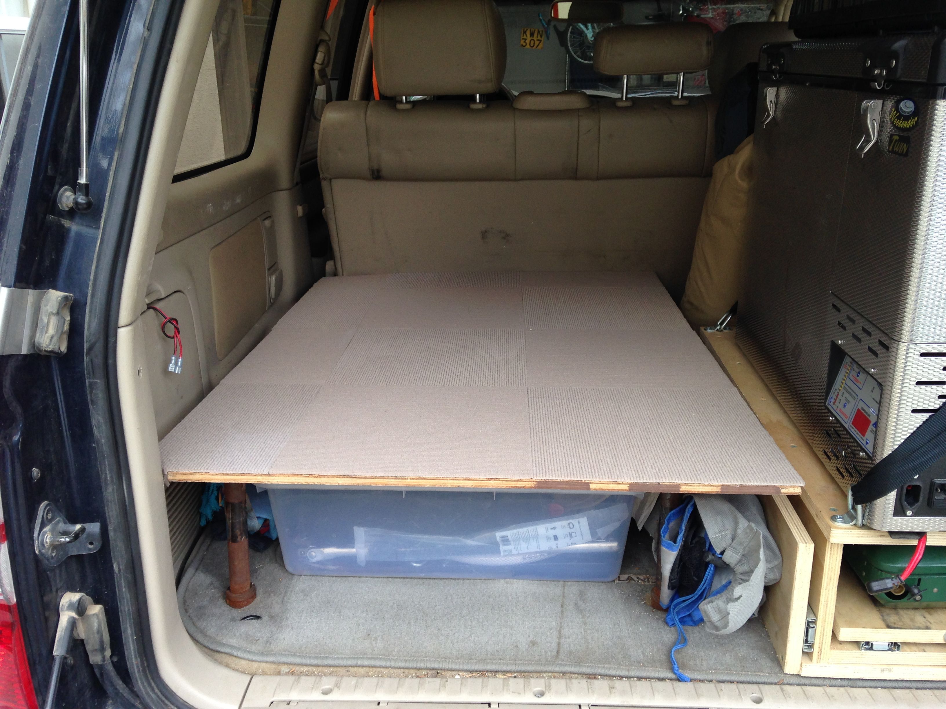

Put some cheap carpet squares on my cheap sleeping platform. Not super luxurious, but might save a puncture in the mattress.
