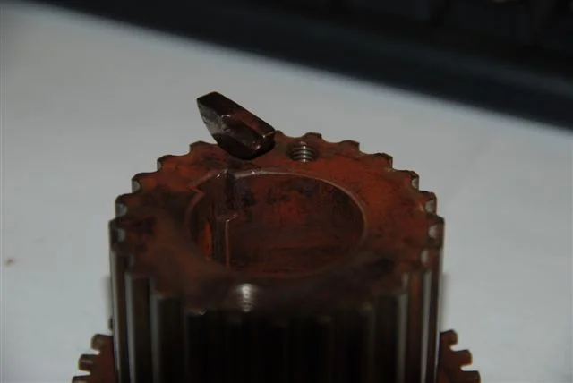

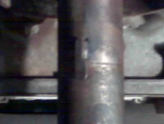

Well looks like the problem is a loose crankshaft pulley. Pulley and key worn pretty badly with the crankshaft thank goodness looking ok as well as the keyway.
So here is the lesson..if your 3.4L is throwing up a combined P0300, P0302 and P0305 codes this is a definite possibility.
Now I am wondering how common this failure is and why it fails? I think mine failed likely from an improperly torqued crankshaft pulley bolt. spec looks to be
184 ft lbs. Thinking this might be different now .... higher... ??

I'll take better pics and post them up.
