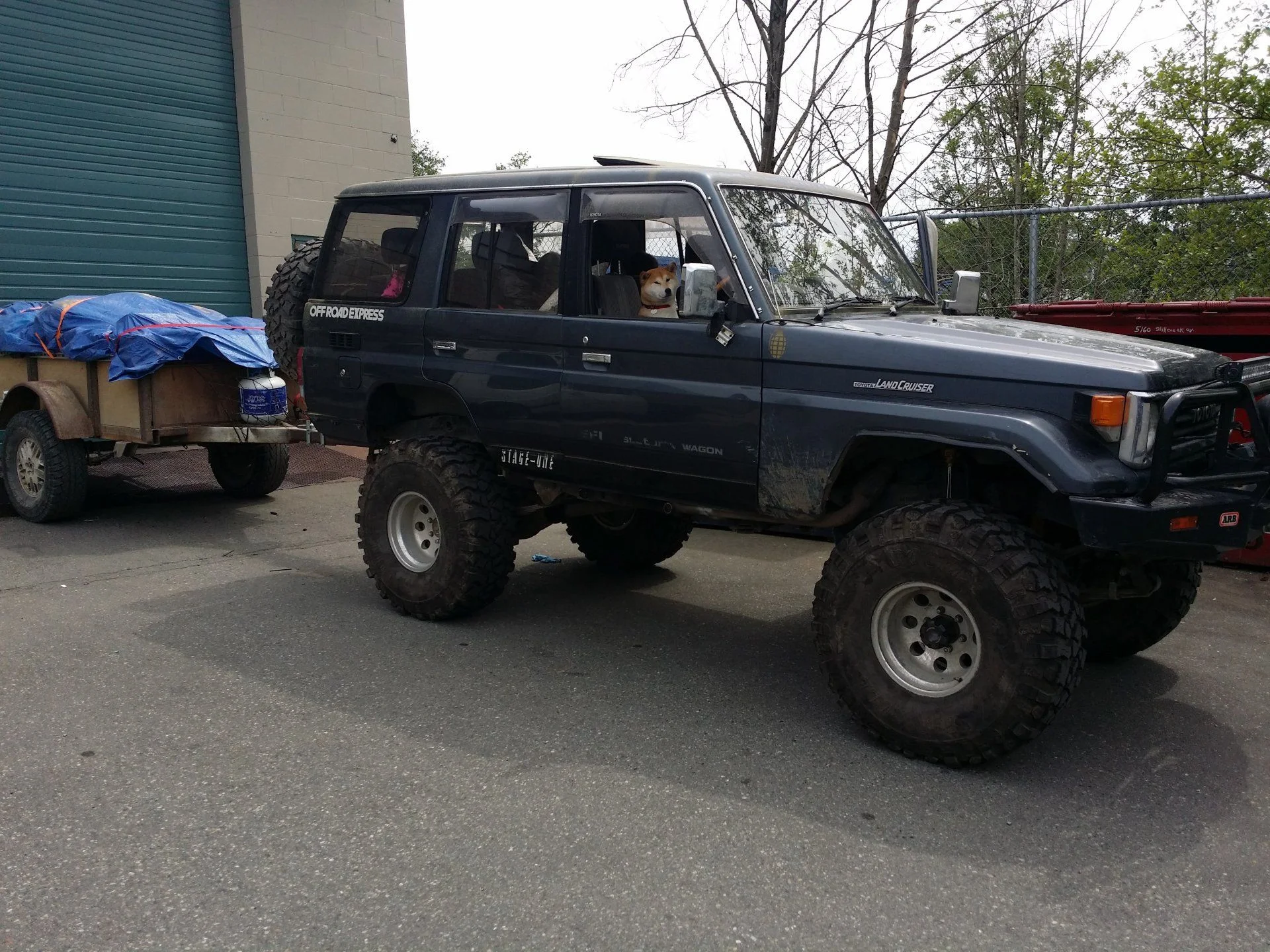

Going to swap out the fender inners to the 79 series style. The 77 is wider both in frame rails and engine bay than the 78 series.
Either way, I'm not going to be deterred by some cutting and custom. It's what we do everyday anyhow. Electronic headaches are my forte, as in my pic here I'm the idiot that put an Audi Engine in a a FJ40....
To my knowledge, the V8 models have a completely different chassis that is 100mm wider in the engine bay. How much wider is the 77 than a 78 series? Is that the 78 series troopy you are comparing it to?
Because the 78 series chassis was carried over from the 75 series and only modified to take coil suspension in the front.
What purpose would the 77 chassis have being wider considering it uses the same engines as the 75, 78, 79 series?
I have always believed the chassis' were all the same width, varying only in length until the V8 was introduced.
I'm referring the the LJ78 Prado series that was Japan only. Just like the HZ/ PZ 77 series that was also Japan only. I've got both in my stable. The 78 is quite a bit narrower at the front thus the square headlights.
The 77 series uses a heavy duty frame much like the 74 series does; also having leaf spring front and rear. It's likely similar width to the 81 series, but I've not checked. I've read about guys swapping them from the 200 series into 80 with only minor frame mods required and a relocate of the oil filter. I'm assuming/ presuming that the 77 frame, which accepts the HZ /HDT series like the 80s do can also accept the 1VD with these same mods.
