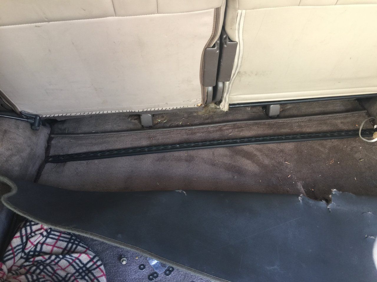

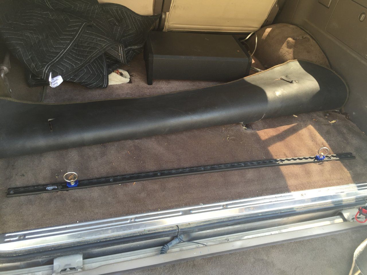

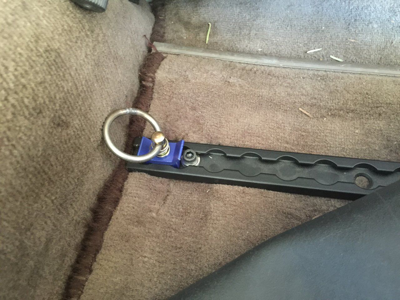

Finally installed L-track in the cargo area. Used the tie down hook anchor points. Turned out really nice, with the carpet over I can't even tell they are there and now I have flexible strap down point for the trips. Nothing heavy duty because lack of additional bolt down points but more than enough to keep the stuff I pack for camping(and fridge) from flying.
@Qball Do you not have the factory anchor points?
There are 4 factory anchor/hooks. They are rather difficult to use and never the right location. So with the track I can put anchor points just about anywhere, although the middle of track does flex due to lack of bolts securing he track but anywhere near the 4 bolts I used are quite strong. I am simply preventing things I pack to shift or jump wine I hit a big bump.
If I had more balls I would drill and tap the body every 6 inches for the pre drilled holes on the track so it's really secure.
BTW, since you have the same rack as I do I plan to install similar(beefier) tracks for the rack also. I'll post that up later this week.
Gotcha. I like those tracks. I used them a lot on the Tacoma racks I used to build.
