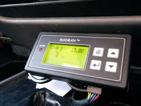

Looks great! Did you drill the manifold for the EGT on the truck? Where did you stick the display?
The instruction manual says to drill and tap the manifold with a cold engine idling. It felt pretty cowboy, just hoping that I wouldn't shred my turbo, and wasnt perfectly straight because of getting the drill into the tight space. But the exhaust gas blows all the swarth out as soon as you break through; nearly got some in my eye. Thanks oil patch safety culture for the safety glasses.
The display is mounted just in front of my shifter. I have a strip of Velcro around my old mechanical gauge mount and a strip on the back of the ems1. That I can can disconnect it and bring the computer inside (storage temp is -20°c, so I figure in the deep winter).IMG_20150302_174450.webp
You can kind of see it better in this picture..

I came really close to going with this setup for my truck. In the end I opted for dual Aubers + column mount EGT (I love being able to know EGT's at a glance), but the EMS1 is a nice package.
