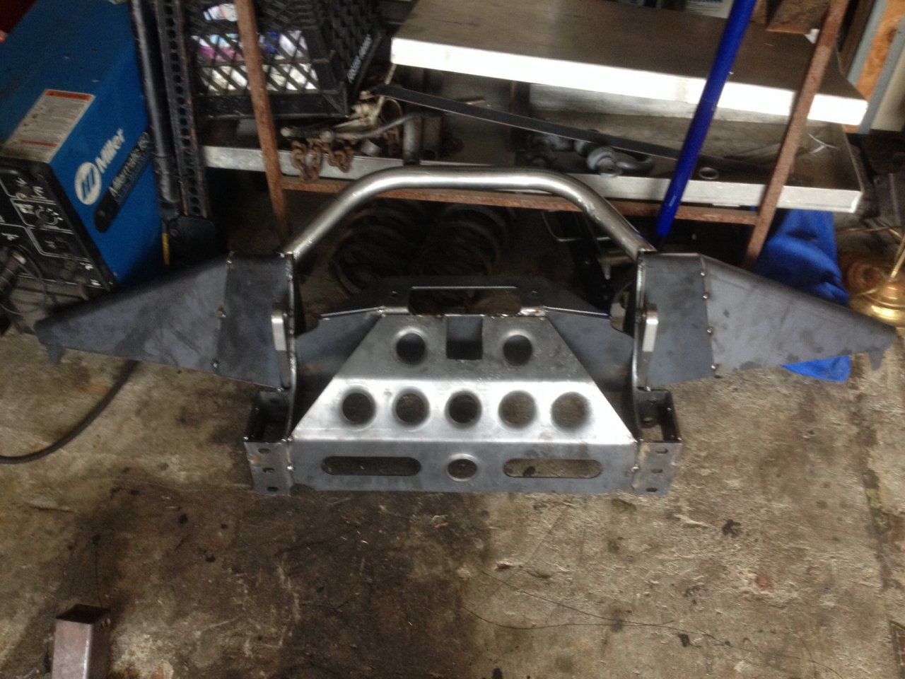

Finally got to work on my 4x4 Labs Front Bumper Kit.. Luke sells a great product and I highly recommend if you like the high and tight look. Tacked it all up. Nice thing is i have a 1" body lift to clear my 4BT/NV4500/Orion Combo so my turn signals are visible.
Finish Weld and Paint next week..
