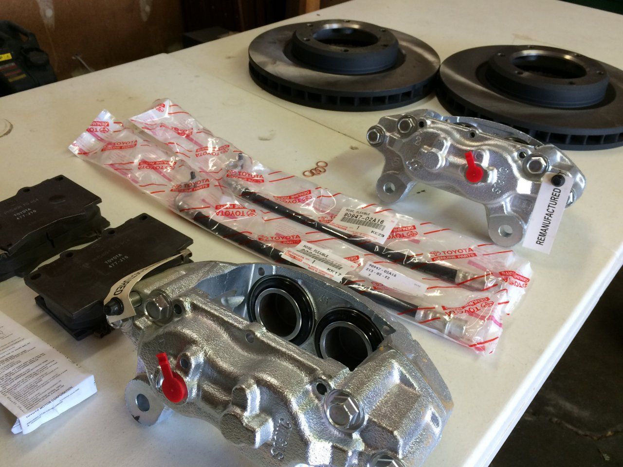

Spent the day yesterday doing @Dr Gil brakes. Tore everything apart on one side to get at the hub and rotor. Noticed that the other knuckle was a mess so I figured I'd look for my spare rebuild kit. It always seems stupid not to just go ahead and rebuild the knuckle if you have to take the hub and rotor off any way. Well I stopped there and decided to put together the new caliper and pads from @beno. Once I took apart his old caliper for the pins and hardware I noticed the thickness of the pads, 5mm. What's min you may ask? 1mm. Ugh. I go and check the rotor, 31mm. What's min? 30mm. Ugh. This dude is fine. Caliper compresses fine. So I take a look at the other side. 6mm on the pads and 30.8 on the rotor. Dammit. Call Gil and we agree, just put it all back together.
Checked the rears, well within spec. Hmm, why am I doing this again? Turns out we just heard what we thought was the wear sensors scratching the rotor and just jumped on it. Totally unnecessary. Oh well.

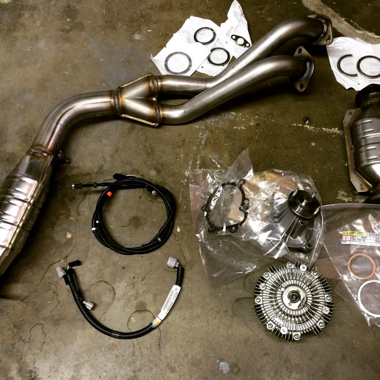

But now it's my turn. FlowMaster exhaust which I need to VHT first plus I need to drill the hole for the EGT probe. All new OEM gaskets and exhaust hardware. I'm sure I will be fine but fxxx it.
Finally going to take the time and drain my coolant for the umpteenth time and install new OEM water pump, @landtank fan clutch (Orange hub) and reinstall the shroud.
Then of course replace my accelerator cable since mine sticks at WOT.
