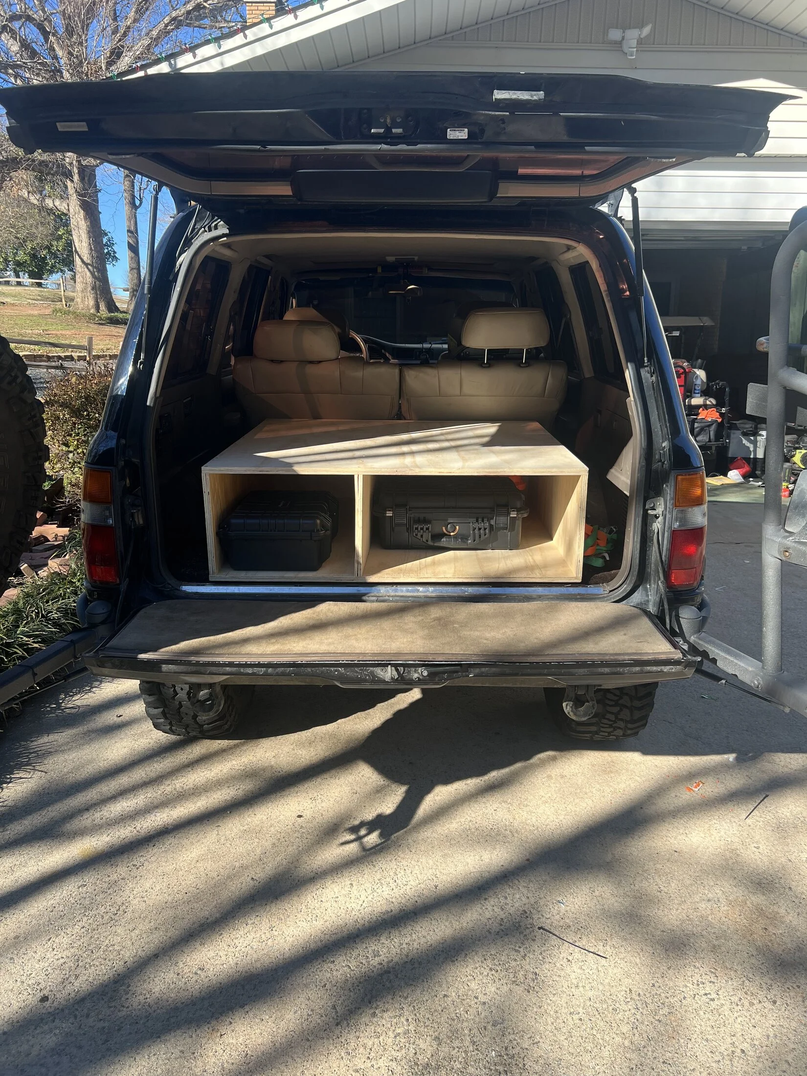

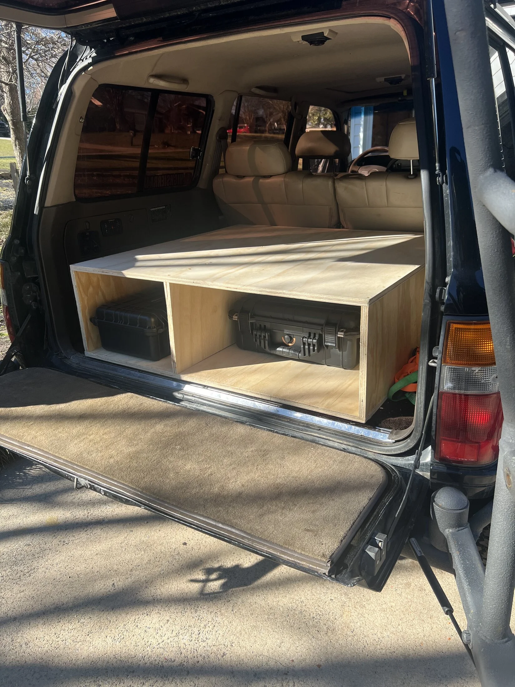

Stated a rear drawer set up

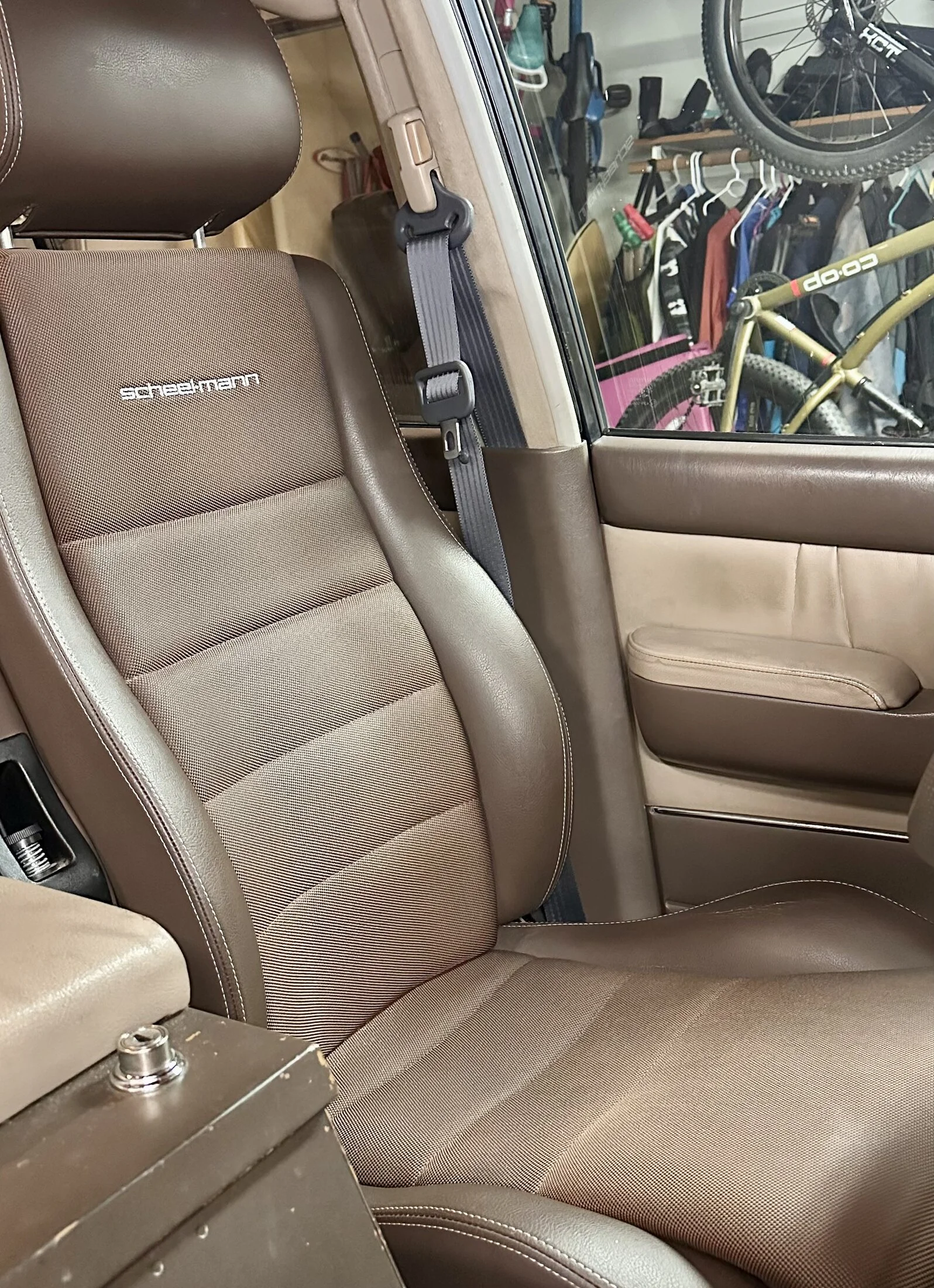

Thought I got lucky with an obscure Lexus dealer whose website said they had an oak driver seatbelt. So I ordered. It was blue. 😐oh well. Maybe I’ll send original that no longer retracted and keeps getting shut in door to safety restore. I don’t mind the blue tho!

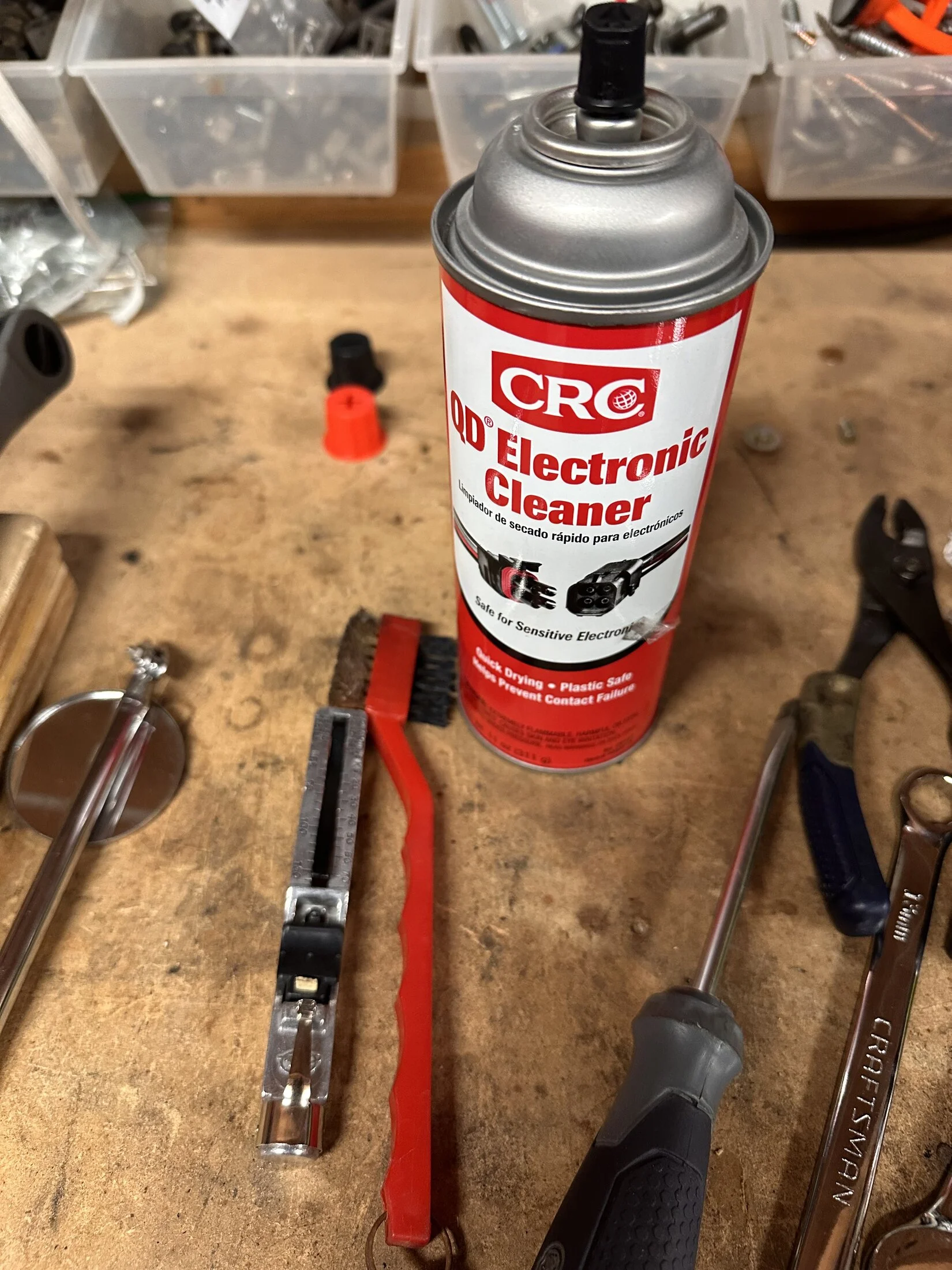

Also the red battery light on dash popped up after new alternator instal. Oh no, a bad one out of the box? Rabbit hole of something else? Turns out that the 3 prong plug that plugs into alt was full of gunk. Oil, ps fluid and watt ever else spills on that plug. A brush and flush and no more light. PS- what’s with CRC cleaner being $10/bottle!!
Lastly, these are my favorite tools ever.

Also the red battery light on dash popped up after new alternator instal. Oh no, a bad one out of the box? Rabbit hole of something else? Turns out that the 3 prong plug that plugs into alt was full of gunk. Oil, ps fluid and watt ever else spills on that plug. A brush and flush and no more light. PS- what’s with CRC cleaner being $10/bottle!!View attachment 3840300
That belt clashes bad with those seats. I’ll do you a favor and take them off your hands.
Should be easy to confim by part number, blueish grey number ending with B0 and oak with E0.
Replaced mine recently as well since cleaning/washing them didnt help much. Not cheap, like 250$ at the local dealer but glad they were still available.
Yup. Been looking for an E0 forever. Website said they had one in stock. when it arrived, alas, it was a B0. Suppose I could return it, but it’s my dd so I done care.

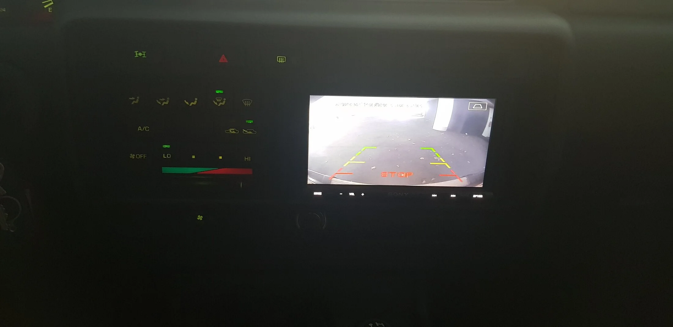

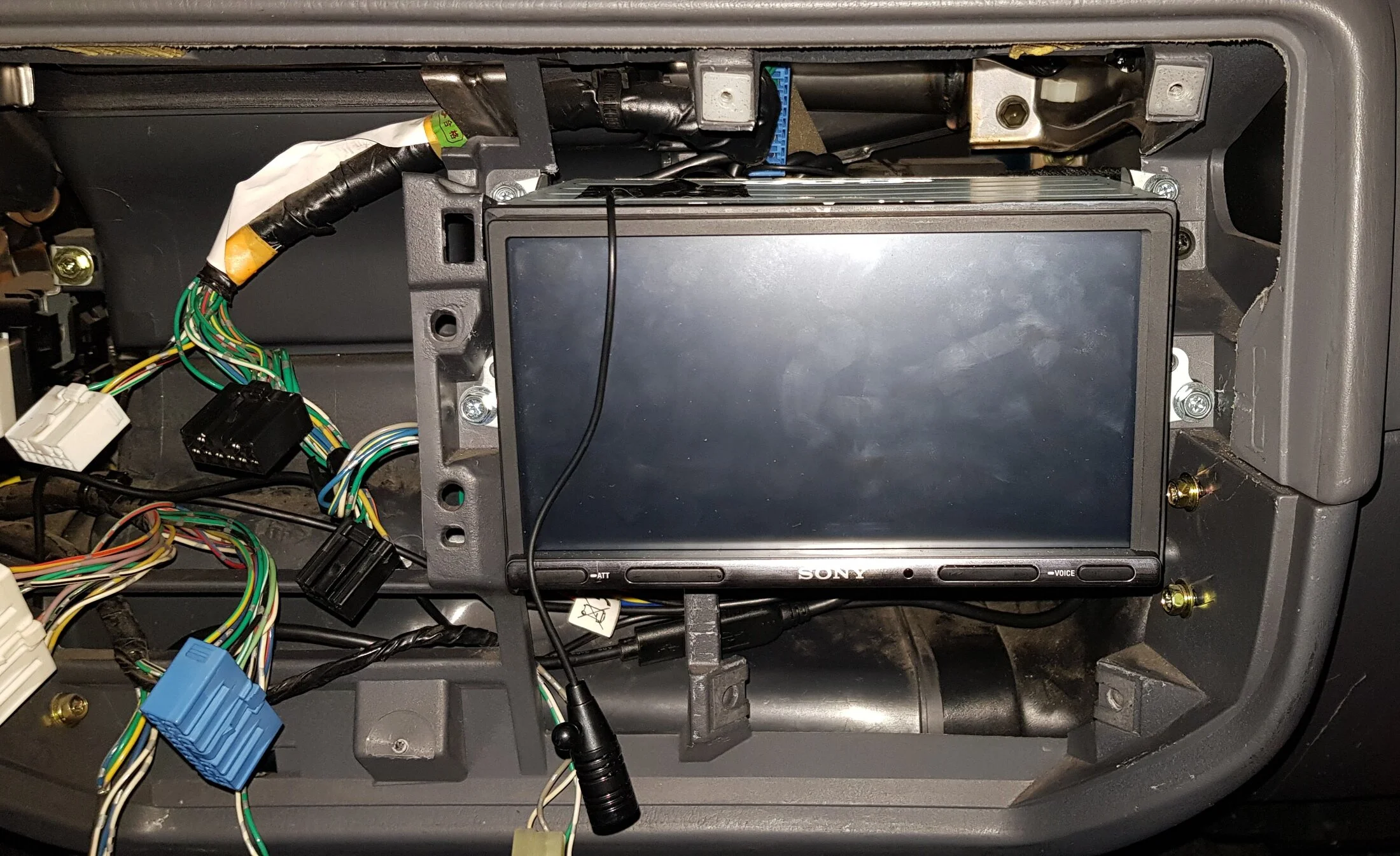

Finally finished a little head unit project, now with modern connectivity, maps. spotify etc. instead of the 20yo single din unit that was installed in the car when i bought it. Opted for a medium level Sony unit with Carplay/Android auto.

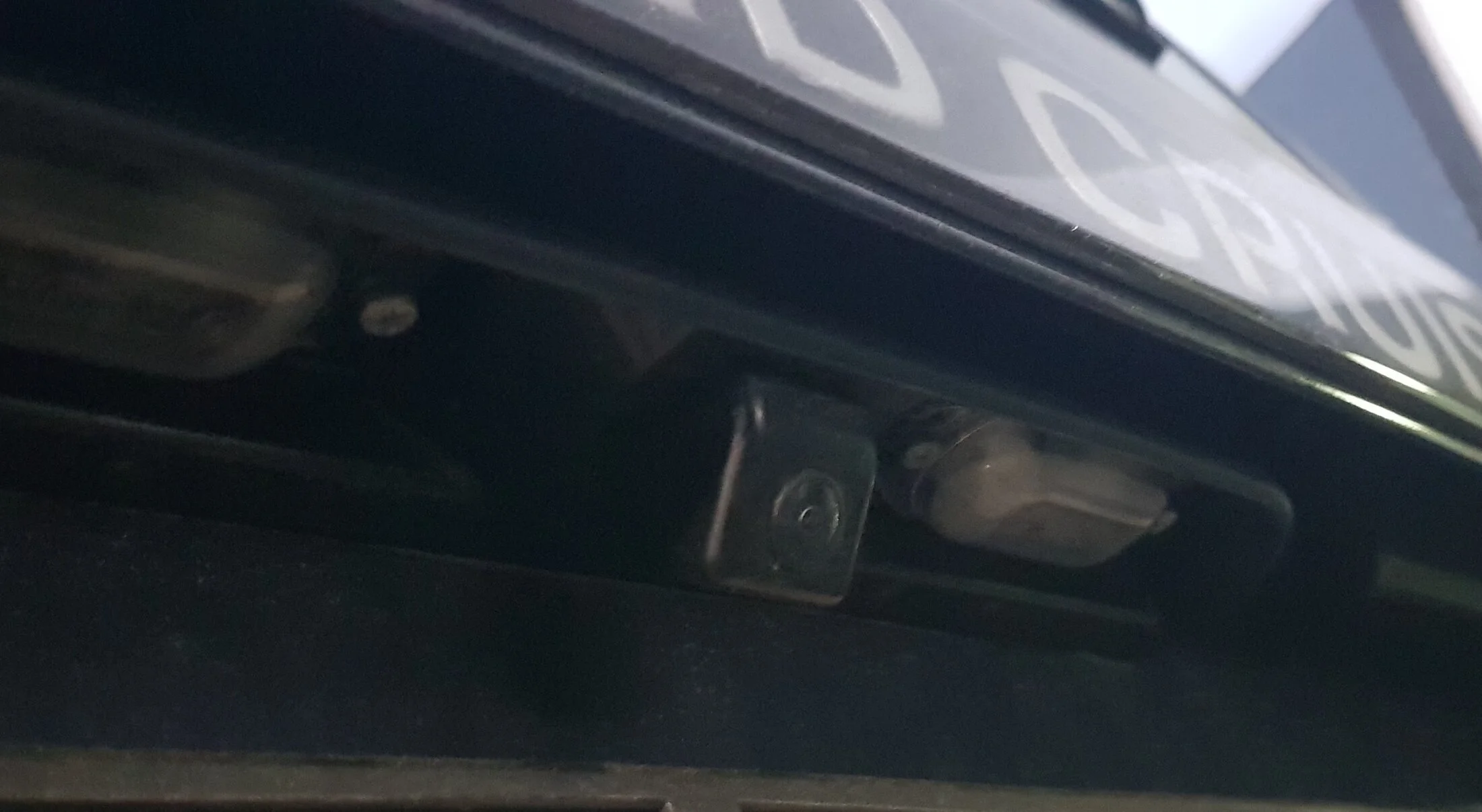

Backup cam in license plate lamp housing

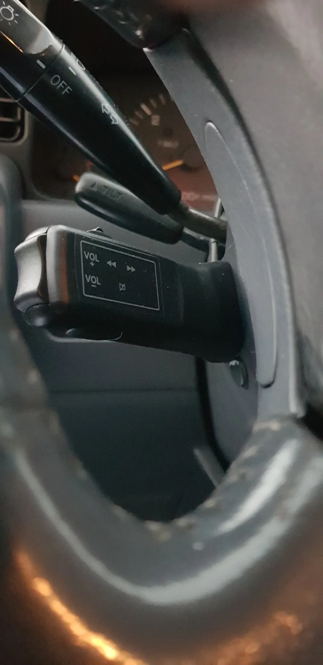

Found it quite distracting to control the head unit while driving due to the dash layout in the 80 series so i was looking for a simple way to install some sort of steering wheel controls. Decided to install this type of control stalk which makes it much easier to focus on the road.

Where you get that stalk and how does it mount?
Found it on Amazon, i think its called "Rearmaster steering wheel remote" or something like that. Mounted it with the 3M pad and 4 screws from the inside. Connected to the head unit remote input using a 3.5mm headphone jack (depends on the HU), black has to be connected to ground (shield) and red to one of the two stereo channels of the jack.
