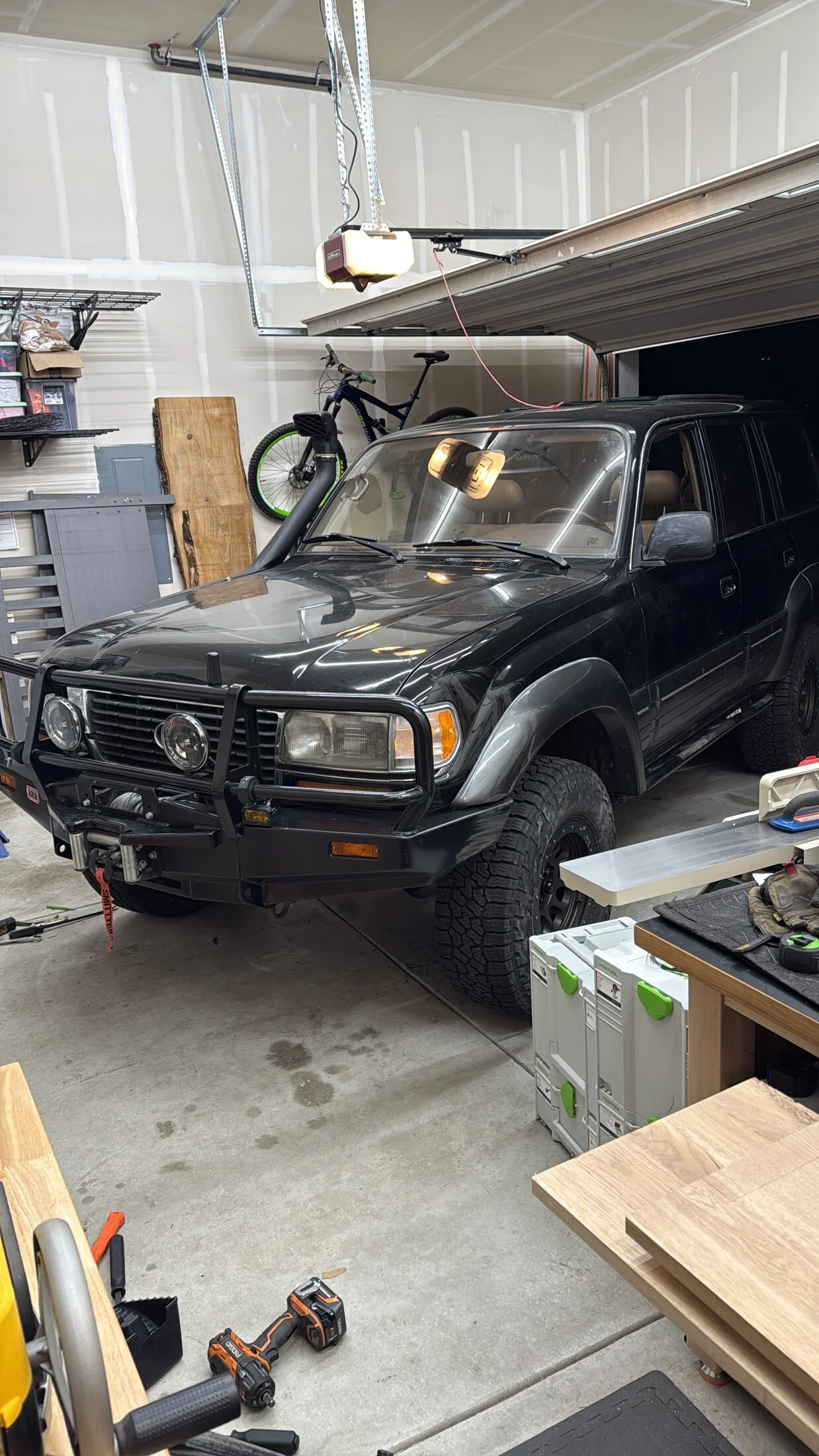

Got it back yesterday from @torfab , since there was a bunch of small stuff (and some not so small) that needed to be done that I didnt have the patience and/or time to do it.

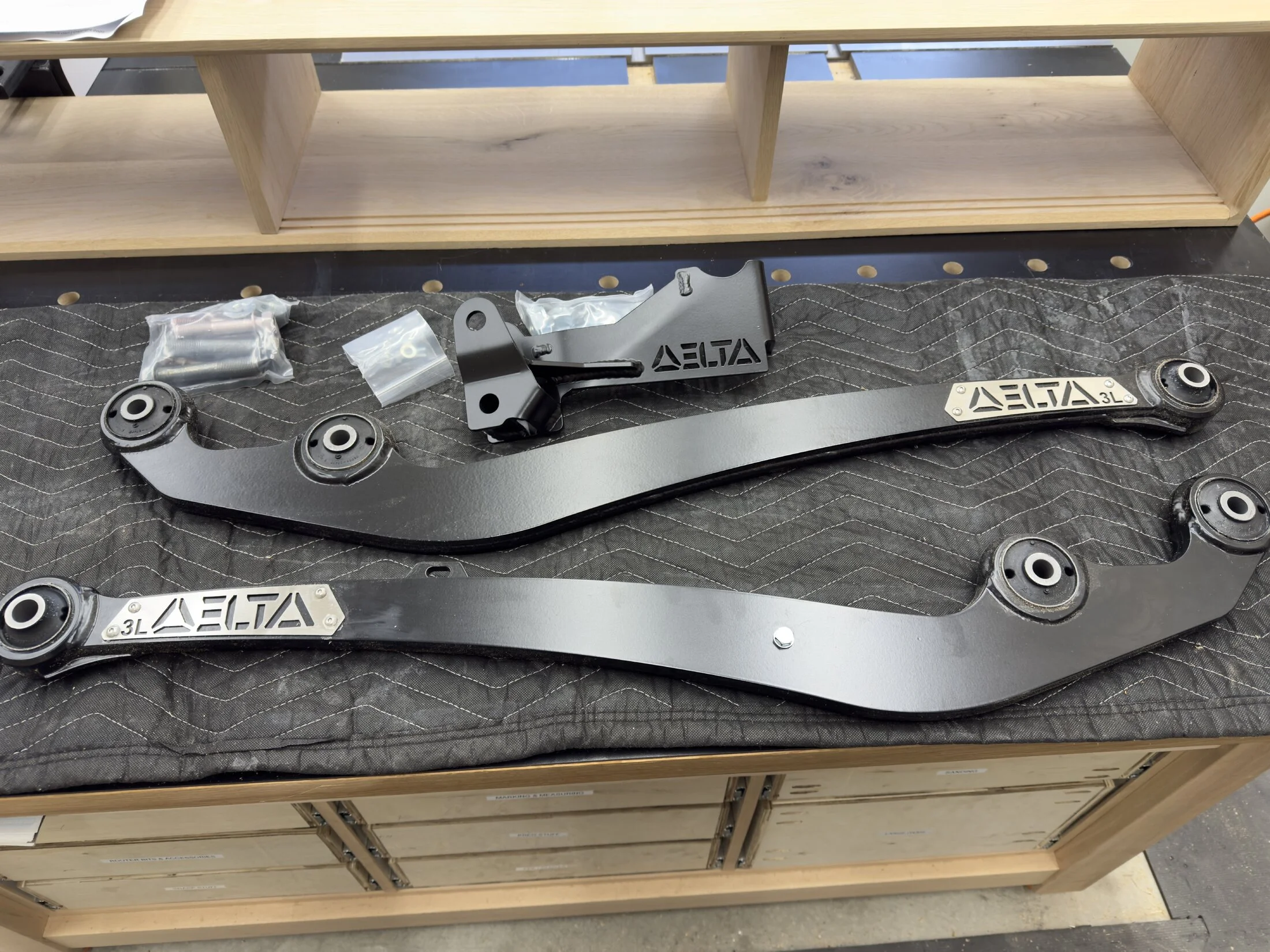

And today the brown truck dropped off some goodies from @Delta VS
Im excited to get it installed!

Dollar for dollar those two upgrades (radius arm and panhard bracket) made the most significant impact on my 97 LC. Drives like a factory truck.
That is what everybody says, so Im really looking forward to it. Specially now that the 80 is back into daily driving duties and my wife will be driving it more often!
Combo it with whiteline rear sway bar and use either LCP/Landtank drop bracket-your golden.🤘
damn it really? i was waiting to get the full kit to get these
Agree on the radius bars and PH bracket. Their springs are decent, but I’ve been disappointed in my stage 1 shoxs. Think there are better options on shox for similar $$.
[Edit: I should have been more specific to the Icon springs and shox… the Delta parts of that kit are top notch. ]

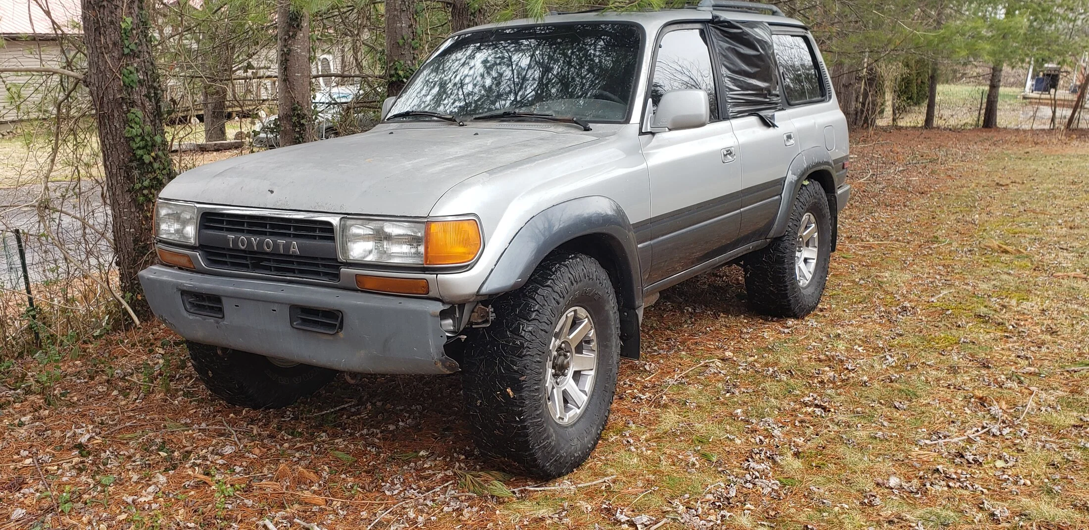

Brought it home:
Its been 15 years since my last 80 series and 10 since my last LC..
Was trying to hold out for an FZJ but couldn't pass up a clean body 3FE powered one.
Had to do a tire upgrade to unload and can confirm worn 37x12.50 tires fit on a stock height FJ80 (take offs from the crawler..)
Aptly named "Jolene" based carvings in the passenger side doors.. apparently the previous owner had a proclivity for pursuing otherwise married men.. 😅 based on the gouges through to steel and the jagged shapes.. something about a woman scorned...
Need to get it idling, shifting and see what 273k miles of debauchery has inflicted on it. Its future life should be a bit more family friendly 😄

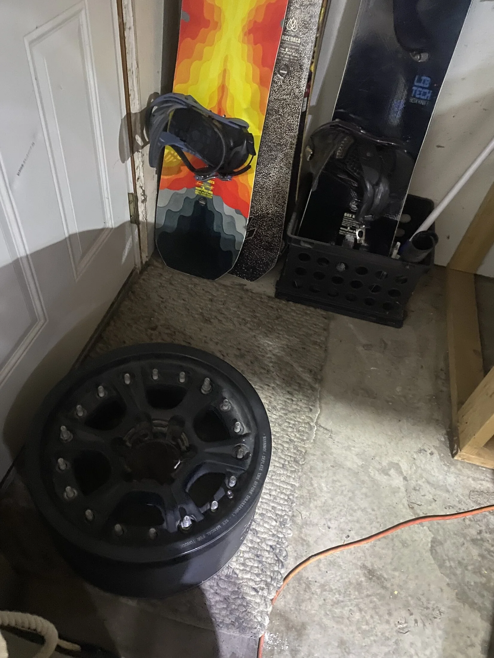

Nice! I had a set on my 100 back in the day, it was such a great wheel.
I am pumped have wanted a set for about 10 years, should bought them then when they were cheap, found some over on the front range and snagged them. Quick question on the main Oring did you change it every time or just when it is torn or damaged?
I just bought new O-rings when I got the wheels (I bought used) then kept the old O-rings as spares. I had no problem reusing them when I changed tires, never actually had to use a spare.

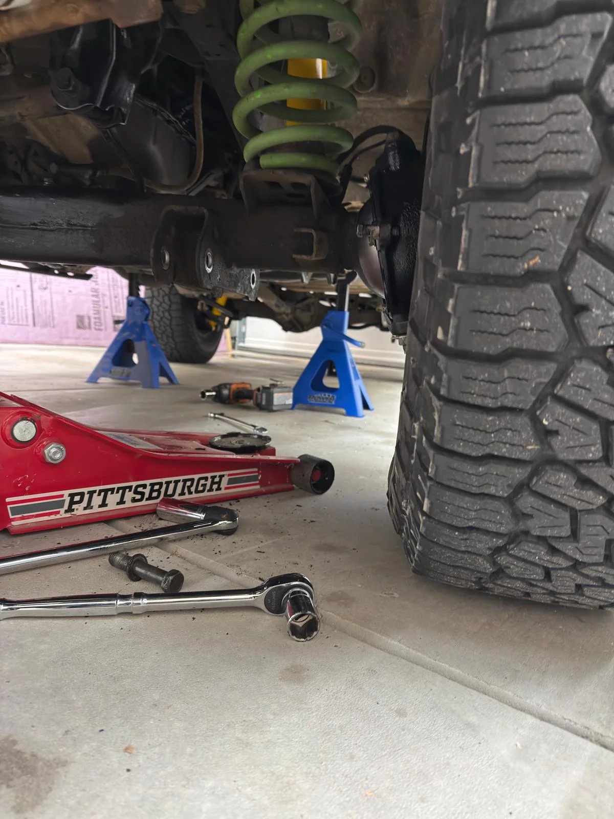

And Delta arms are in!
Not to bad if a install, except for getting the bolts torque’d to 130ft-lbs as I was laying down on my back
The panhard bracket totally different story, it put up quite the fight, and it was getting late, so I just waked away from it and Ill get back at it in the morning.
For those of you that done it in a garage, any tips or tricks to get those bolts lined up?
Also, not excited to torque those bolts 😅😅
