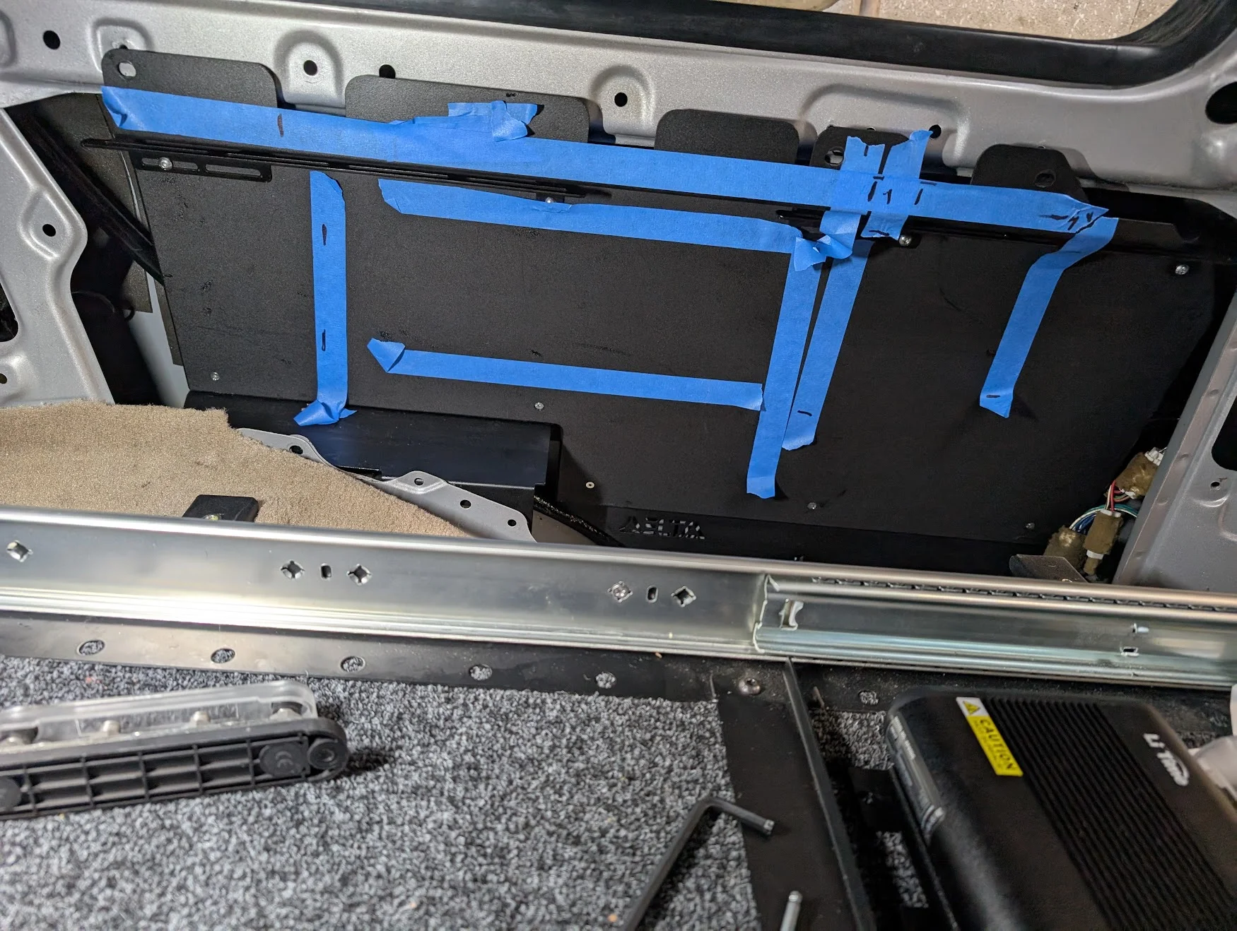

Installing DeltaVS QPM. Blue tape locates the cubby on the LX450 trim (left), and where I want to put an external switch panel (right). I am putting the fuse panel behind the cubby door for access, as well as one end of the DC to DC convertor. It has buttons to change modes, and initiate charging the starting battery.
Rivnuts going in. DeltaVS use much nicer rivnuts than what I use.

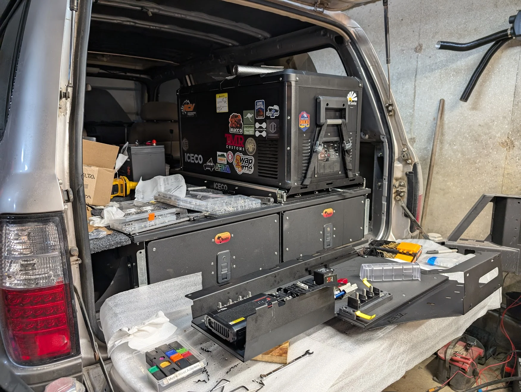

Pulled it back out to install the DC to DC converter, fuse block, and fuse panel, and 120A relay (triggered by ACC).
Blue Sea components, and LiTimes DC to DC Charger/MPPT and LiTimes 12V 100Ah battery.

Installing DeltaVS QPM. Blue tape locates the cubby on the LX450 trim, and where I want to put an external switch panel (right). I am putting the fuse panel behind the cubby door for access, as well as one end of the DC to DC convertor. It has buttons to change modes, and initiate charging the starting battery.

Looks great. Do you have a link to the LiTime dc-dc/mppt unit?
