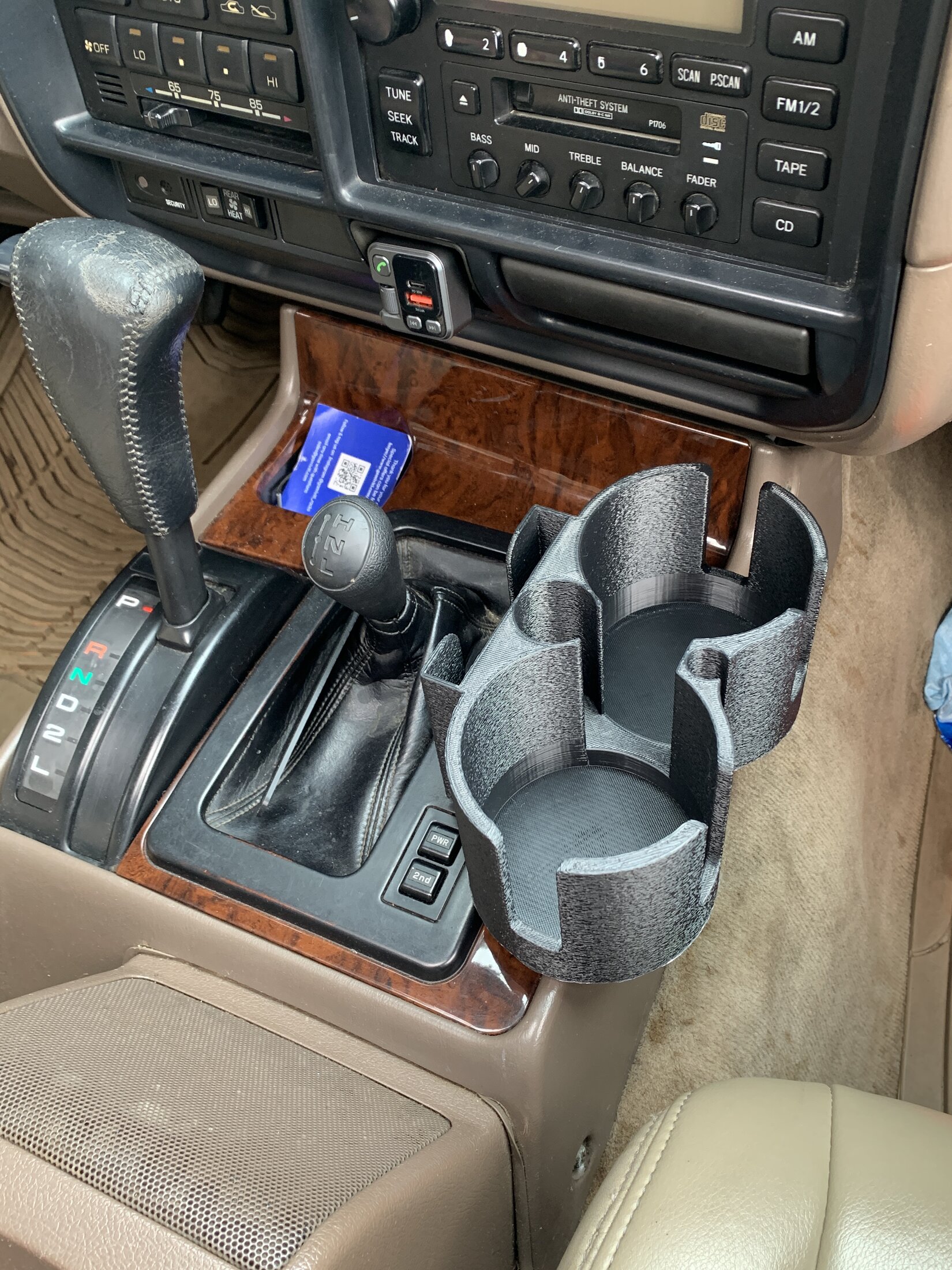

I printed the same one :D here’s mine. I’m reprinting soon with a beige filament and dialing in fuzzy skin instead of winging it.
I printed a base plate (drawn in white) to clear the lip on the side (is that LX specific? idk) The placement seems spot on - haven’t had any complaints from any passengers.
Attached with strips of this 3M tape with no problems yet
edit because the pictures don’t show it: I lined up the outside right angle of the phone holder to sit slightly outside of the PWR button. Perfect dimensions from the guy who designed it IMO

That's super helpful to see, thanks!! For some reason I was struggling to find a decent picture of how somebody got it to fit on there properly with the lip of the console coming up a bit. I did consider making some sort of base plate to make it level so good to know it's a decent solution. Slowly but surely getting into the 3d printing hobby so I'll take any excuse to draw something up from scratch

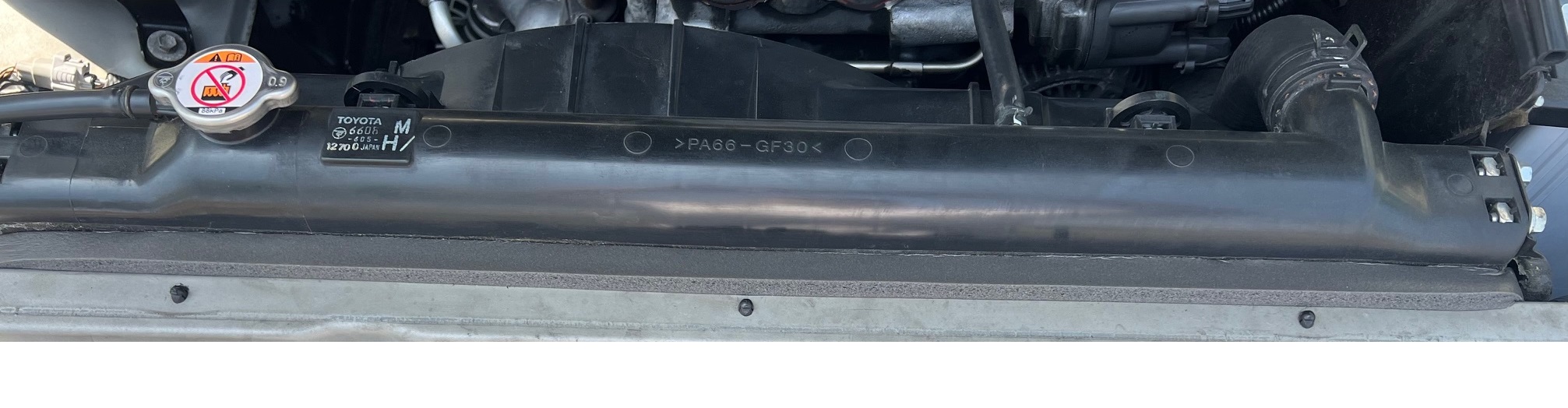

I also needed a new Foam Strip for the gap between Radiator and Radiator Support. Went to Home Depot and Bought High Density Rubber Foam and it worked out Great. Cant Remember the Size I purchased, I had an old piece to go off of but should be easy to determine the size when you see it in person.
It’s super fun, we got ours in december so I’m pretty fresh too. Being able to model even basic stuff is super handy. I’ll try to find the few 3D printing threads we have on here and edit with some links
Please forgive my ignorance but why is this important?
The seal between the rad and the engine compartment to make the cooling system more efficient
Is this the seal between the engine fan shroud and the radiator? Until now I had never heard of that.
Yes. The OEM Rad came with the foam. Not sure if they still do.
Not quite. The foam on the OEM radiator is on the side forward of the shroud. It is where the radiator marries up to front frame and stops air escaping around the radiator sides. Foam on the shroud side would be pointless as any air will have already passed over the radiator fins.
Read post #72,804. We are talking about the gap. Mine came with the foam from the mfg.
