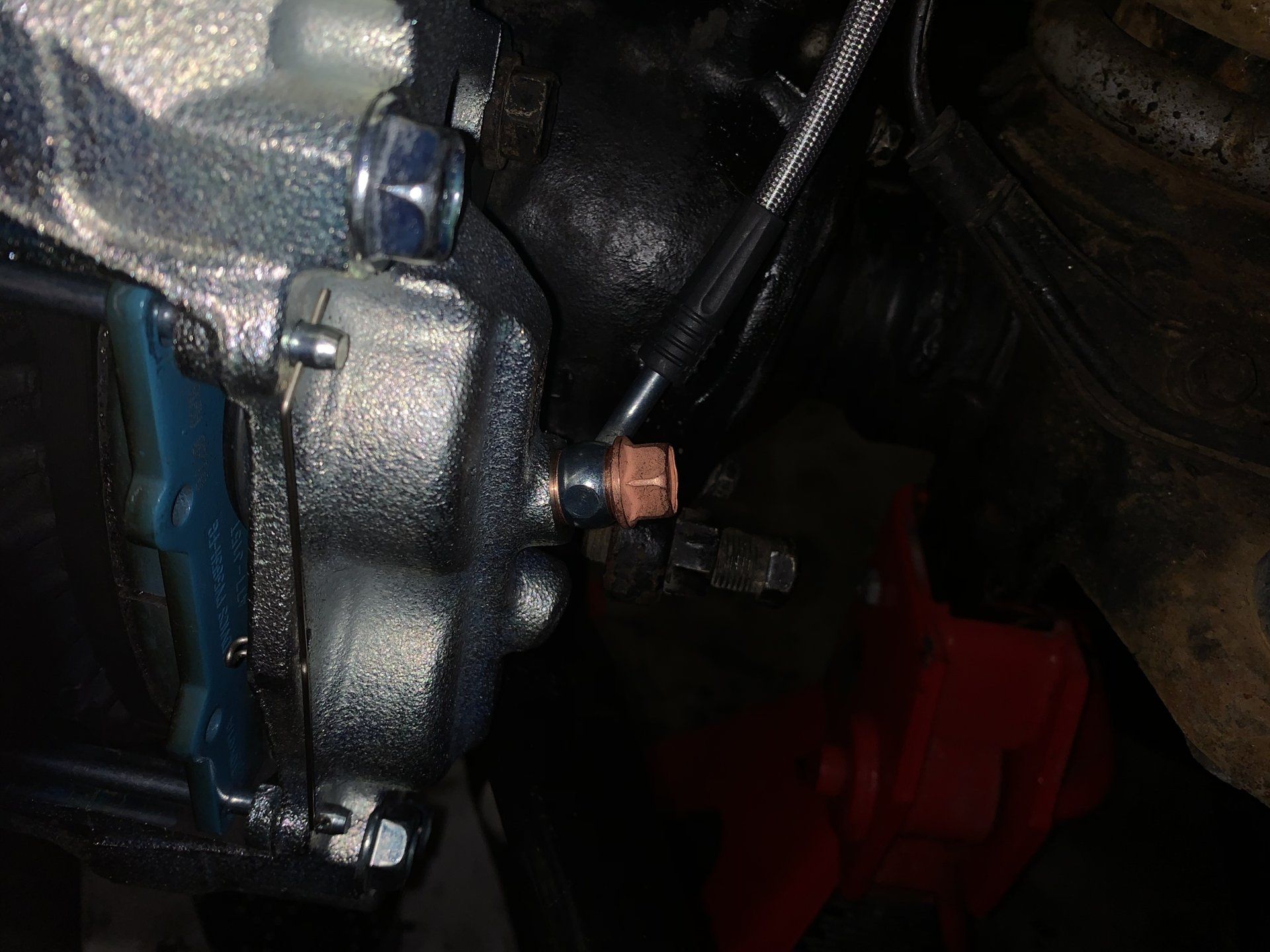

The hydraulic fitting on the 4Runner caliper shares the same thread pitch and size as the 80 caliper M10x1.0. The 4Runner typically uses an inverted flare fitting, with a hard line coming right off the caliper. This does make servicing a 4Runner a pain and some guys have converted to banjo bolt soft lines...just like the 80 has.
The OEM 80 banjo bolt is just a hair too long for the ;runner caliper. With an extra copper washer it fits fine. I opted to shave 2 threads off the bolt instead...took all of 5 mins to cut and clean up.
