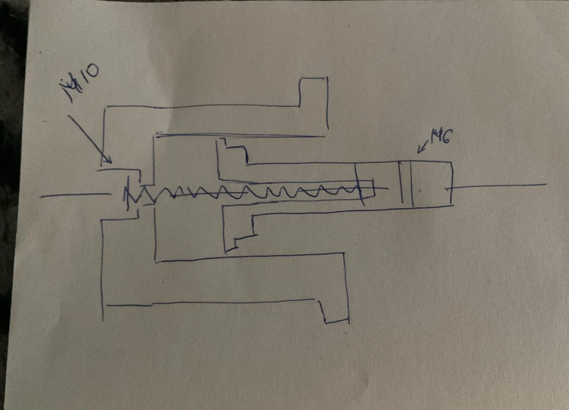

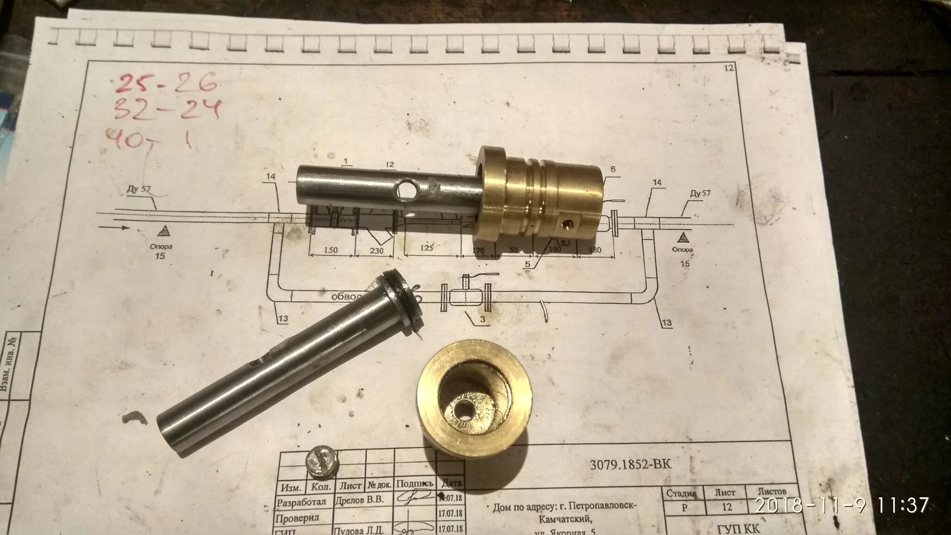

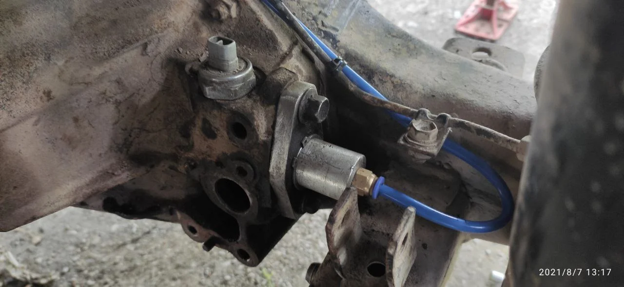

What a fantastic build! Did you make those air cylinder locker actuators yourself or did somebody make them for you? I bought some air actuators when I did my rear locker and they are pretty big. I would have liked to have something more like the ones you have. Great truck!
I make it myself. Tension spring inside. Fist time I’m using o-ring, later change it to hydraulic cuff from main brake cylinder.

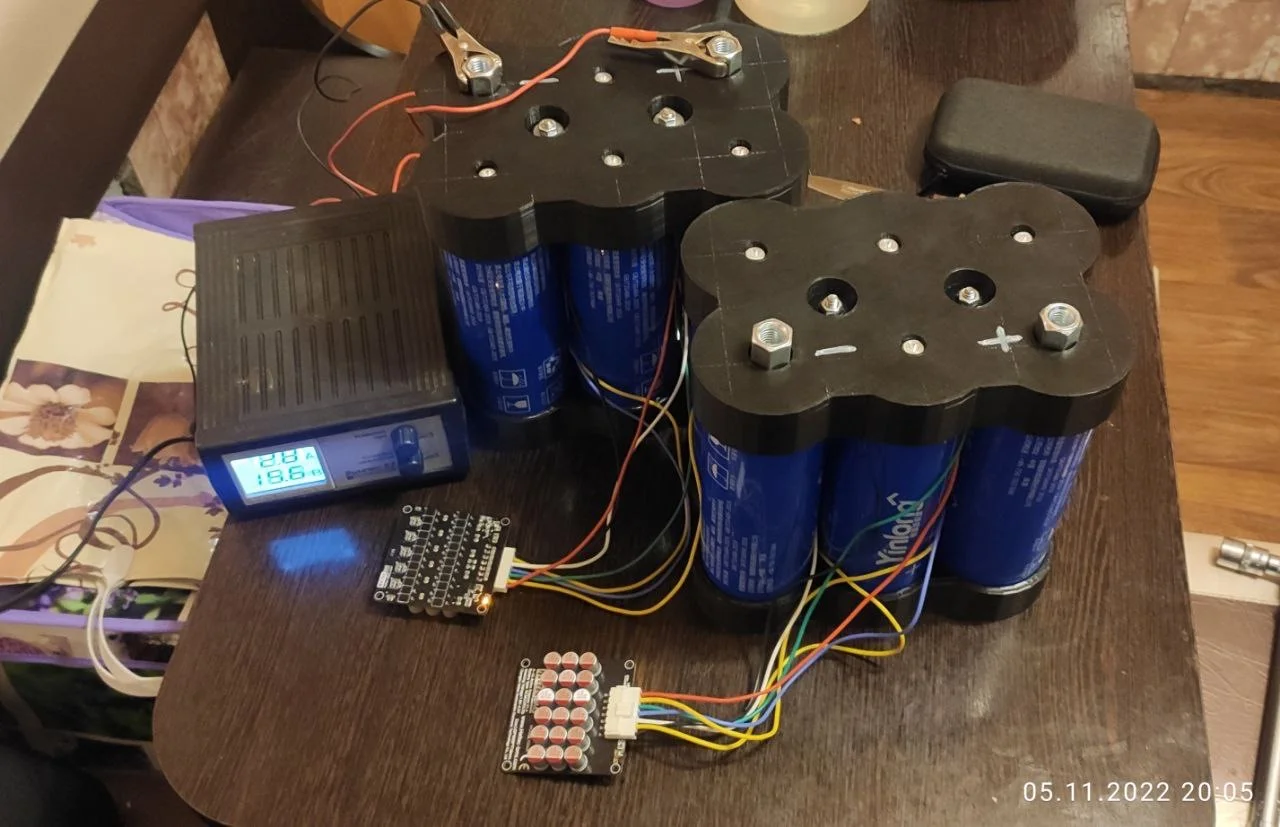

Why do you need so many cells? 40Ah LTO same as 90Ah regular battery.

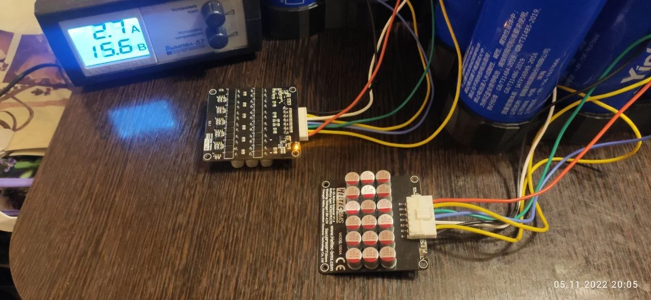

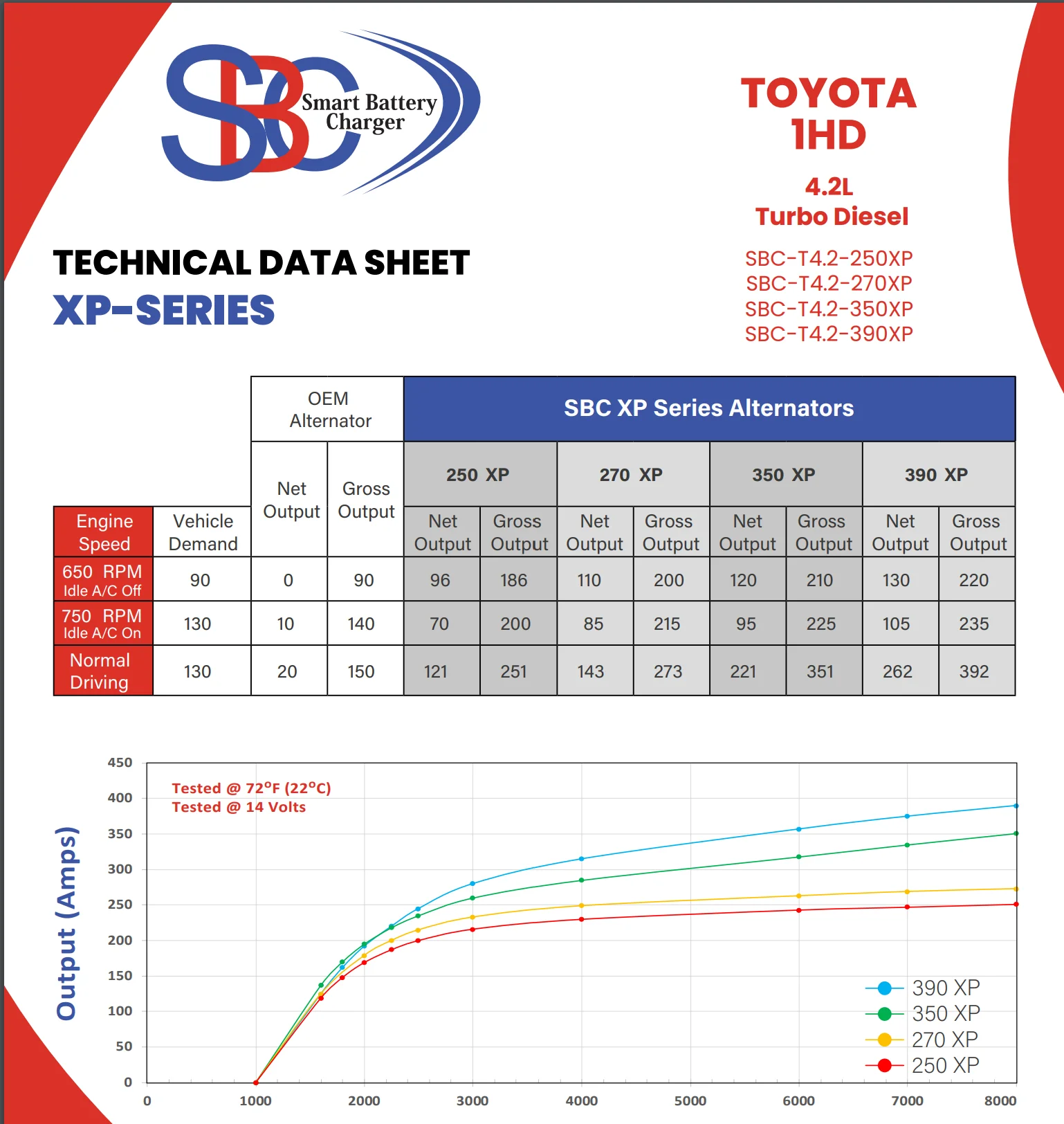

Diode on alternator S line rise up voltage for better charging. Also you need BMS controller. The LTO section can be charged with a current of 6 capacities, can your alternator gives this?

I believe my alternator can handle this with the S-line diode. and yes a BMS is a must do you have a link to which BMS you are using?
I have the 390XP alternator here are the specs

do you have a link to the BMS controller?

Air locker conversion!!! I love this. You could possibly sell conversion kits. A++++
It’s very hard to send it. But if you need, I can. 499usd/kit

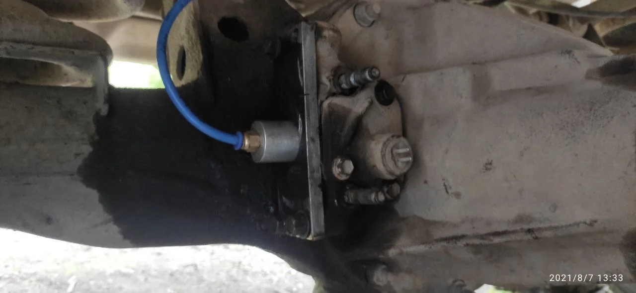

I see those air locker actuators are a little different than the ones you took pics of back in 2022. The ones above have the air fitting in the end but the earlier ones have it on the side where it seems like it'd be out of the way? Why the change? Was there an issue with the side port of the earlier ones? I really like your setup better than the cylinder I bought.
Oops, I just went back and saw the ones above are from 2021 and older than the 2022 pics a few pages ago. Was this a first version then?
Your rig is fantastic!
Older actuators just have one more hole. one extra hole, one extra plug

have you tested your LTO cells, I've been told that some yinlongs are 40Ah cells inside a 45Ah label. so I'm kinda worried if I were to order from Aliexpress
purposely labeled incorrectly?
if you have a legit source for actual 45AH cells could you please share the link maybe a legit seller on Aliexpress?
thanks
