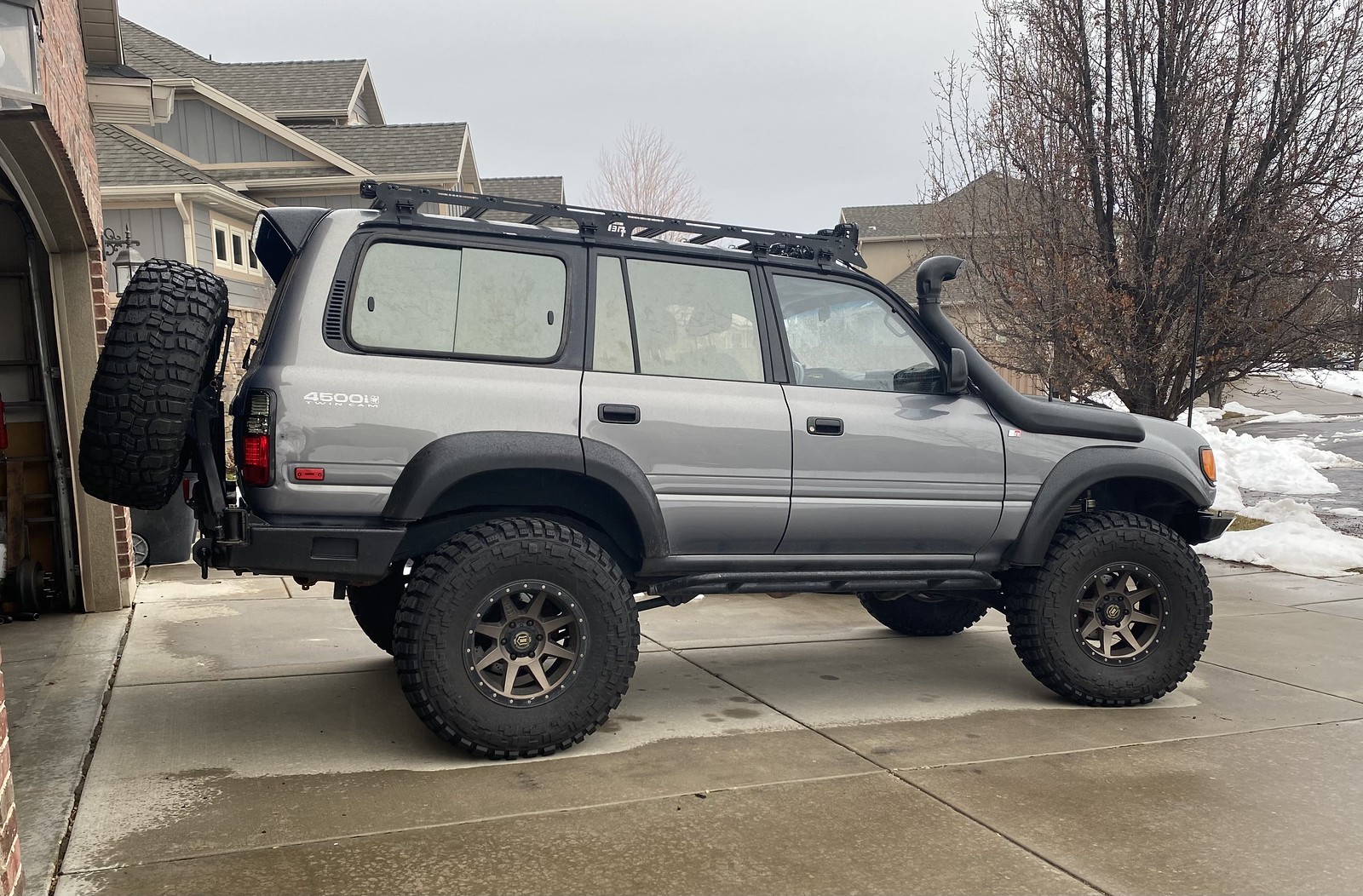

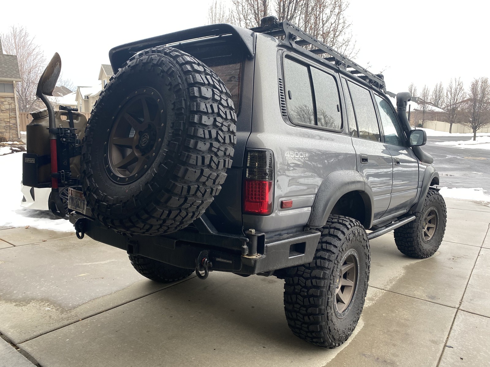

Was able to sneak into the garage for an hour on Saturday and replaced the gutter mounts on my Prinsu rack with the updated brackets. I never had an issue with the original brackets but this new design is definitely MUCH better.

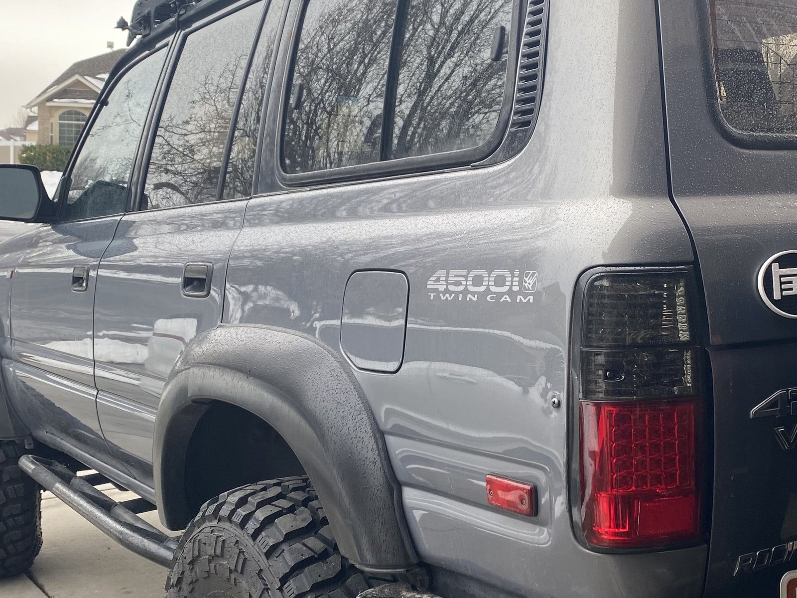

I also swapped out my taillights for some cheapo LED ones. I wrapped up my OEM taillights and put them on the shelf since they're in good shape. I won't feel bad if I smack these cheap ones on the trail.

Now back to the big headache that's inside the garage hiding behind the 80. I'm gonna need to enlist some MUD help to get that thing finished up.

So the updated brackets can retrofit onto older racks? I might need to look into this
