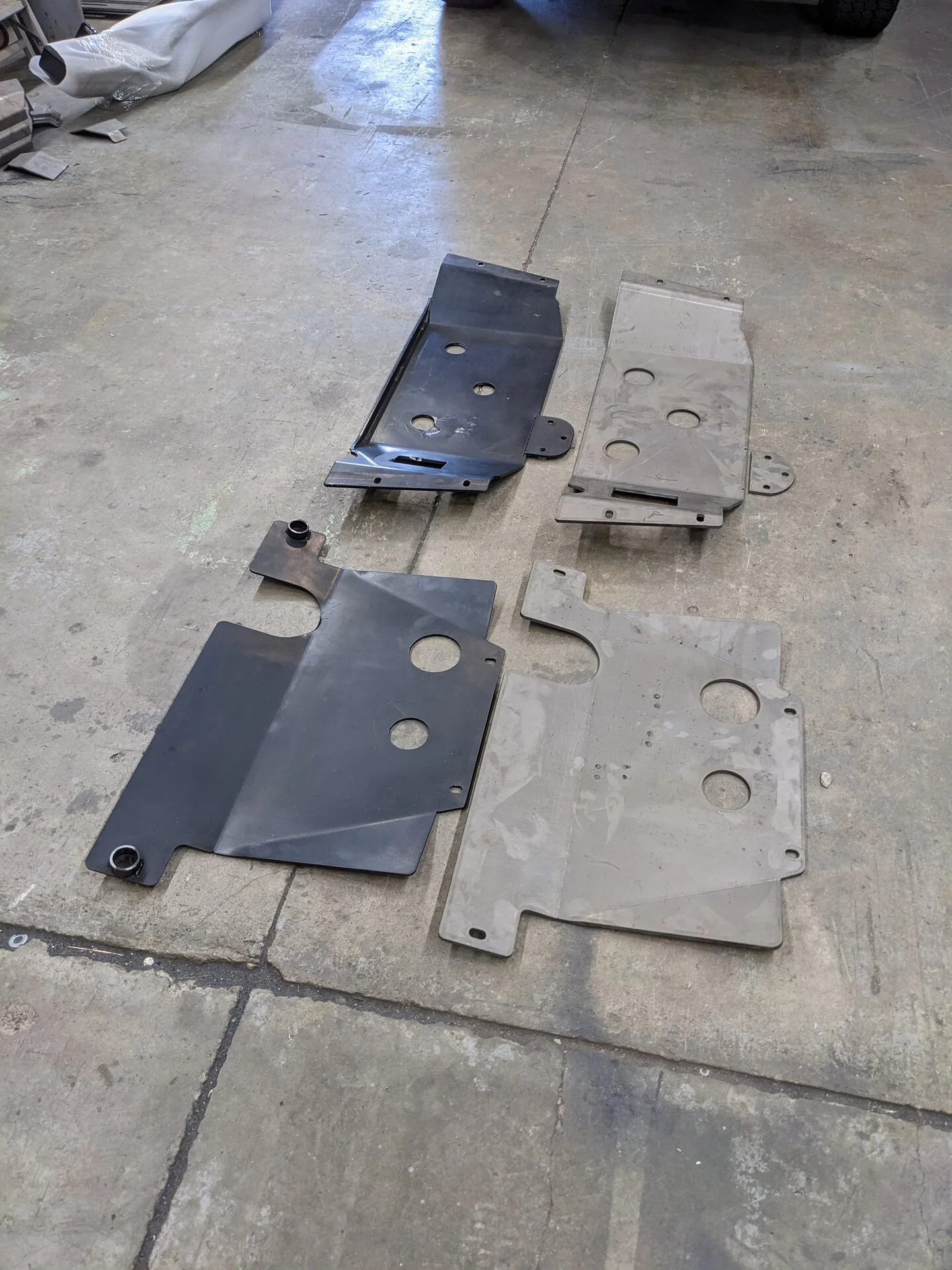

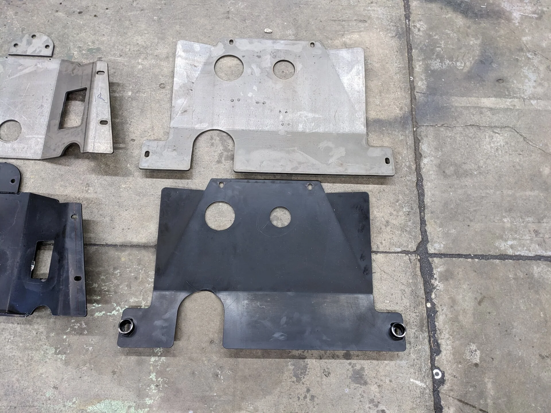

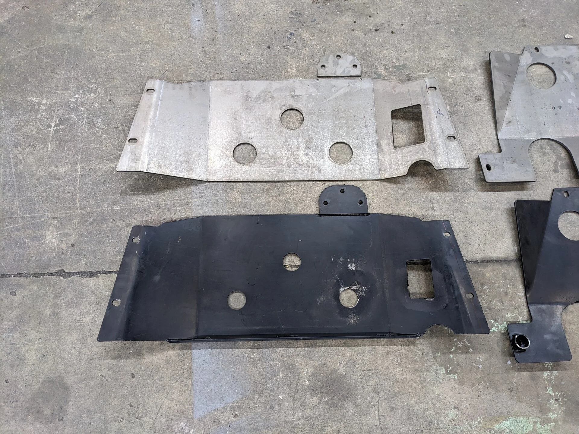

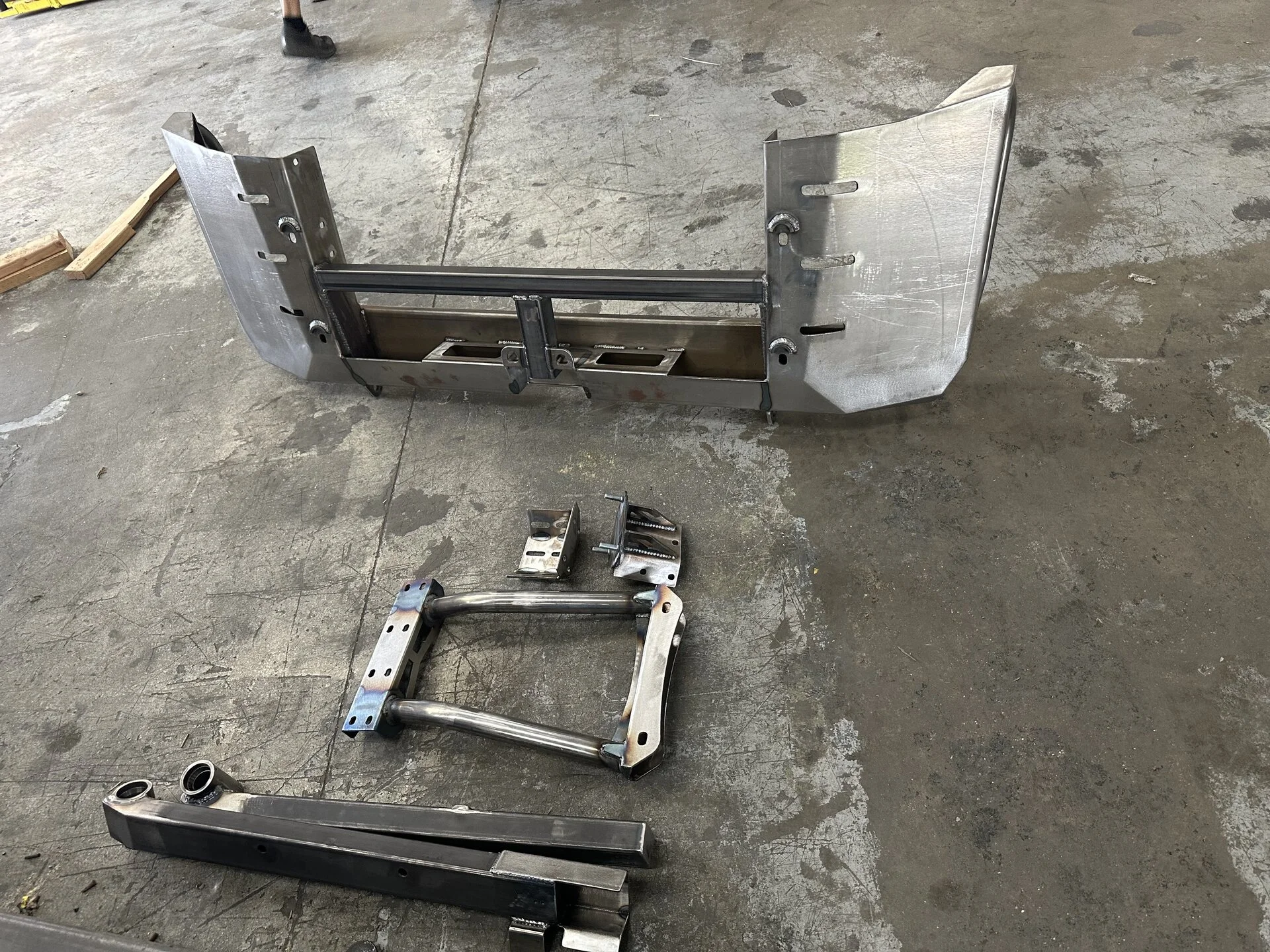

Reverse designed the Cruisin Offroad skids. The sliders are next and if Jason (Cruisin Offroad- RETIRED) and I can come to a final agreement the front and rear bumpers will follow soon. Made a few "openings" changes on the plates due to clearance issues. But all good to go now. Will be available on the website soon.
I will still keep my CREEPER skid plate in production as well. Just trying to appeal to the masses.

View attachment 3319742View attachment 3319743View attachment 3319744
The 7x parts Jason designed are the bomb. Those should be on your list. A serious gap in the North America 7x world.

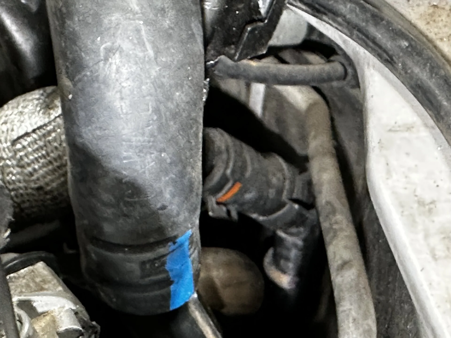

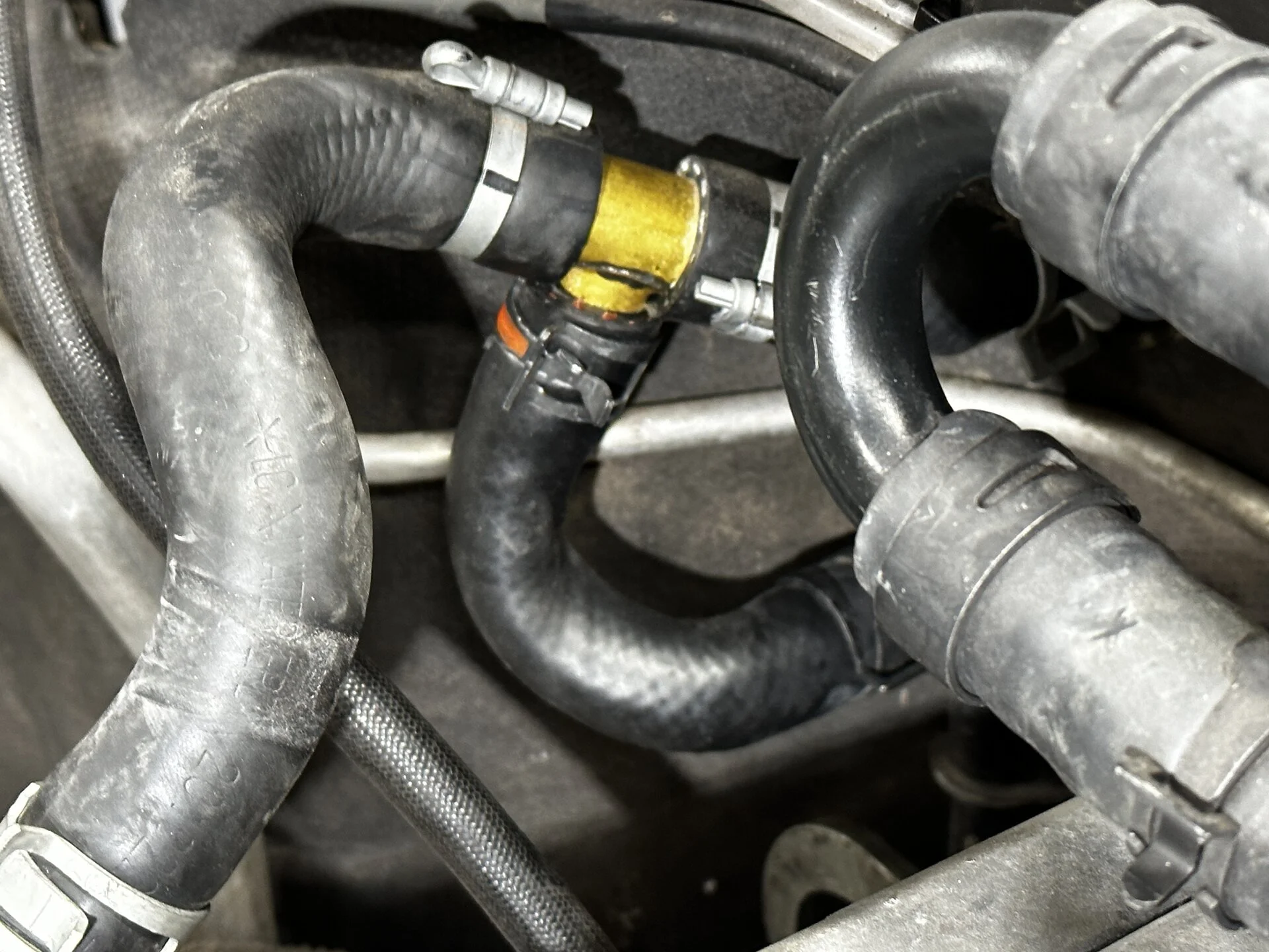

If anyone is interested:
Found a good hose for the two “non-serviced” rear heater hoses that attach at the back of the head:
From a 5VZ-FE from a T-100.
The bends are perfect and the IDs are exact for the step down from the Ts to the rear heater piping. And keeps things appropriate from Toyoda Gosei (Toyota Land Cruiser rubber hose supplier):
Installed:
