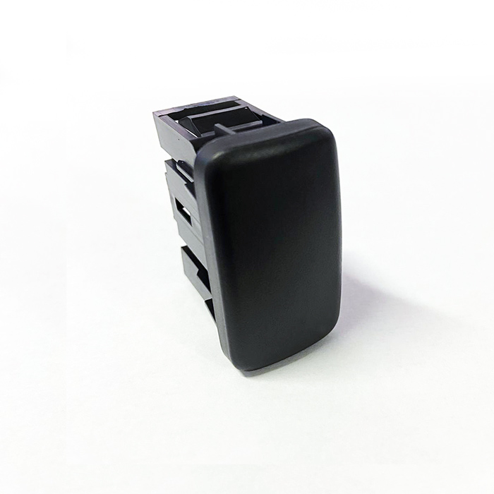

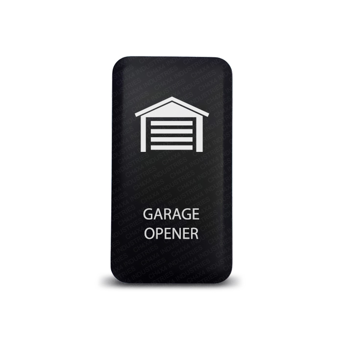

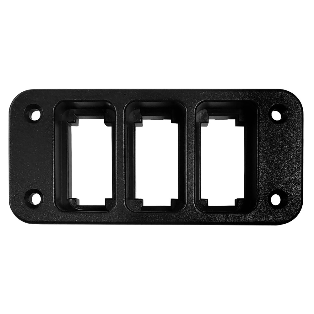

Next I bought a switch panel, garage switch, and blank. These can be found cheaper other places and a two switch panel would be less wasteful.
The blank had to be filed quite a bit to fit the panel.
I thought about getting a witsend useless cubby panel and shape it to fit so I could use factory switches but didn’t want to do that to his amazing parts for this expirement. I couldn’t find any other options so used the newer style Toyota switches.
I made sure the tmv71a controls and two switches would fit in the opening. Easy. I was going to make a bracket to screw into the console to hold the tmv71a controls but the flats of the controls matched up to flats in the overhead console, and it was already a close fit so I took the easy route and two-sided taped it in place. The controls are light and it doesn’t budge so I’m good with it. The switch panel needed quite a bit of shaping to fit but it also had enough flat areas to two sided tape it in place too. No movement from anything up there. I trimmed some plastic sheet I had laying around to dress up any gaps between the v71a and console.
