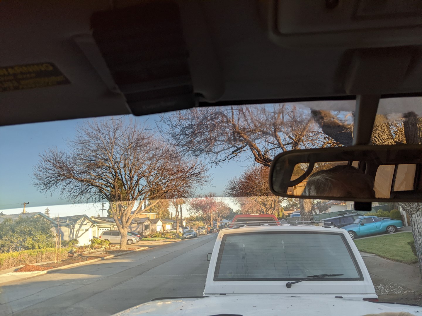

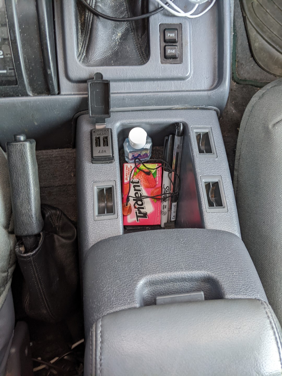

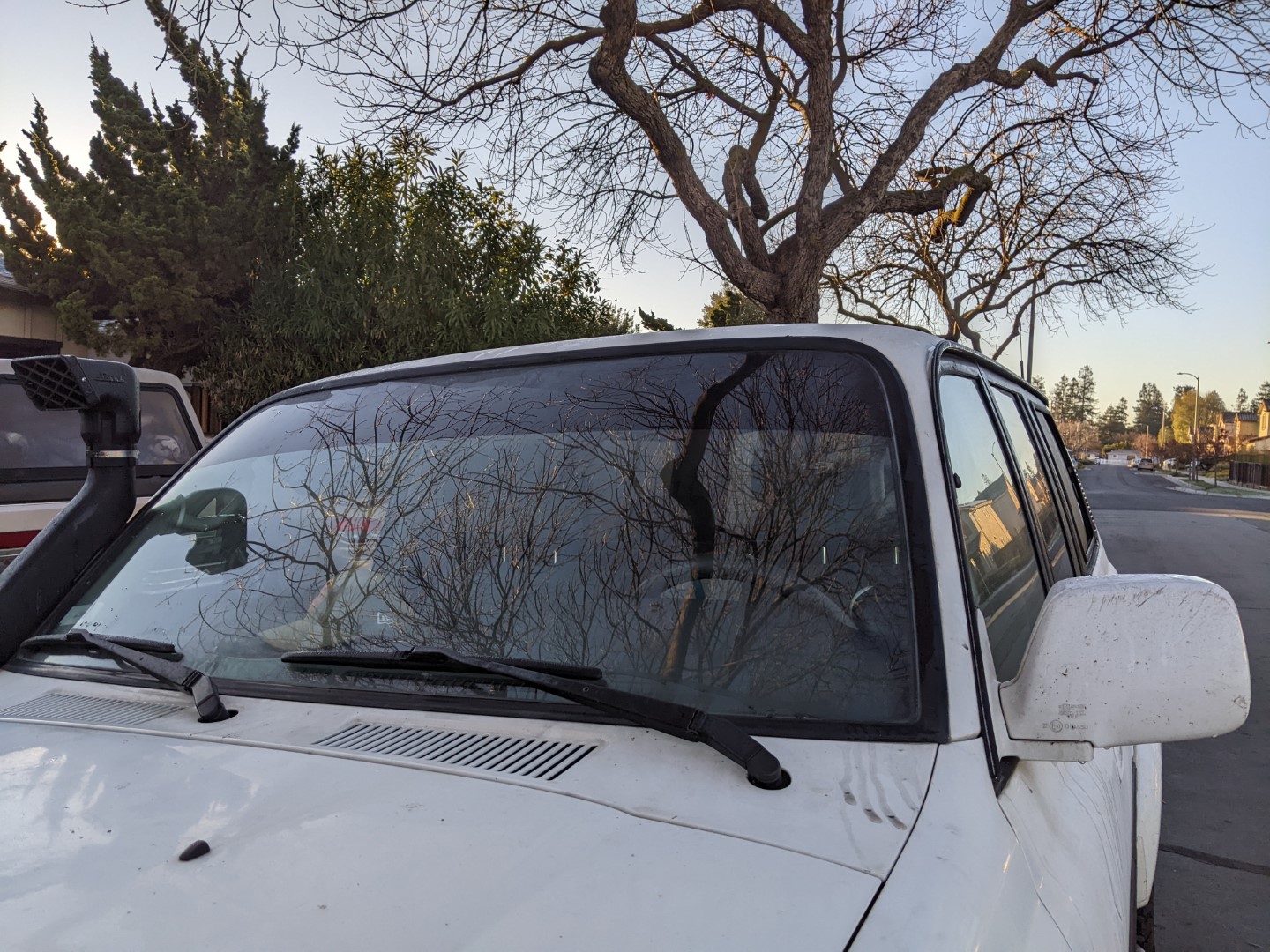

New (amazon) gas struts for the hood. Tinted the upper part of the windscreen (since I have the narrower lexus sun visors) and installed a bluesea dual USB in a switch blank on the console. Already have 2 USB and one cig lighter outlet on the bottom/back of the console (for when my men were kids...).
Drove into the sun this morning and the tint really helps take the edge of the sun's glare. Weird seeing the tint, I'm sure I'll get use to it with a bit of time.
When I installed the original outlets it appears I had the brains to install a decent connector. So, it was a joy to easily remove the console to open up the switch blank hole some and adjust the 'thickness' to let the bluesea 'click' in nicely.
The other 'wiring' stuff at the bottom of the pic is from a ham radio.

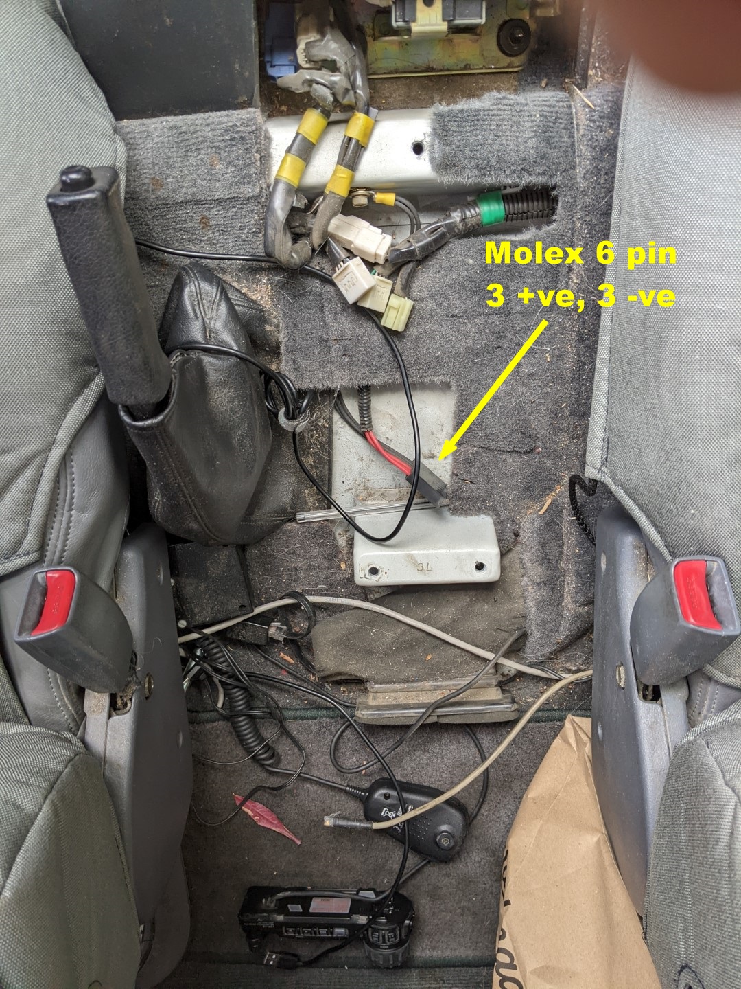

I too hope to use these tan ones (from an older Lexus?)I bought years ago in the useless coin spots in the console as you mentioned, just need to figure out the wiring.
If anyone is familiar and can offer some help with the wiring converting the 6 wires to the 4 wire SM harness, it would be greatly appreciated!
