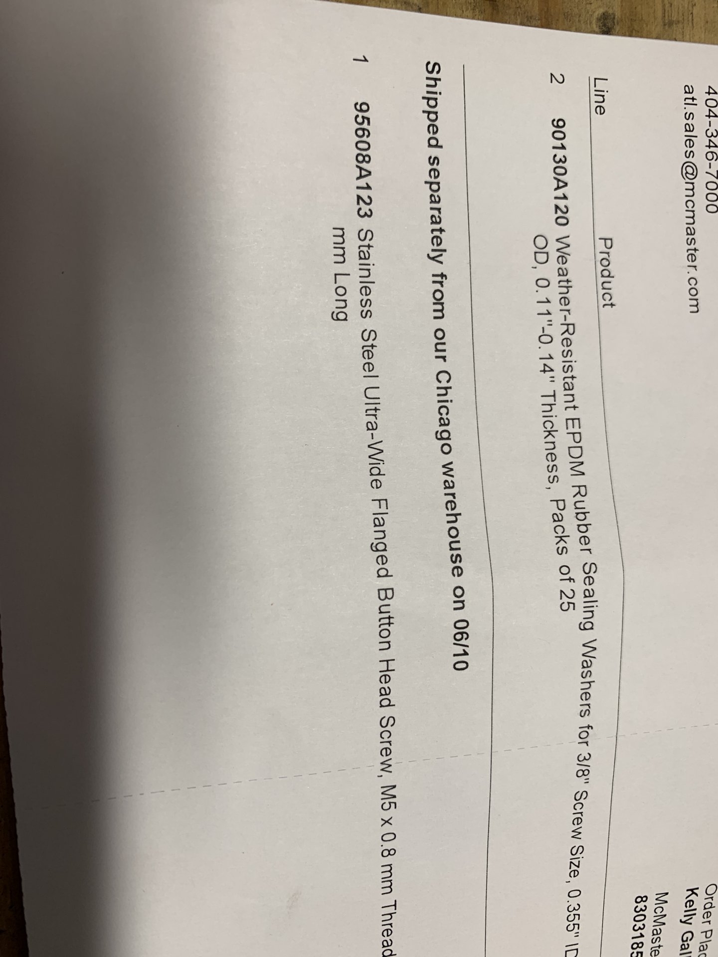

Joey has been back ordered so I did some research on bolt size and went with this from Master-Carr. Sorry for the sideways pic
Thanks for that. I’ve been stalking the kit on his website for a while now but those look like a good alternative. I’ve got a Bowfin rack waiting to be installed and I’d really like to get the factory rack off ASAP.
