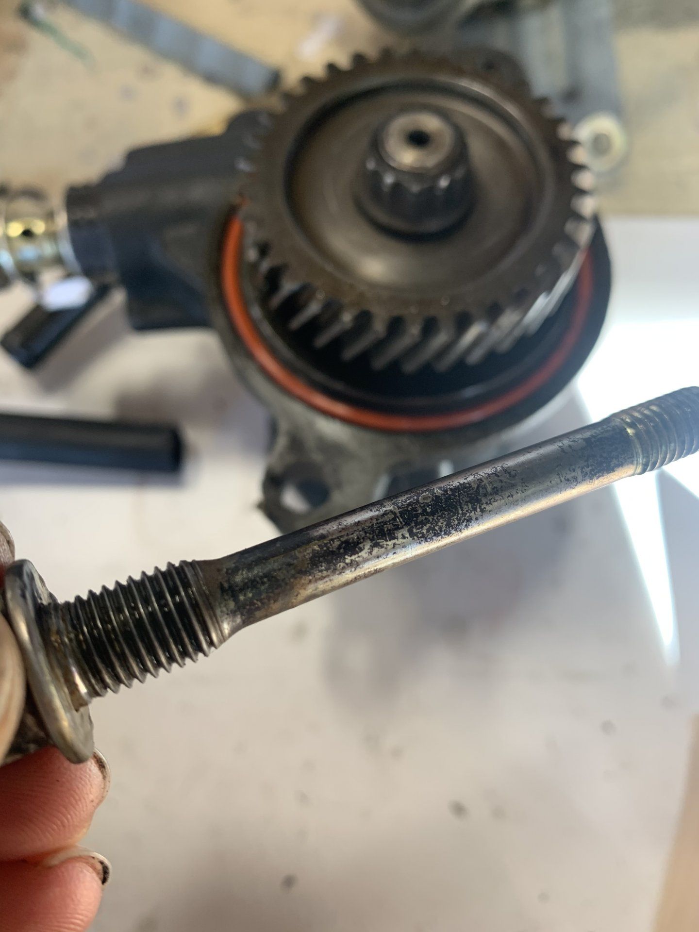

Ok. Double nut. No bueno. Only five usable threads on the broken bit. Tried to grind down a nut enough to give enough room for a second and it just ate the nut. Might have lost heat treat on nut from grinding too.
next attempt.
JB Weld. Letting that set up overnight Peace!!

VICTorY! The JB welded on nut and some heat pulled the stud....but what the heck is this thing. And where can I find a new one!!!
Thought it might be a knuckle stud and was hoping to use @NLXTACY kit.....nope.
Feeling lucky all things considered.
looked on the partsouq parts map, nada, they just show the nuts.

Congrats! Looks like the the studs are under the engine block diagram. 90901-26001

Dude!!! Thank you. I totally missed that. Was looking at that diagram and didn’t see it. The gear should have been the give away! :beer::beer:
