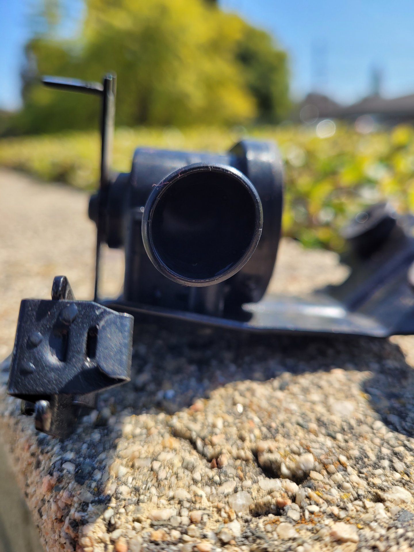

Conversion to allow emissions testing on the RWD rollers:

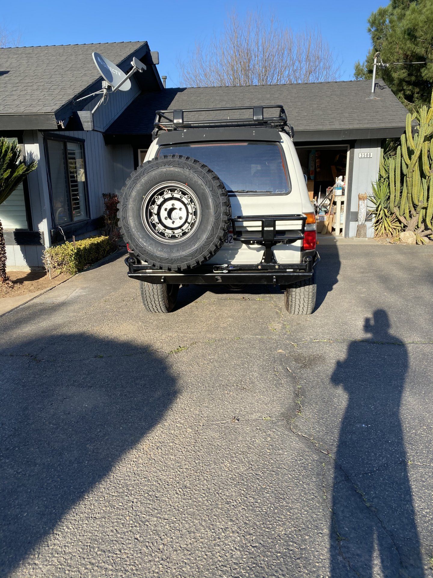

After 20 years I finally got the speedo in check to factory specs. 4:88 gearing made the 37's spot on:

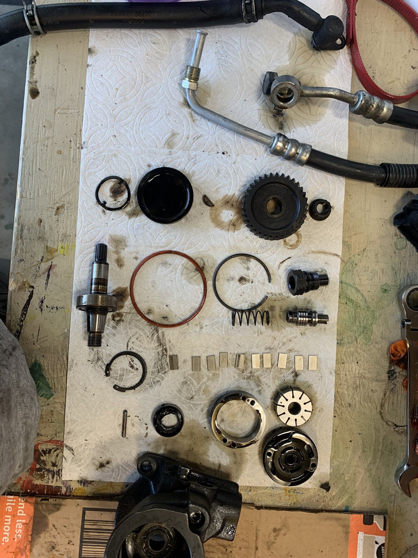

While I’ve been pretending that PS stud isn’t broken....I’ve been busy as a beaver.
