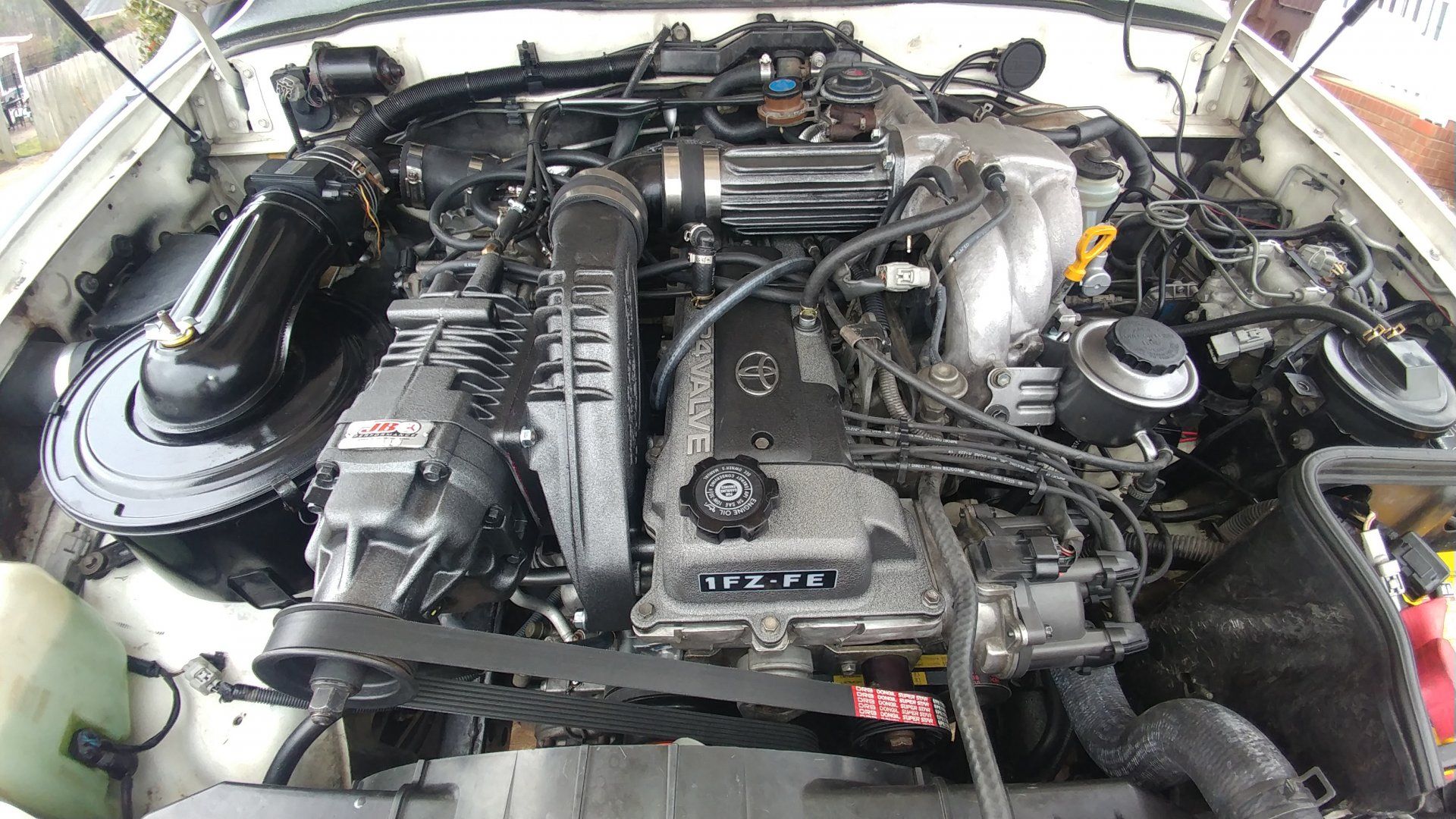

It’s been over a month since the engine rebuild started. Finally got it in this weekend. A half day of work left on this still and should be able to fire it up!
Before:
Now:
What paint did you use on the SC? Or is it powder?
Looks awesome!
I'm hunting for a trd 1fz SC, someone somewhere has one, just gotta find em
