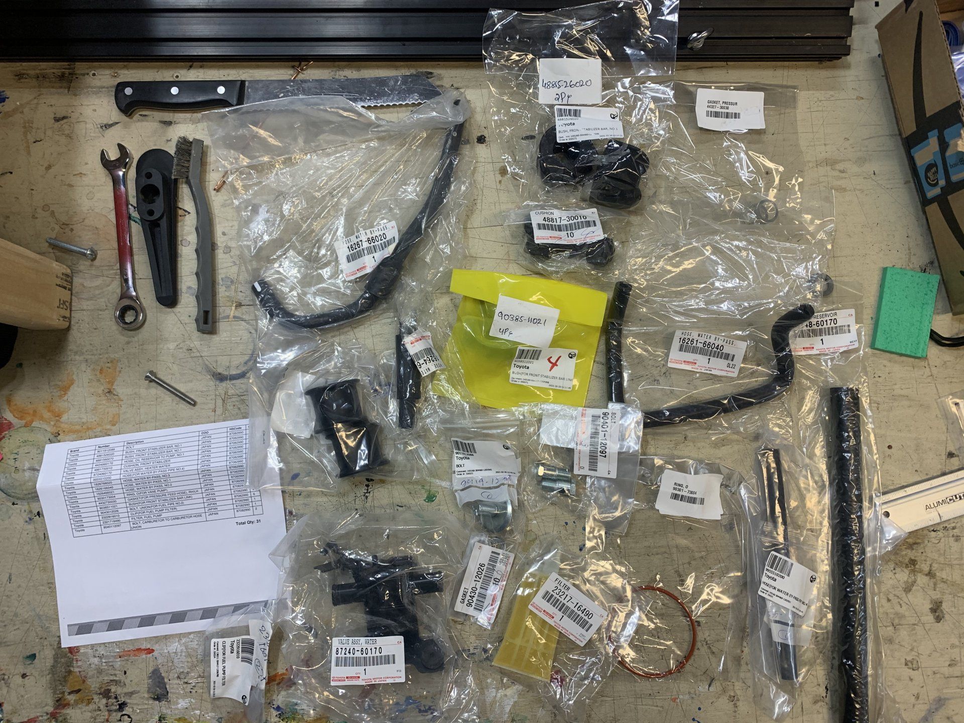

Put all the Mud tips and tricks into action and pulled the head with some buddies. Thanks everyone past and present!
Everything came apart pretty easily but I ran into a bit of snag. The timing chain guide slipper has started to deteriorate or may have broken when the head came off. I recovered the pieces but I reckon this is a must fix item and the timing cover will have to come off. I found a few references to pulling the timing chain cover with the oil pans in place but not a whole lot of good examples. I will probably give it a try since I am not all that excited about removing the pans with the motor in the truck.
I'll keep researching while I wait on timing cover related parts, clean, and knock out some while your in there activities.

Bagged and tagged
Naughty guide
