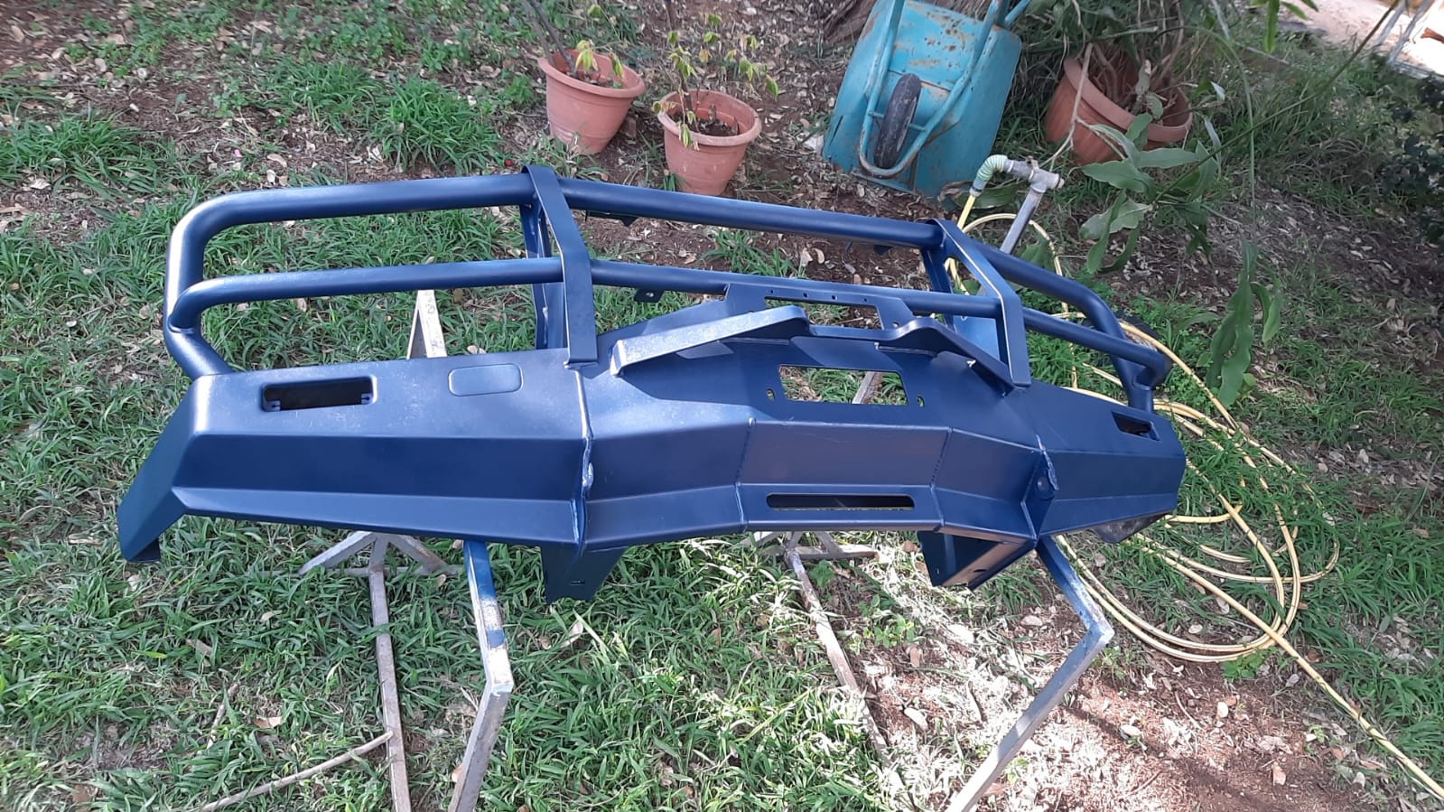

1. Disassemble the front lights, grille and bumper.
2. Blacked out all the chrome.
3. Took the winch apart, changed the grease in the gear.
4. Sprayed the entire bumper with matching body color.
5. Installed an aluminum fairlead instead of the rollers.
6. Installed a new synthetic line.
