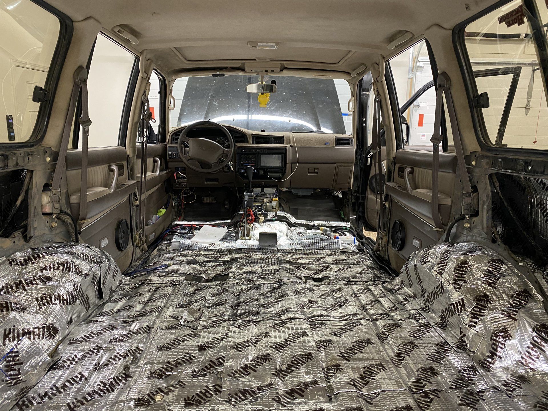

Also as I was awaiting the supercharger to get rebuilt and its been sitting in the garage for the past month I installed 1.5 wheel spacers and insulated the entire interior. Makes it feel way more Mercedes like closing the doors and road noise is definitely cut down but now I can just hear my bad window seals even more. Definitely would recommend doing the Killomat I’m glad i did it definitely worth while. Also pulled the flares and put new weather stripping on as well

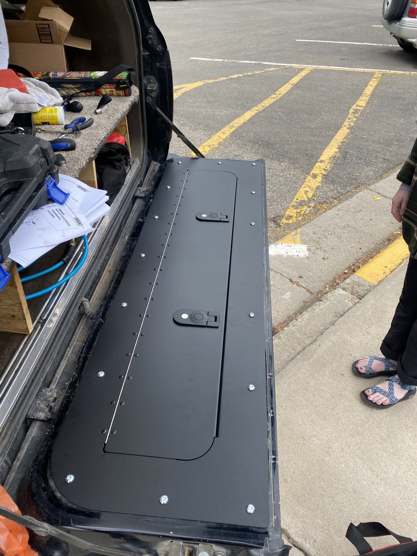

And I also forgot when the group buy was going on I got the rear tailgate storage. So far I really like it I think I will love it more when I take it camping a and figure out what actually should go in there but right now I just have some basic tools and a recovery strap. I am done dumping money into this for at least a month or two now I think :bang:.

That’s a ton of work (and coin). I’m supremely jealous especially of the sound deadening mat and flare gaskets. Start to finish, how long do you think it took to remove your seats, clean everything, install deadening and put it all back together?

Appreciate it thank you! It was a ton of work but in my mind cheaper then a car payment haha. And I was able to pull all of this off for under $800 start to finish out of my pocket for everything I got really lucky with how I got this all setup. For the insulation it took me a probably 8 hours start to finish on it. It wasn’t to bad and a impact makes it super easy pulling all the big stuff out. I also had some extra red clips laying around from pulling the tailgate carpet off which was good because I ended up breaking a few more then I would have liked to. Really recommend it it ended up being around $120 for the insulation I got 64 feet of the 80mm stuff and that did the doors and the floors. Thanks!
