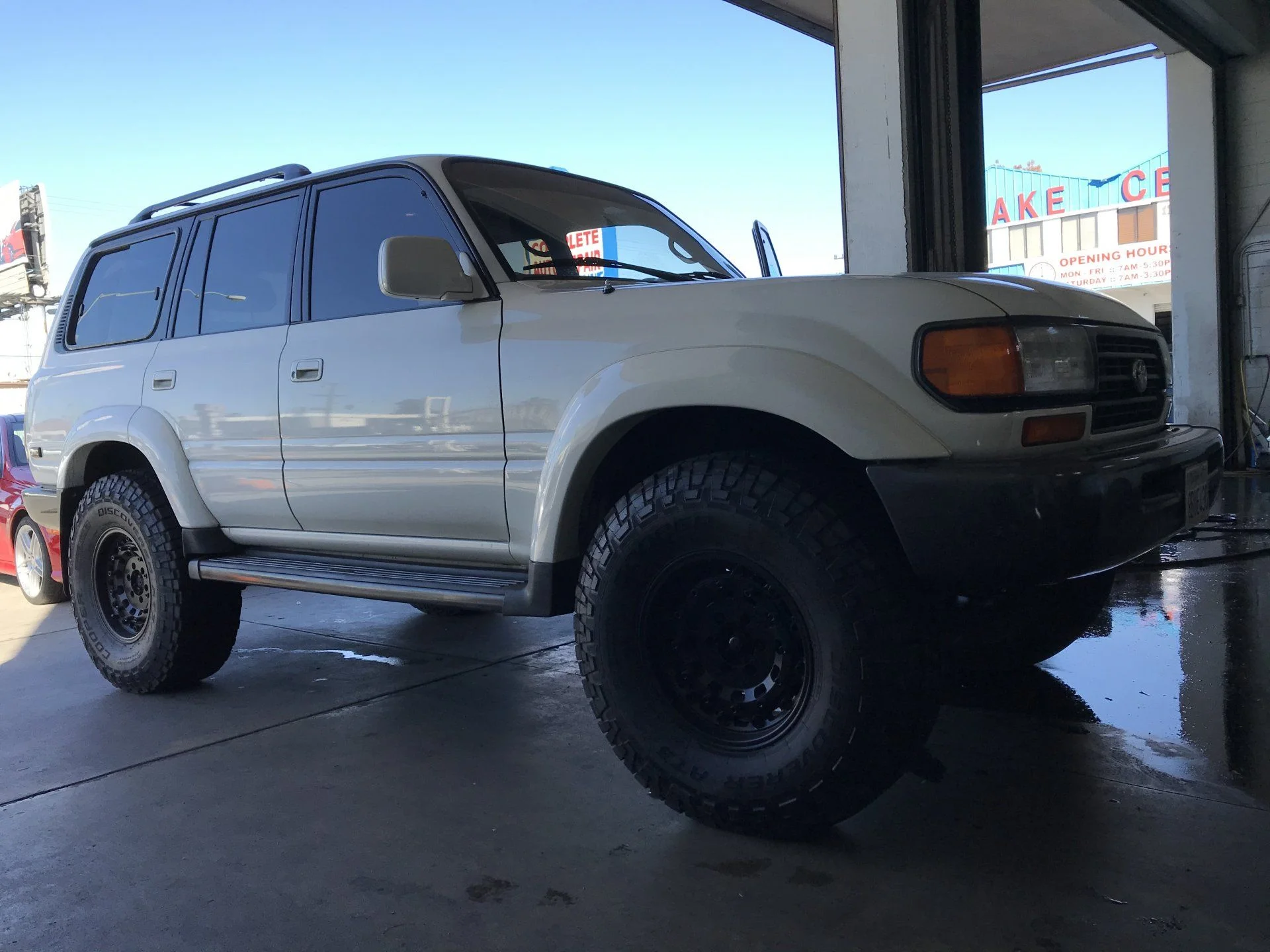

Yes they are 7.5”. I am not worried about it 1 since I don’t air way down and I don’t worry about popping the bead off, 2 even Firestone says 7.5” is the narrowest wheel and 3 I may go with a weld on bead lock and won’t ever have to worry about it.
I would run a 7.5” with 315’s.

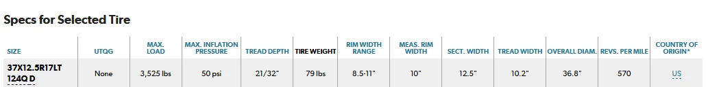

The FJ Cruiser wheel is narrower than stock and has more backspace than stock. The net result is you have narrowed your track by by almost 1 3/4 inches. The references I find list a minimum rim width for this tire to be 8.5 inches. You will be fitting a tire with a 10.2 inch tread width on a wheel with a flange-to-flange width of 8.5 inches. You will have quite a crown in that tread unless you really drop the air pressure. Your call.
The FJ Cruiser wheel is narrower than stock and has more backspace than stock. The net result is you have narrowed your track by by almost 1 3/4 inches. The references I find list a minimum rim width for this tire to be 8.5 inches. You will be fitting a tire with a 10.2 inch tread width on a wheel with a flange-to-flange width of 8.5 inches. You will have quite a crown in that tread unless you really drop the air pressure. Your call. View attachment 2493727
I’ll most likely go with a wheel spacer to make up for the change in back spacing. I know several people with the same wheel/tire size and they don’t have any issues. I know it’s be a little better if I could go with an 8.5” wheel.... I guess I’ll see what happens and if need be I’ll change the wheels out with something else.

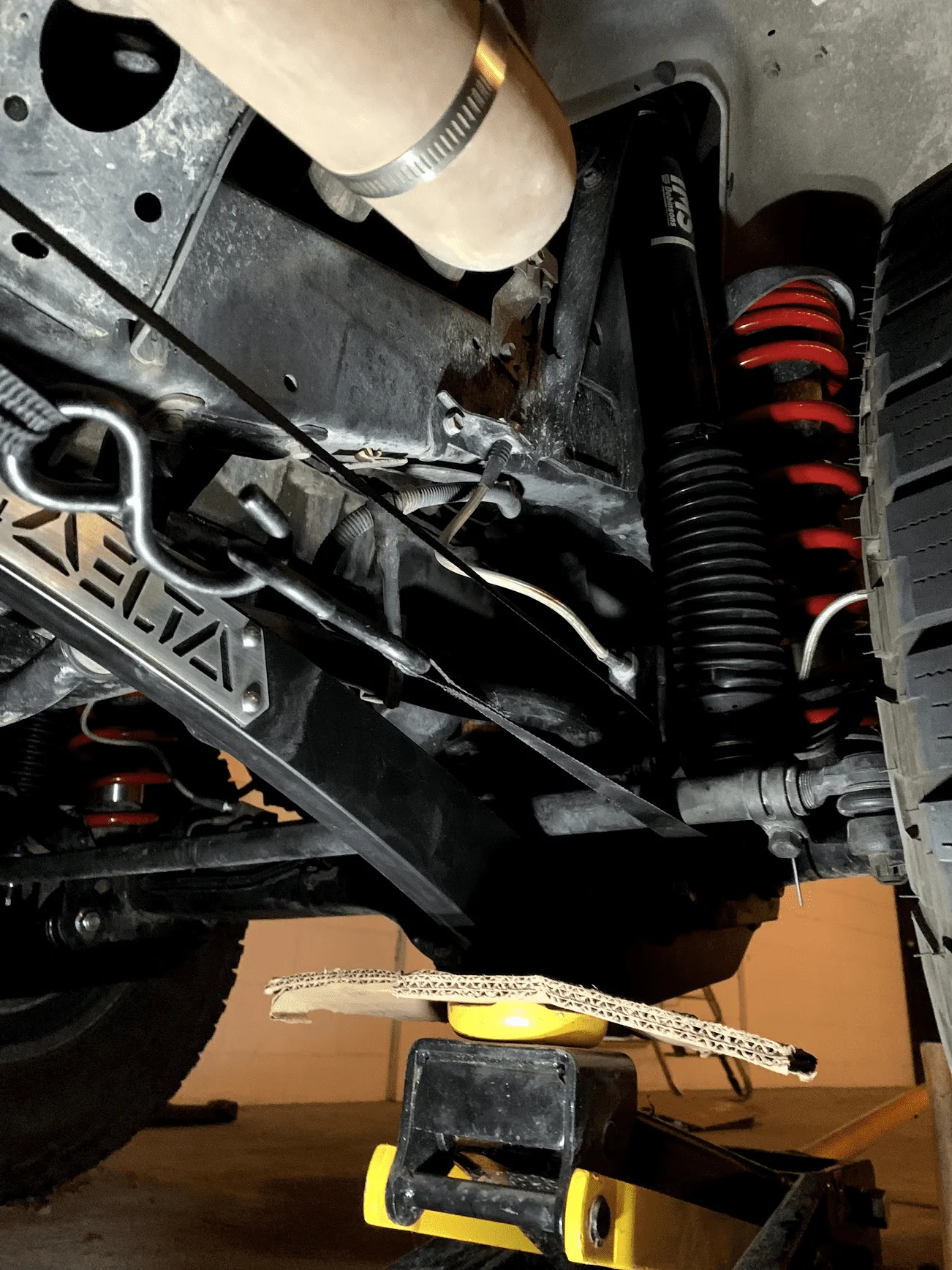

Just got out for a first test drive after a pretty lengthy set of front end upgrades:
  • Delta 4" arms
  • Dobinson's IMS/IFP shocks
  • Tour Flex 3" tapered coils
  • eimkeith panhard bar correction kit welded in + adjustable Ironman4x4 panhard bar
Wow, just wow. That plus my recovered driver's seat (did the LSeat thing) made it feel like a whole new rig. Excited for our camping road trip for Thanksgiving...have to finish the passenger seat first though. The :princess: will kill me if only one of the seats has seat heat haha.
Add the @Delta VS rear panhard bracket to square away the rear, and handling will be even more balanced out.

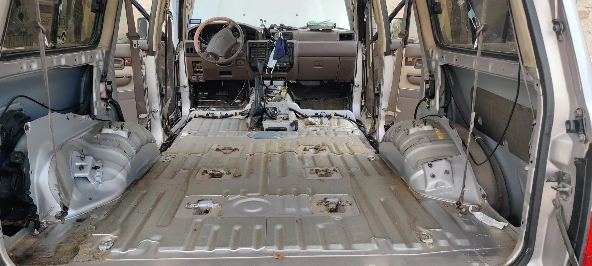

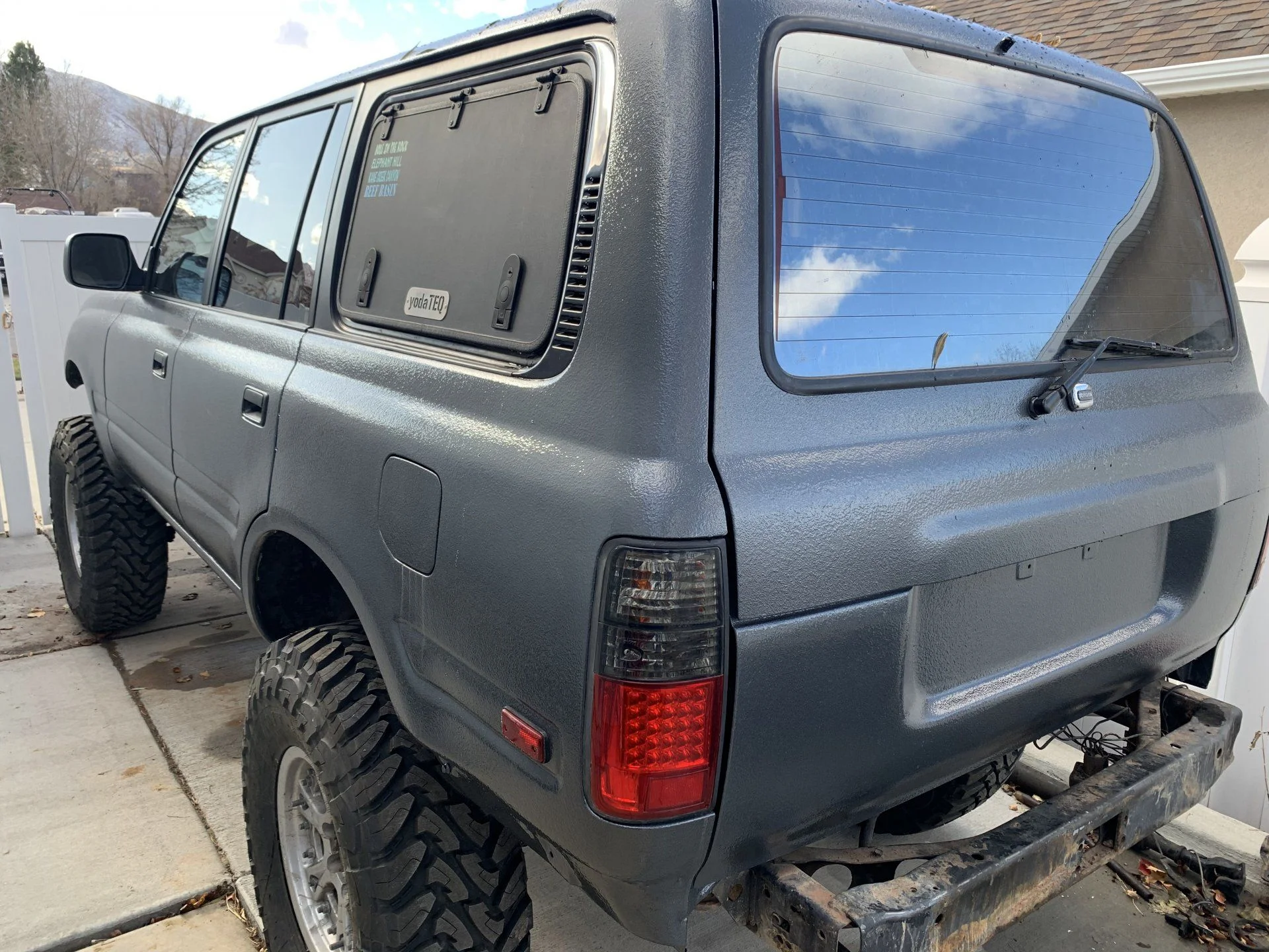

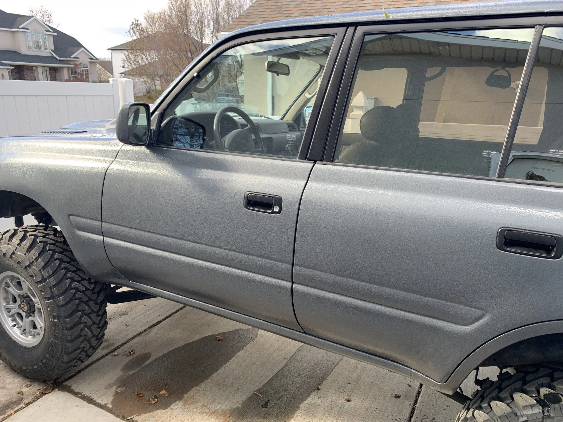

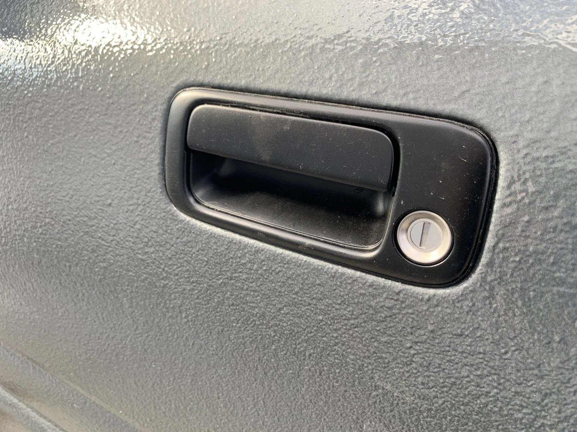

This morning I got my 80 back home, the guys at Tenacity Overland knocked it out of the park! This color is exactly what I was going for and the texture of the Kevlar liner is perfect.
While everything was all apart I decided to replace all the glass with new OEM and replace the locks (ignition, front doors, rear hatch and glovebox) with a new matched set from @Delta VS. I have new emblems to go on, but will wait until it’s warmer before trying to put them on.
Now I need to get cracking on the 6BT motor rebuild !
